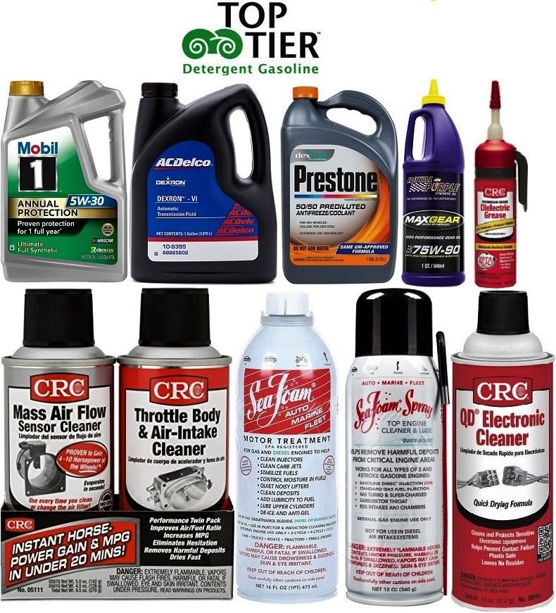

X2^ Clean the connector/contacts first! Then SEAL/PROTECT! Dielectric grease is a unique, non-curing compound used for sealing, protecting & electrical insulating. Improves electrical performance by reducing arcing & voltage drop. Also ideal for lubricating plastic & rubber. Improves electrical performance in adverse weather conditions.
Btw, Everybody on this forum should have a Hummer Survival Kit! 14+years later and still starts/runs/drives like new.
My kit includes ALL of the following:
