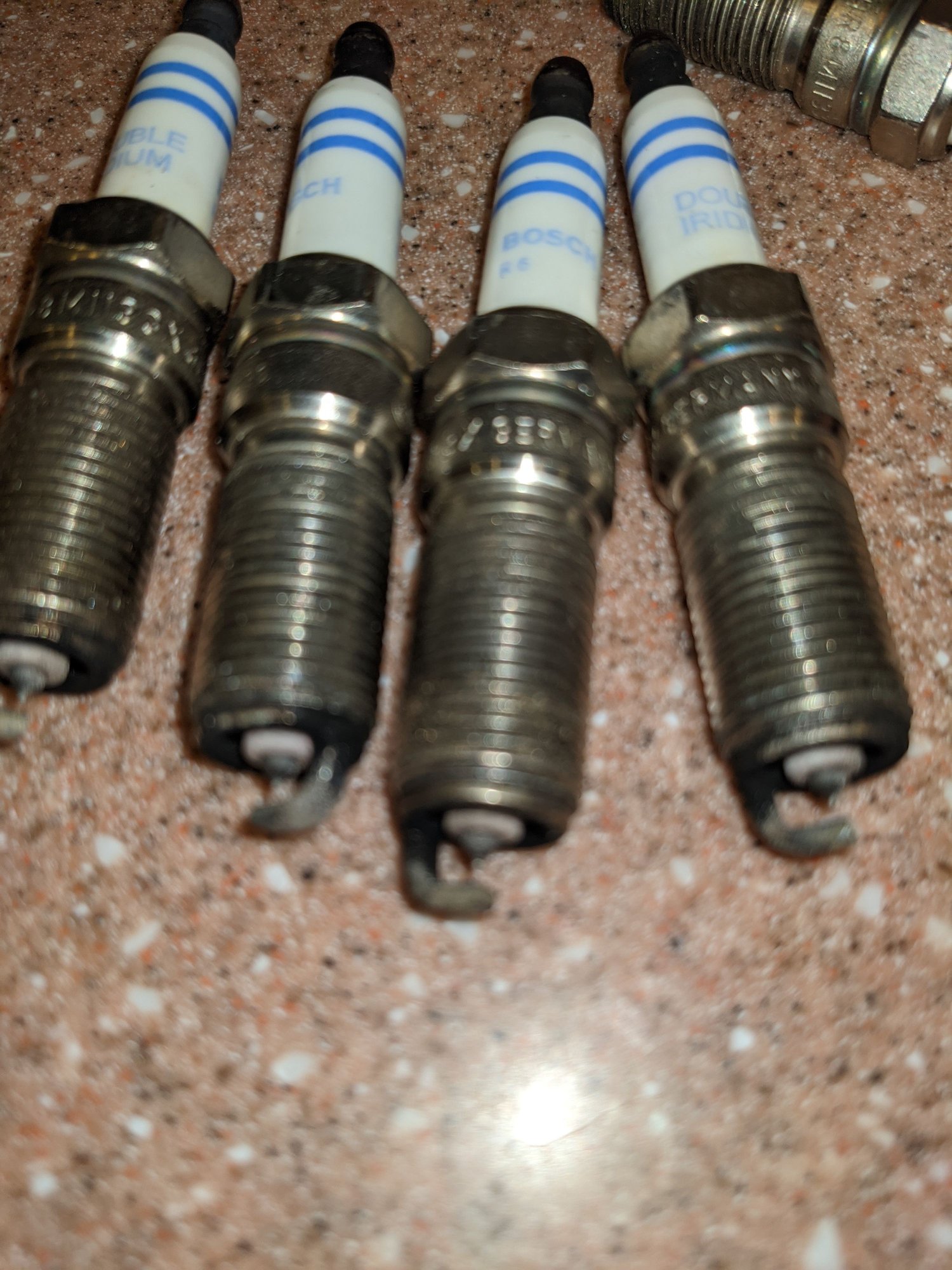

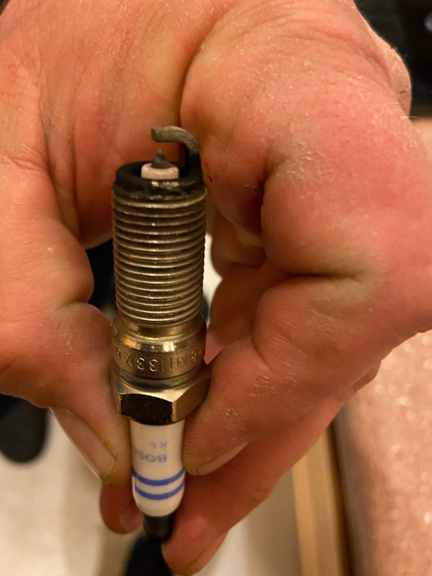

Curious of the old spark plugs condition. Post a picture.
They all look pretty much like this
