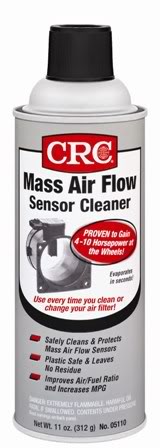

Can someone tell me how to go about cleaning the MAF sensor, I have heard the CNC MAF spray is good stuff. My concern however is, is there only one sensor? Also, do I need to disassemble the entire intake system or can I just take the filter off and spray some CNC cleaner in the hole that attaches to the air filter? I have an AirAid intake I had bought used on Ebay and had to clean/re-oil myself and I just want to make sure everything is clean in case I over-oiled it.

Buy a can Name:  CRCMAF.jpg
Size:  17.4 KBand follow the instructions. There is two screws that hold the MAF in place, you could take it out, spray it, put it back WITHOUT TOUCHING the sensor, and be done is under 2 minutes. Only one MAF, located in the outlet of the air filter box.
