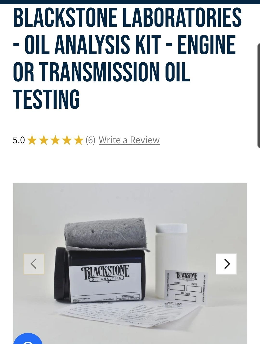

If you are really concerned, send in a sample and get it tested.

thats strange. And where do you send a sample? And what they test it for ?

Blackstone laboratories is one. $35. They'll test for water, metals, dirt, acids, additives, etc.
