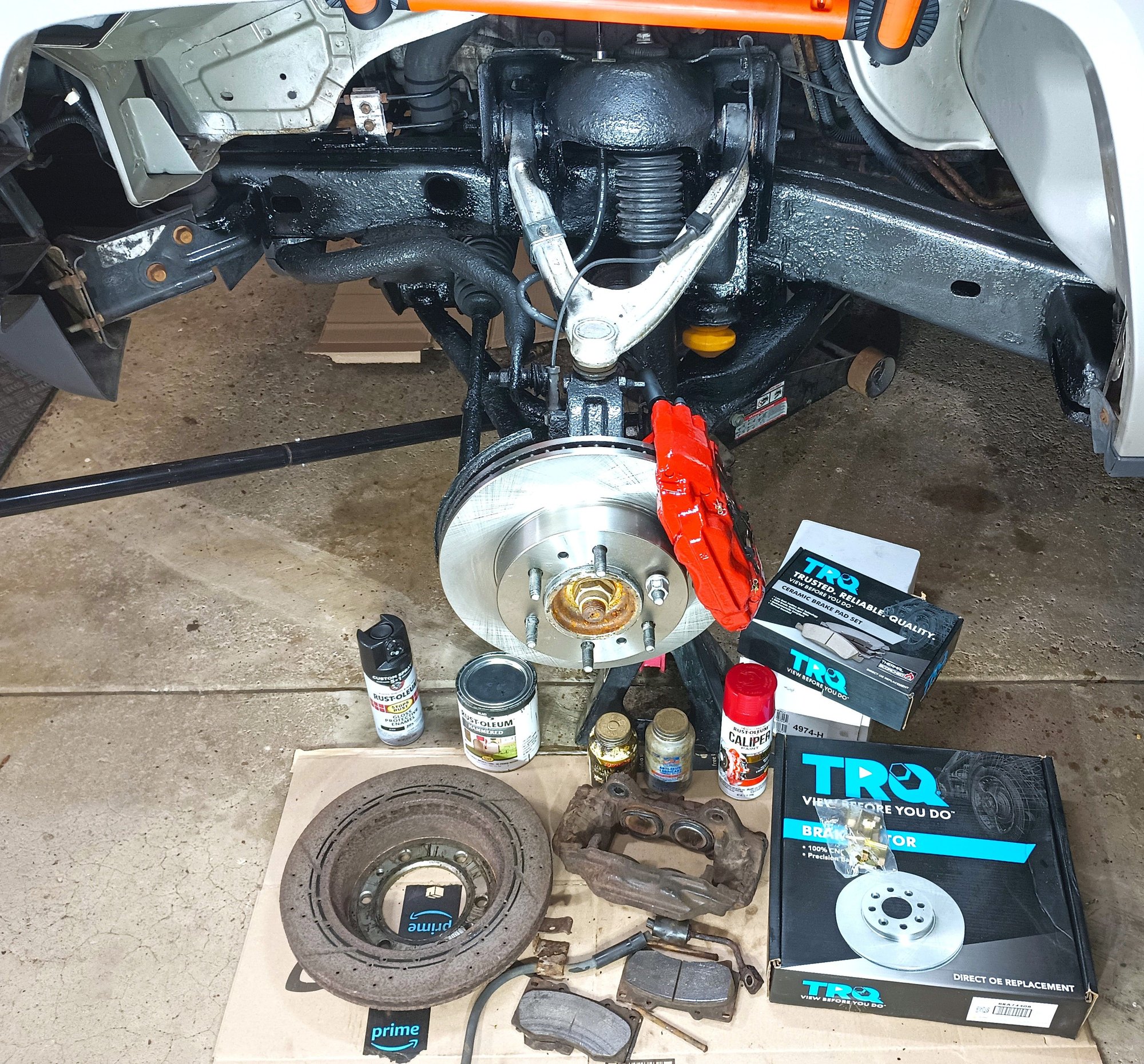

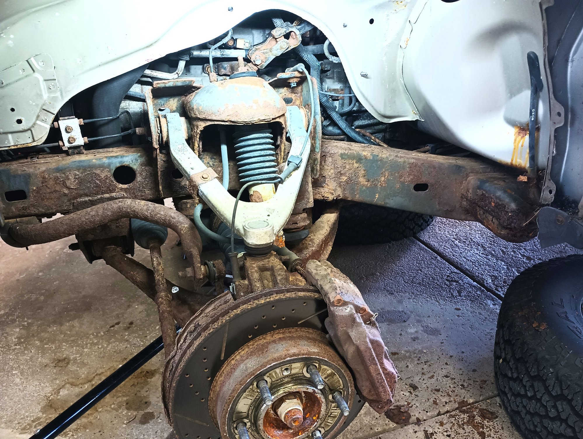

My '07 is in the garage for restoration getting my TLC whenever my time is available on any given day started here> Headlight
My brake pads-rotors-hoses are junk scrap rotted ....

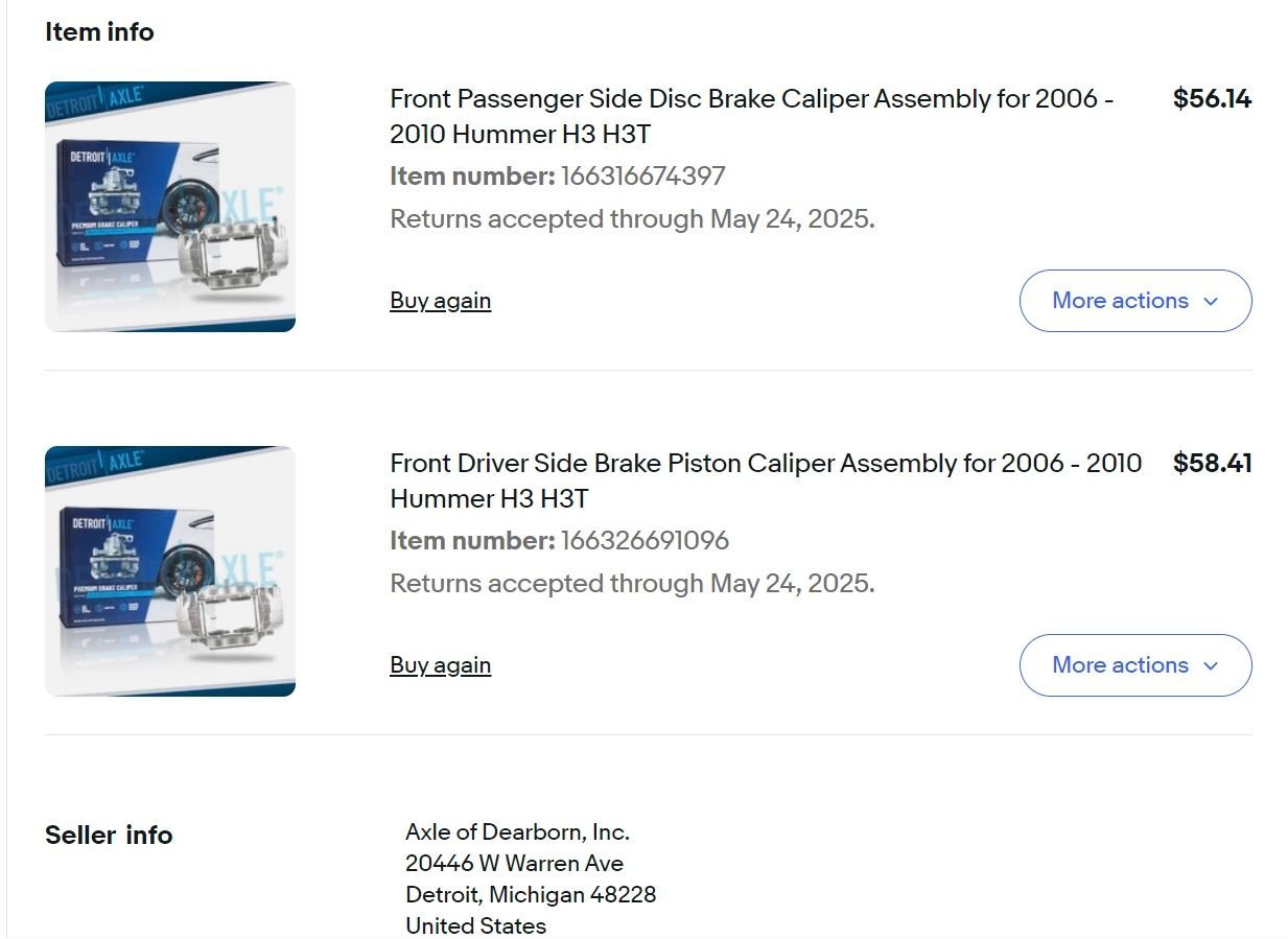

I thought I could save the calipers however I was only able to get 3 of 4 pistons to retract/extend on the drivers side caliper which immediately sent me looking for a rebuild kit along with a NEW set. All here ready to install:

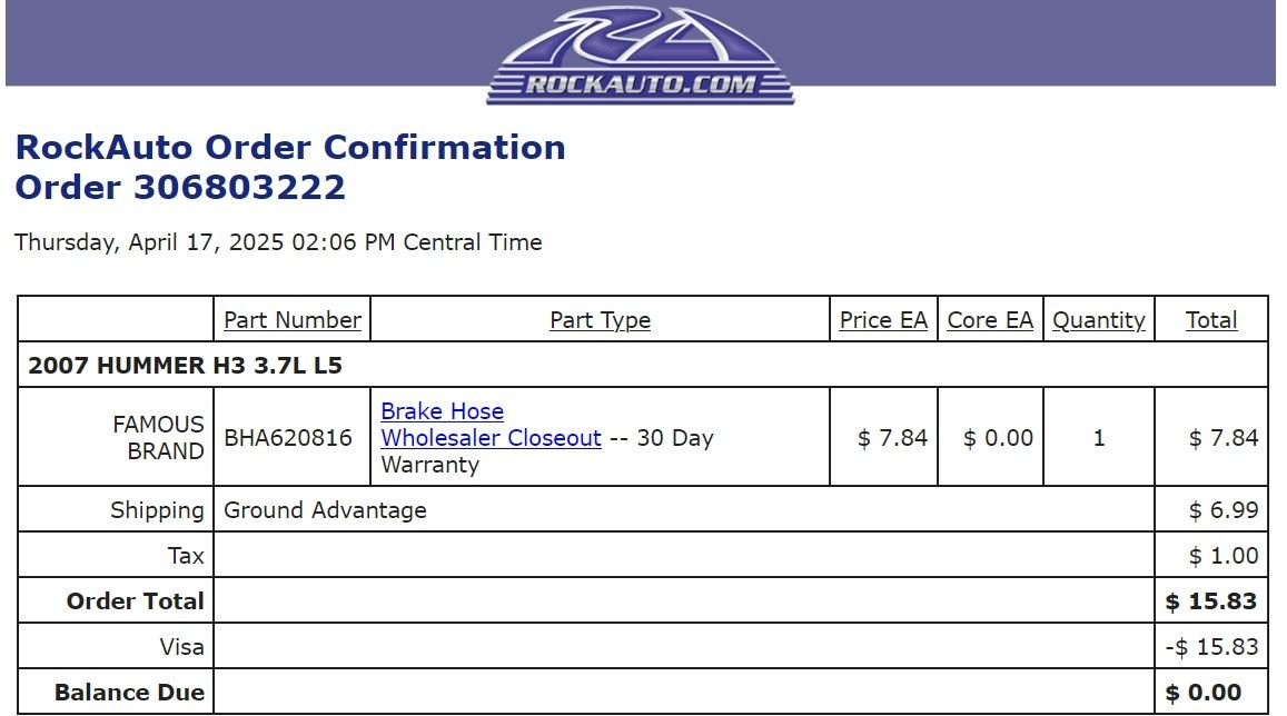

Took my time searching around the WWW. Replacement parts are getting cheaper as time goes by.

Nice work Hummerz...
Brake job B4 and after, amazing!!
Well done.

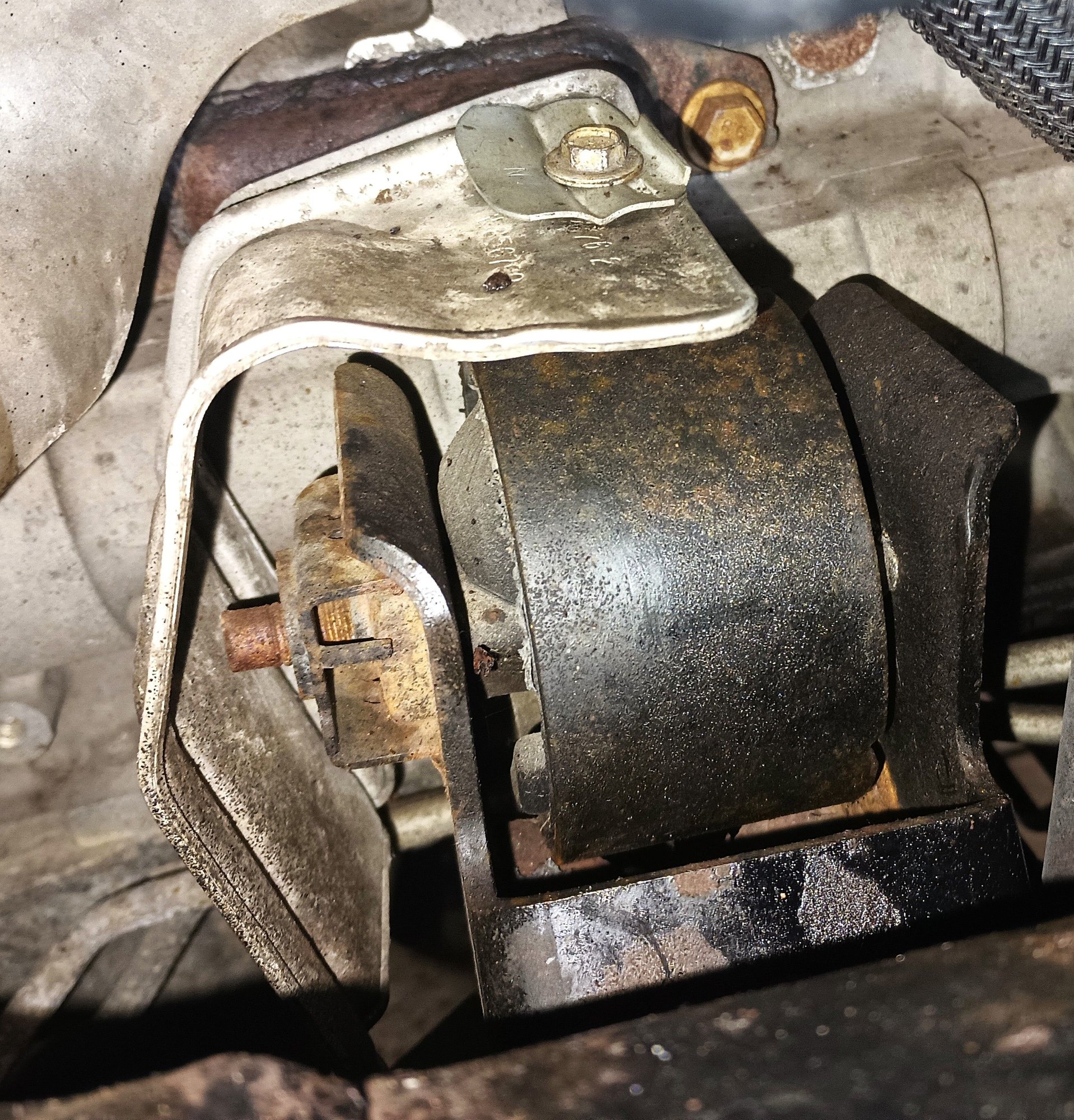

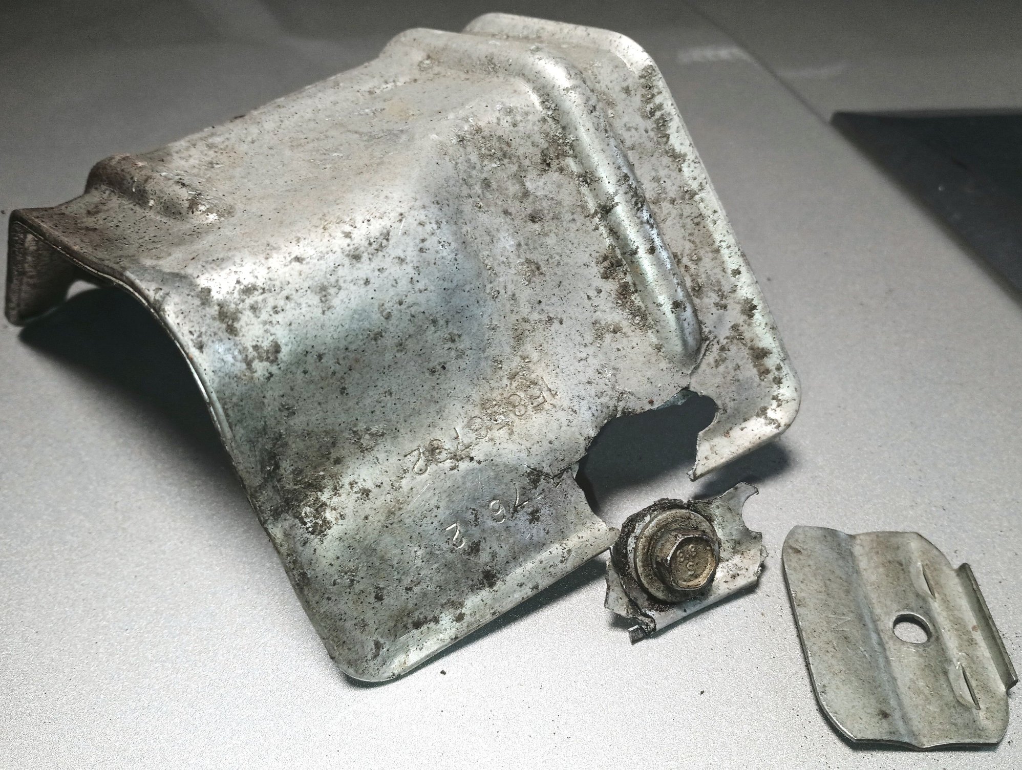

While installing the new brake hose on the passenger side I bumped the engine mount heat shield and heard a rattle. Pulled the 10mm head bolt and installed a bracket I found in my hardware tool chest. Shield is now secured tight no rattle.
I also found the intermittent transmission fluid leak coming from a band clamp that I cut and replaced with 2 14-16mm heavy duty hose clamps.

You might could sell those shield clamps, as the shield is probably no longer made
Why did you leave the cut hose crimp flare on the pipe?
Old Apr 26, 2025 | 06:51 PM
Posts: 9,046
#1-That bracket is from an old aluminum screen door I took apart as I always save hardware to repurpose and currently have a 5 drawer tool chest + a couple toolboxes filled with hardware: nuts- bolts- screws- washers- brackets- etc+++++++a lot more... that I've collected over many decades.
#2- I left the cut crimp clamp on the tube for photo purpose only.
I've cut many tubing crimp clamps over the years and I simply made this cut with a cut off wheel attached to my 19.2v craftsman drill driver just deep enough to split the remaining with my slotted screwdriver. After removing the crimp clamp I noticed the hose was split on the top & cut 1/2" from the hose then proceeded to secure the hose with 2 heavy duty clamps.
