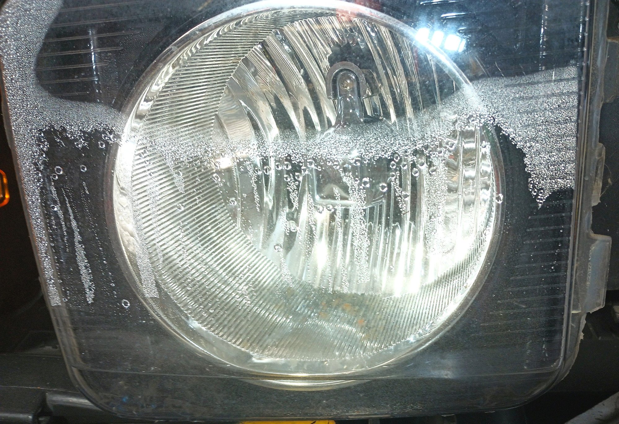

My '07 Drivers side headlight housing is taking in a lot of water.
I spent some time a few years ago, removed the headlight assemblies, thoroughly cleaned- resealed-cured -reinstalled.
Passenger side headlight housing still dry inside, drivers side is like a fish bowl.

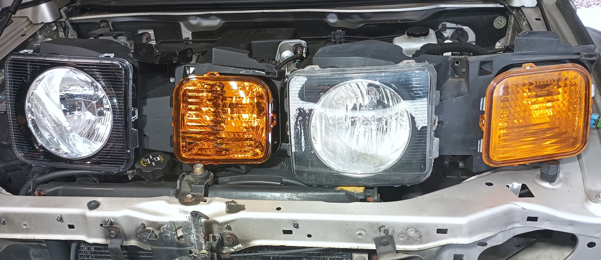

I got a new set cheap from Amazon with halogen bulbs included I removed.

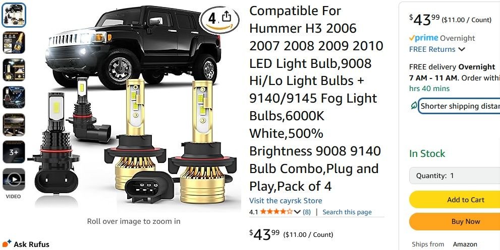

I also received 3 sets of led bulbs FREE from Vine.

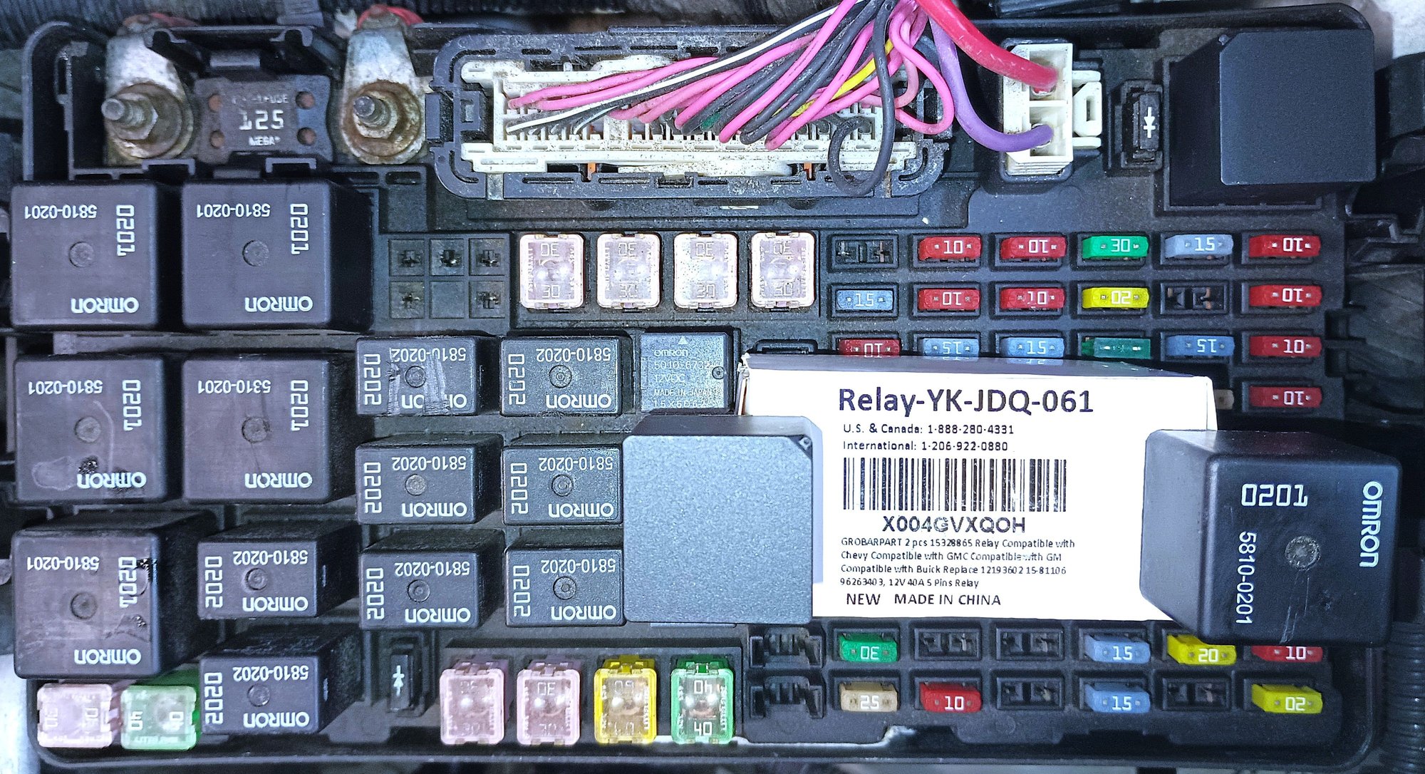

I also found the source for my inoperative parking lights>>>>RELAY 89<<<< 2-pack on the way FREE from vine.

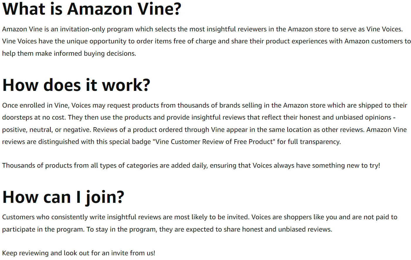

How do you get Free things from VINE?

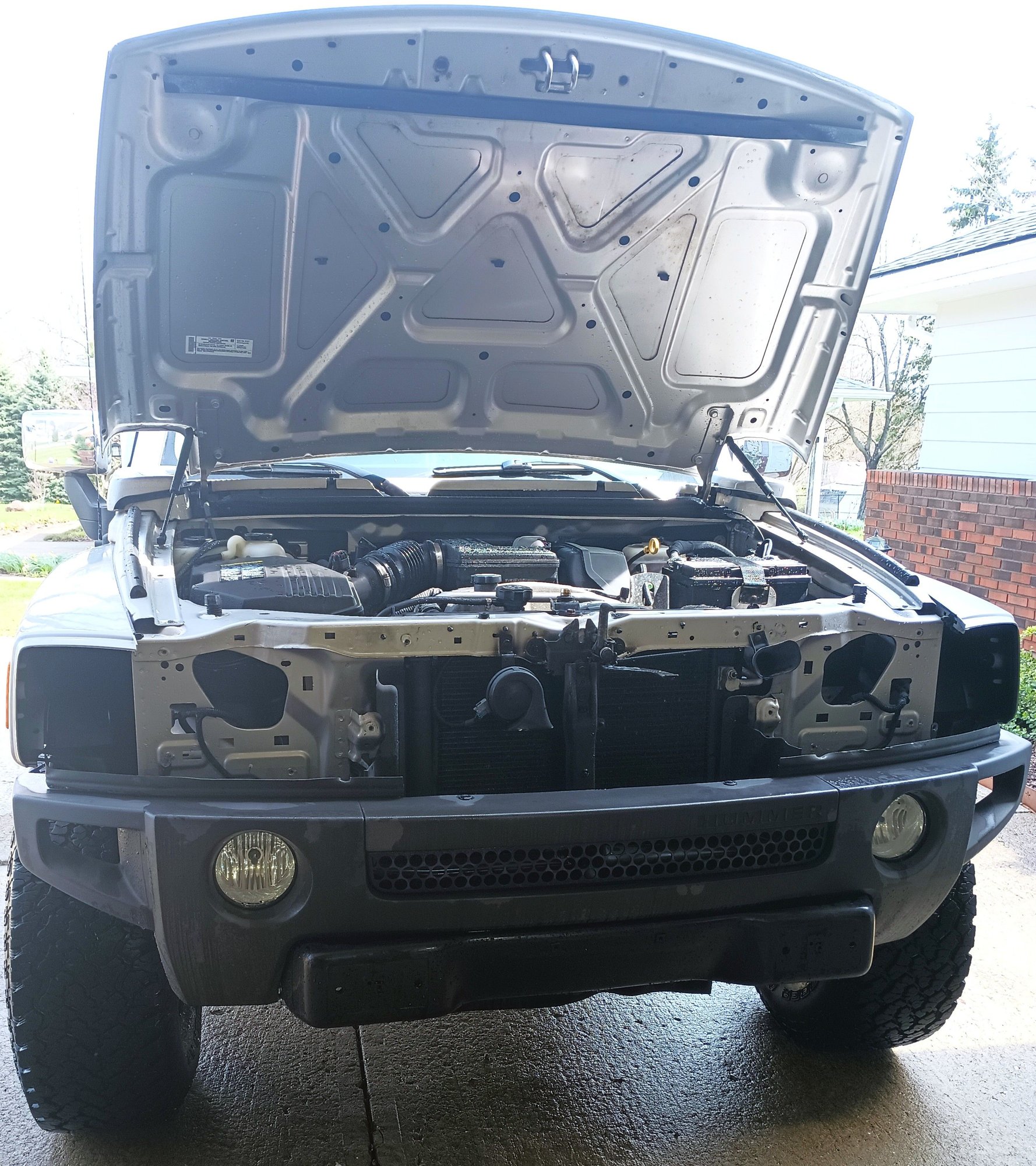

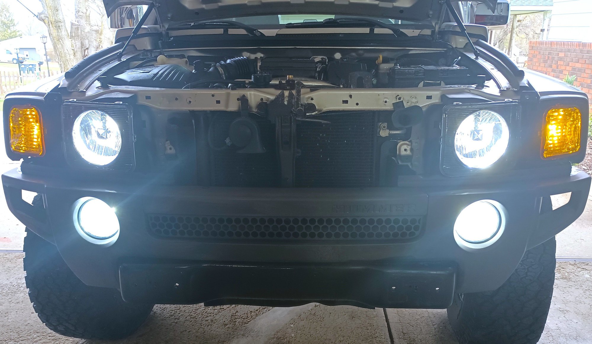

Cleaned the front end + radiator/condenser fins outside(finally above freezing temps here). Then installed the new headlight assemblies with the new bulbs. Also installed the new relay into #89 perfect fit cheap replacement for the 5810-0201.

Tell us about the LED bulb performance in the dark.
Old Apr 14, 2025 | 08:53 PM
Posts: 9,014

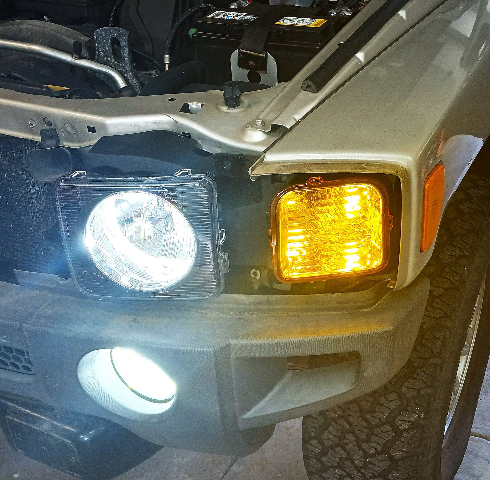

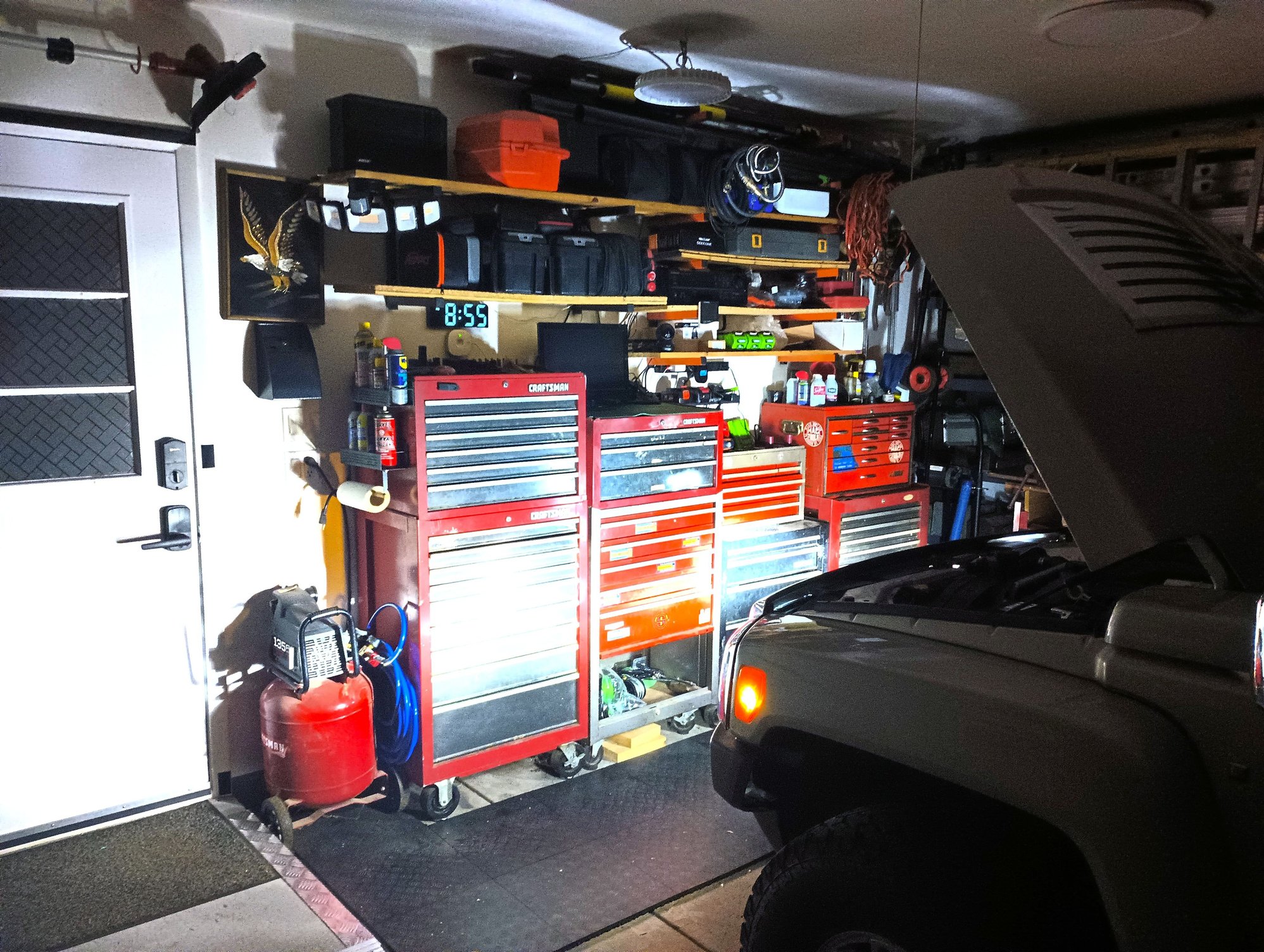

Brightest super white bulbs I've tested many.
Picture inside my garage with ALL AC LIGHTS OFF.

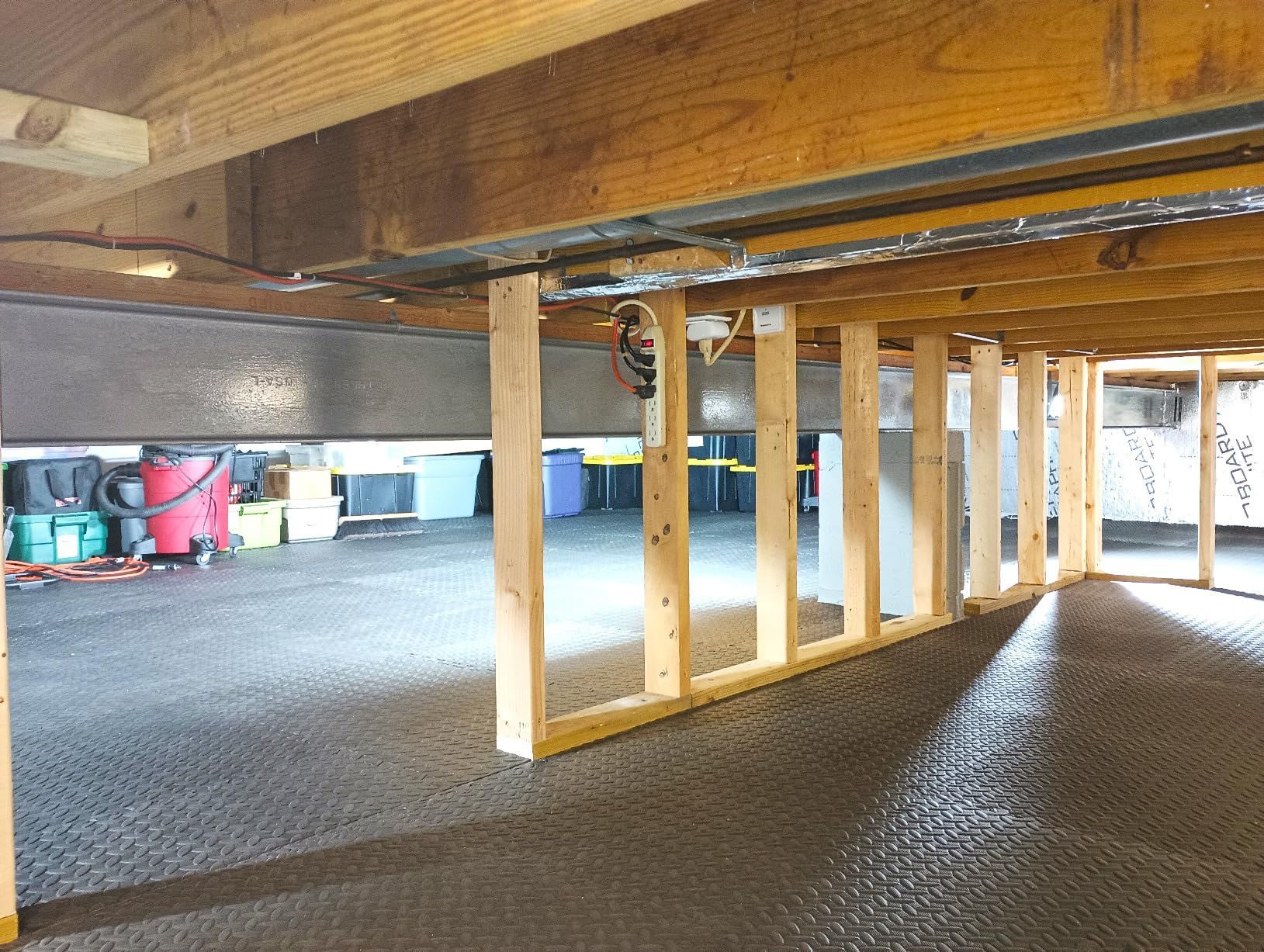

That is the nicest 'CRAWLSPACE' I.ve ever seen
Thanks. When we purchased this home 2-1/2 yrs ago it was dark with a mess of rotted wood standing water dead rodents insects mold etc.... on the floor.
OVER 600 square feet of storage.
Many hours labor working on my back & knees:
Many pounds of quikrete hydraulic water-stop cement
Many gallons of drylok extreme masonry waterproofer
Many tubes of dynaflex 230 caulk
Many sheets of
silverboard insulation & pl premium poly construction adhesive/tapcon screws & foam board washers.
Many boxes 1/2" eva foam interlocking floor mat tiles
10 led panel/flood lights controlled with 4 separate circuits around
150,000lms total light
Climate controlled along with dehumidifier inside.
Right side for the wife's thousands of holiday decorations in totes.
Left side for my building construction remodeling materials.
I removed the vintage paneling access cover & installed custom double doors
The access is from the lower level family room that I cover with a wood cabinet on wheels.
Much easier to access storage vs climbing into an attic!
