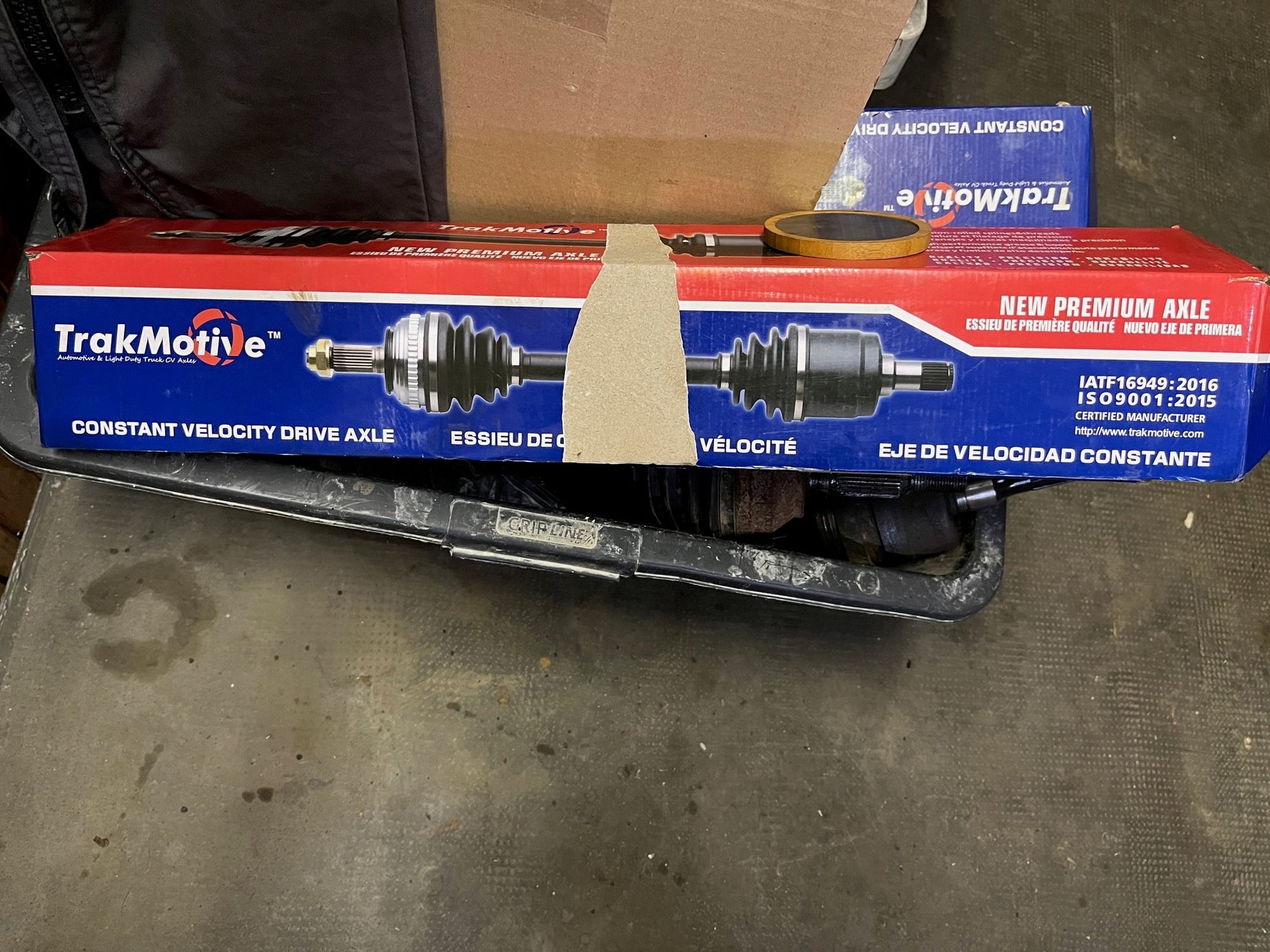

Hello all, it' been a while but, got real truble with my front end. After my last offroad trip, noticed that the front left CV Axle shaft was leaking grase.... so changed it with the one i have spare from TrakMotive......drove a bit and wow, horrible vibrations but only when i drive and turn like more than 50% , not when i drive straight ! So , thought the right side CV was gone to and..... changed it too with the same CV Axle , it was my last spare one...Drove and the same vibrations/clunk appeared , only in turning moments , like something slips or so...????
Checked the front bearings for play , drive shafts , bushings....nothing wrong... So, It didn't vibrate bevor i changed the first CV axle shaft so.....
Here the CV's i had for spare. HELP guys.Thx.
And now just ordered 2 from RockAuto ACDelcos...... praying that the CV's are the reason for those bad vibrations

Did you install new axle nuts torqued to 260 N.m 191 lb ft?

yes of course

maybe the axel shafts are a bit longer than OEM and binding?
Thanks , hope that's it ... have to wait until the new CVs arrive .... on may 22
