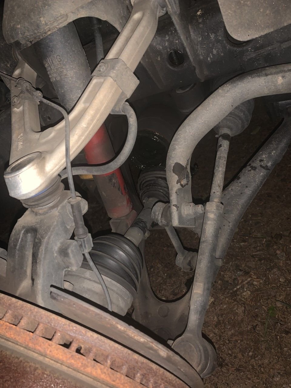

Hi everyone, my first post / question.
Model: 2008 Hummer H3 Alpha
My 17 year old son just had the lower ball joint break on the front passenger side of his Hummer - and it looks like things rumbled around before he made it to the side of the road. (see picture) Hummer was towed to the house and now we are accessing the damage.
1. I can see that the CV Axle has separated / broke - I am unfamilair with this so - can I fix this or do I replace?
2. If I replace the CV Axle on the passenger side, do I need to replace on the driver side? (i read somewhere that newer half-shafts may be a little longer)
3. I am concerned that the sway-bar may be bent, can anyone tell from the picture?
4. We have talked about new shocks, I guess while doing these repairs would be the optimal time to replace or does it really matter?
5. I am going to replace the sway link as well, should I take care of anything more while I am here?
I am not a mechanic
but almost always figure out how to fix my vehicles, plus I use these oportunites to show my son how he can do these things and save a bunch of money.
Thank you.

As long as the tripod bearings are still intact, install a new boot & grease, push it back in, secure with band clamps, and drive on.

Judging by the photo - replace the CV Axle. It must be replaced with a new one.
Replace bearing and seal immediately.
You can remove the entire drive axle and drive without it. Just need to block the differential in the transmission.

A 2008 Alpha with how many miles?
Do yourself a favor, replace it with an ACDelco half shaft and do NOT use the aftermarket cheap stuff as many are too short, rebuilt and not worth that fleet feeling of saving a couple bucks only to have it create more problems and have to replace it again, and again.......
RockAuto has them ACDELCO 15886012 $252.89 and you can sometimes find them online for better prices if you had time. The $65 replacements are cheap for a reason.
If you want to rebuild the busted one, do it after the replacement for a spare.

I happen to agree with Doc Olds on this particular repair. If $265 is too much for a reliable repair, get rid of the vehicle. It just makes good sense to repair something with the best value in terms of quality and price.
Hummerz and Diesel have a plethora of experience, but this time I say..."Get the best value replacement parts". Happy Trails!

Lower ball joint separated causing cv axle to EXTEND and separate from the inner joint. Why spend $265 when you can get a boot kit for less than $20?
