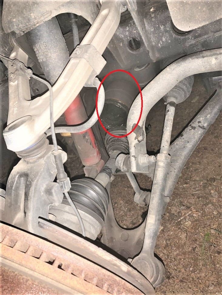

Have you ever wondered why his shaft flew out? Why won't the snap ring hold?
If there is wear on the metal, then the shaft will fly out again.

Posts: 9,017
Inner joint is only held together with the boot. Ball joint separated, knuckle flexed and extended the cv axle which pulled the tripod bearings out of the tulip. Can also happen while replacing control arms/ball joints on the lift. Look closer at smokels picture, you will see the tulip is still secured in the front diff(held on via the snap ring, yet the boot split and the shaft pulled the tripod bearings out.
