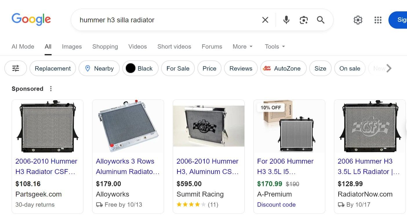

Why spend 4x$? My Silla installed back in 2012 is still sealed tight not leaking. Btw you can get 4 replacements for the cost of CSF
