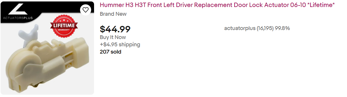

I had this exact issue on my last H3. If lubricating the lock and the actuator doesn't work (it didn't for me) there's a company on eBay that sells just the electronic solenoid that can be easily swapped into the existing door lock mechansim. The solenoid is attached to the door latch mechanism with just a few machine screws. Or, for 4x the price, you can also buy the whole latch mechanism assembly.
Search eBay for ActuatorsPlus. Here's a link to their current H3 offereings:
https://www.ebay.com/sch/i.html?_dkr..._oac=1&_nkw=h3
Driver Door Here:
https://www.ebay.com/itm/202849594747?_skw=h3&itmmeta=01JDJDC6Y7VMYNE2DE3Y3  NBQ07&hash=item2f3ac72d7b:g:BkcAAOSwQDZkg26H
https://www.ebay.com/itm/20284959474...cAAOSwQDZkg26H
