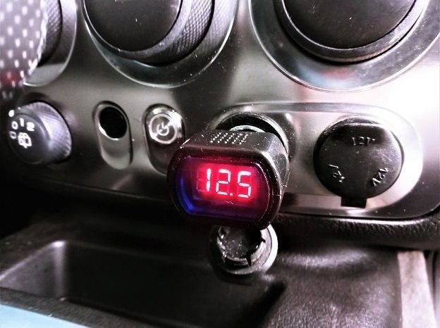

Easy test.... put a volt meter on the battery and see what the reading is at rest, should be 12.6+.
Let us know how it goes.

Better to test voltage at the bcm or any auxiliary port.
12.54 on a really old fluke and 12.6 exactly on a much newer digital clamp on.
