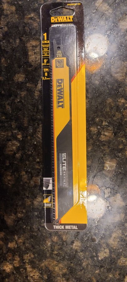

Well I got it done. Went down to rona bout some different blades for to reciprictor saw, tride a thick steel blade, a bit better then I tried a $15 CAD dewalt elite carbide tip blade and sliced through the arm in minutes. I guess blades make a big difference. Steering seems straight.
