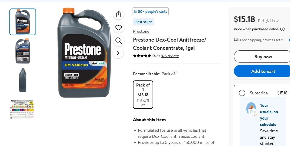

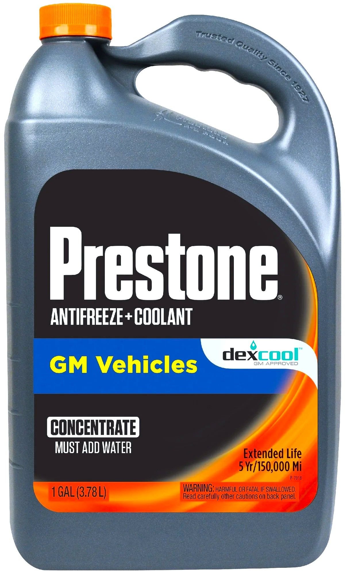

10quarts dry, get concentrate & mix 50/50 with distilled water, de-ionized water, or reverse osmosis water:
Prestone OEM GM supplier and Cheap at WM> Prestone Dex-Cool Anitfreeze/Coolant Concentrate, 1gal
