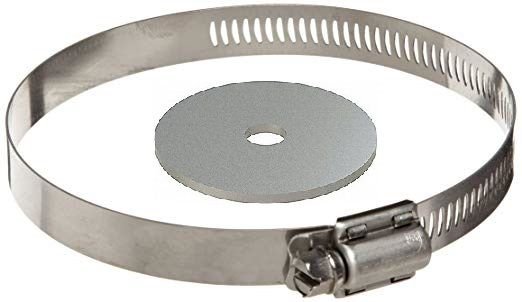

Posts: 9,017
X3
Exhaust manifold heat shield needs oversized washers.
Exhaust system heat shields needs new clamps.
