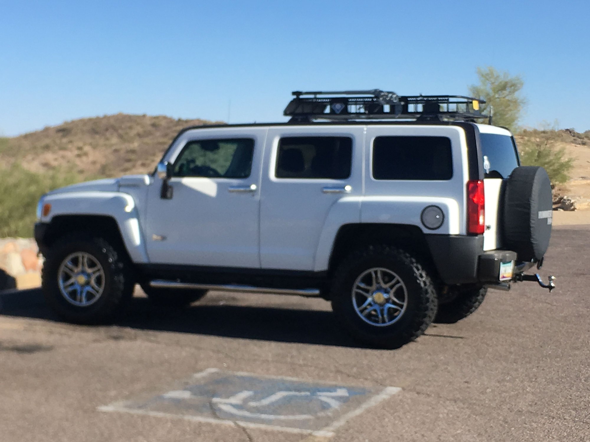

Hello my engine no longer stalls with all the things that I’ve done (I hope) but the idle falls down Below the 600 medium and the rattle is something crazy! I Give it some gas up to 700 it’s fine. I know there’s no way to adjust island needs vehicles that I know of is there something I’m missing During my cleaning?
H3 133k miles
cleaned MAF assembly and sensor
replaced spark plugs, gaps are good
ran 3 cans of Techron through over several weeks following instructions
get about 11 miles to the gallon....runs great on the highway though

Truck look good.
