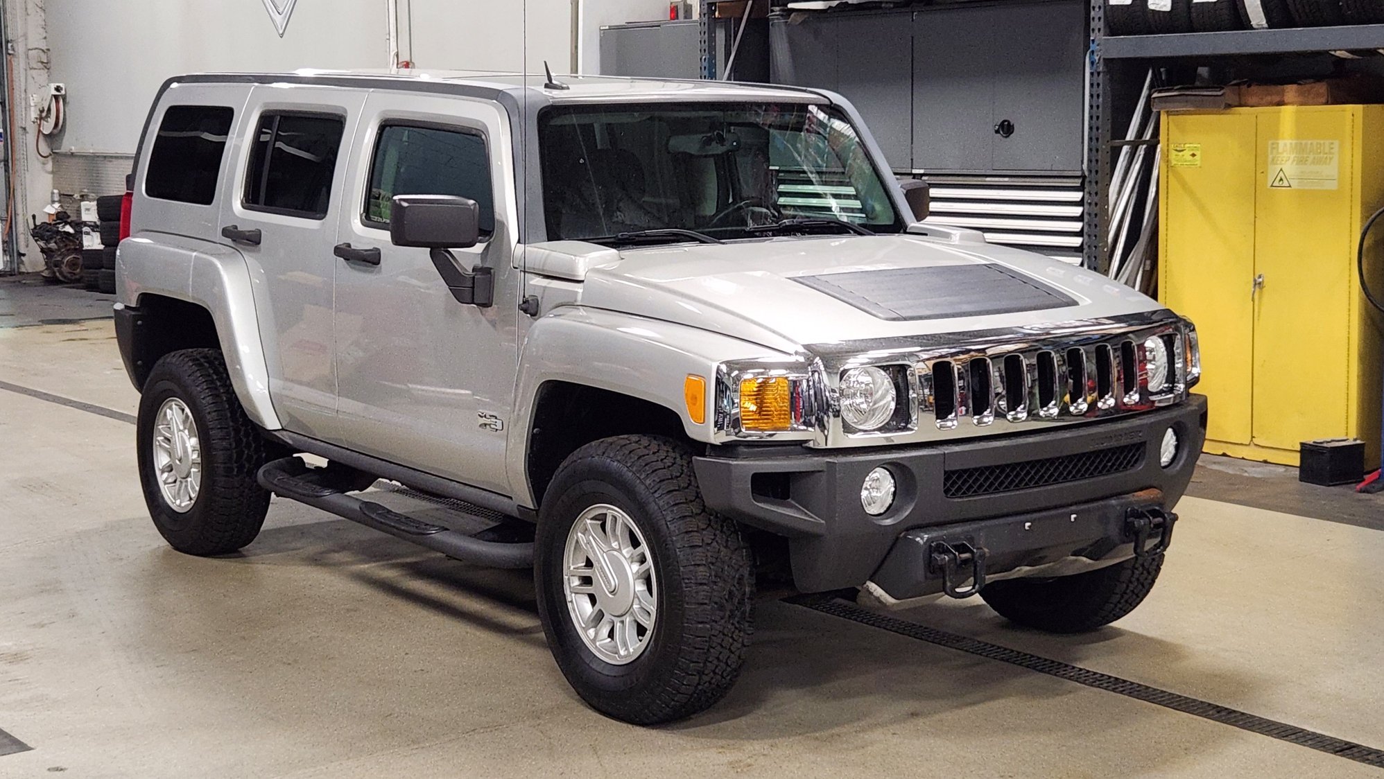

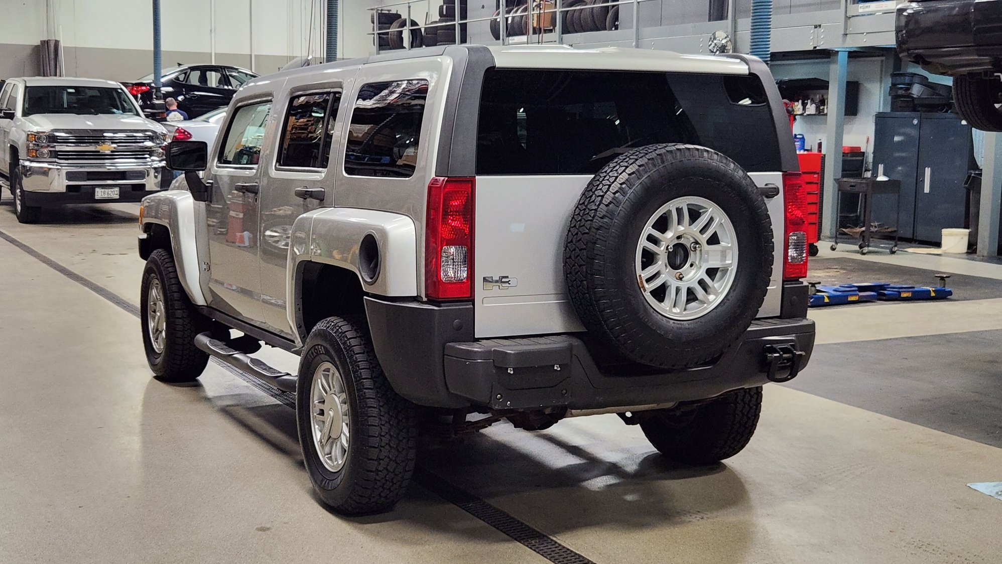

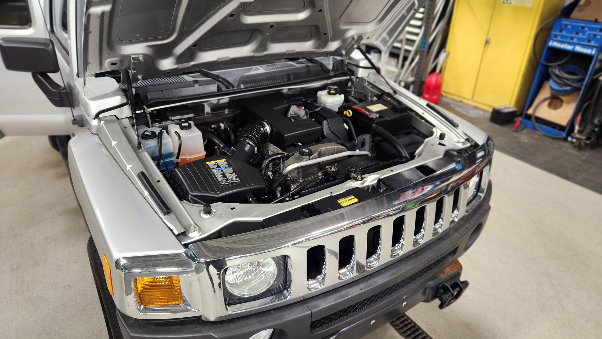

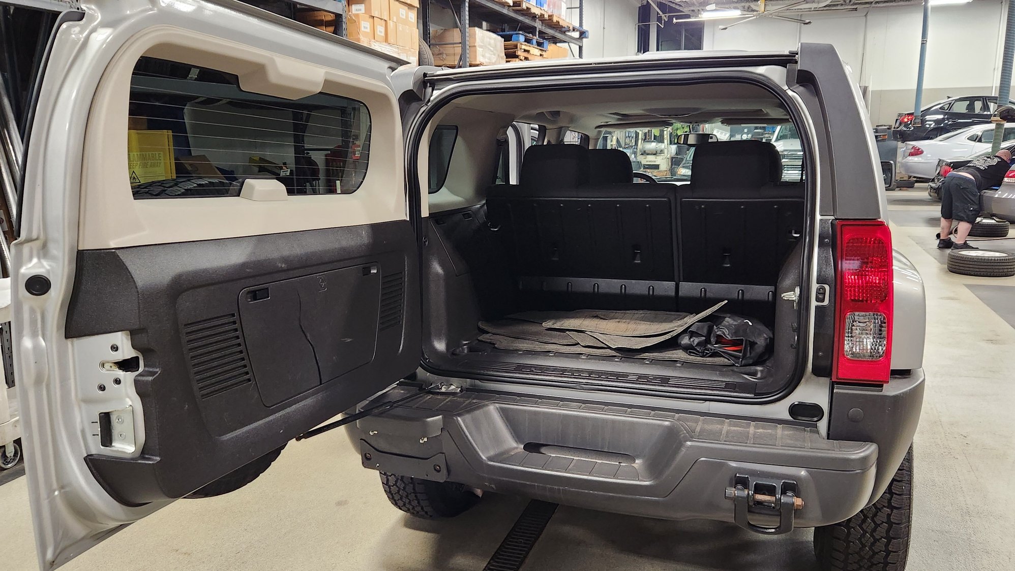

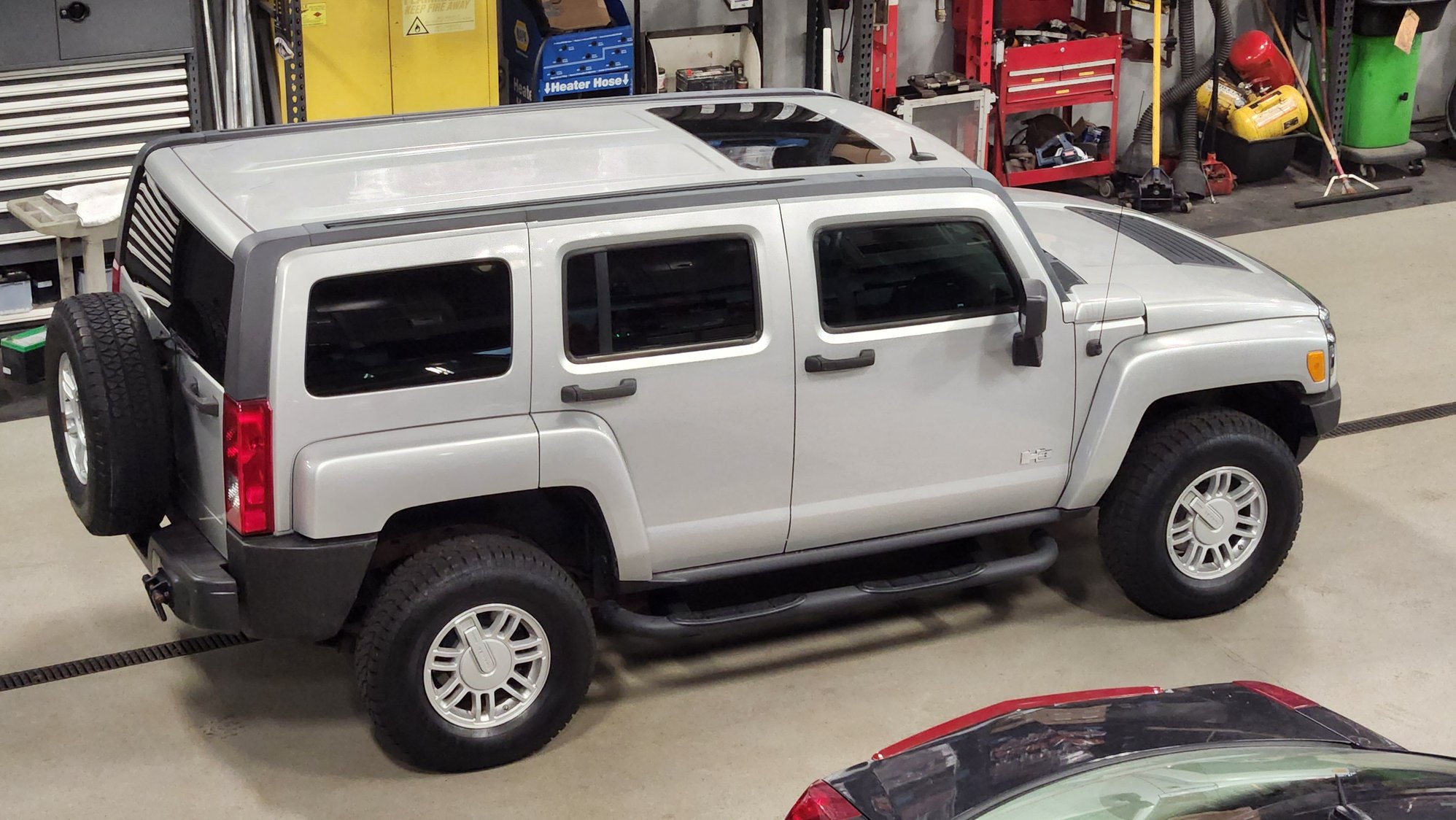

If anyone in the Chicago area is interested, Willow Creek Community Church has a nice H3 for sale. I hope it's okay that I share the detail here. I am a very new member. It would nice to see this H3 in the hands of an enthusiast.
Location: South Barrington, IL
Willow Creek Community Church, C.A.R.S. Ministry (It was a donated vehicle to the ministry)
contact: John at 847-890-1093

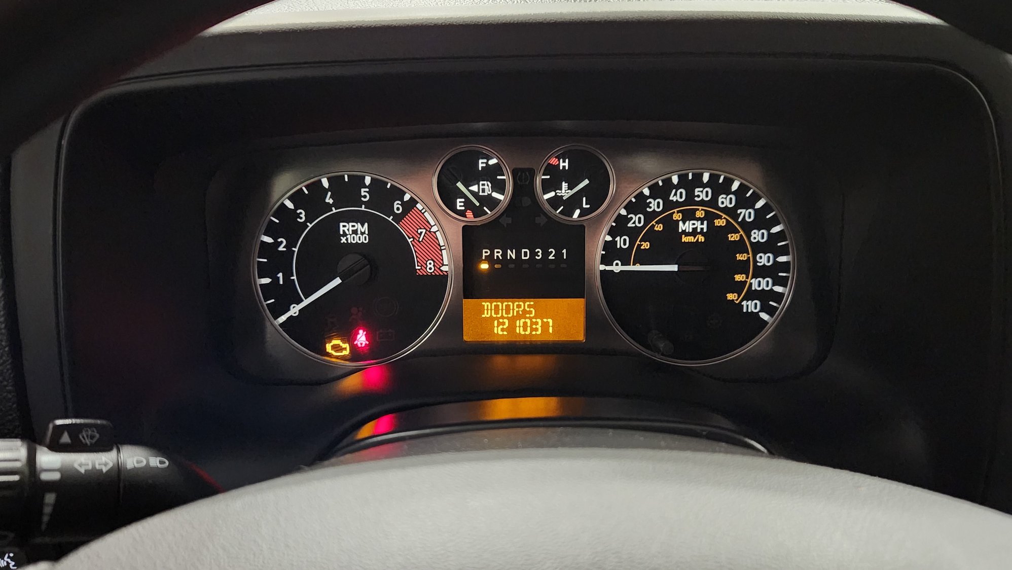

2010 H3 with 121,000 miles

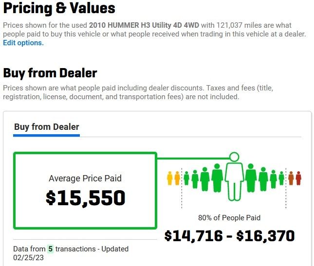

Price: $9000

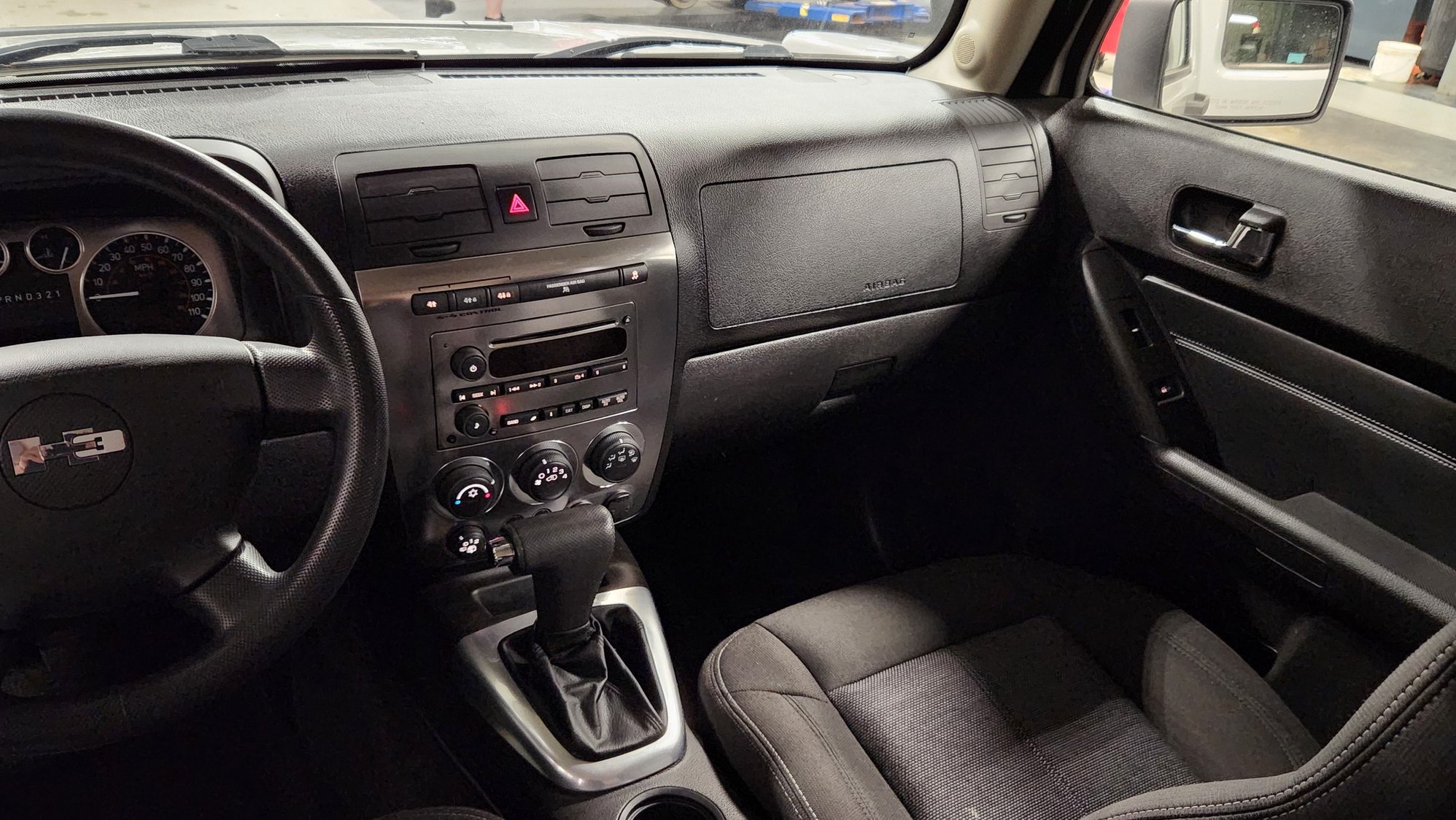

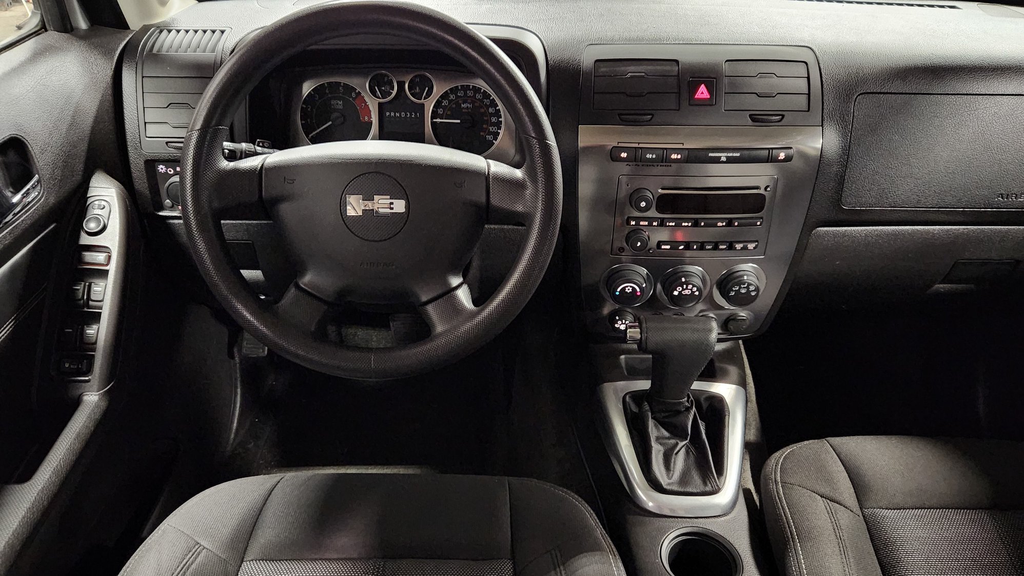

VERY clean, carpets have no wear and seats look exceptional
small wear/tear in driver seat base (see pic)
crack in the inside rear tail gate jack cover (see pic)
The 3-pod climate control, the right pod does not light up (assuming a burnt bulb)

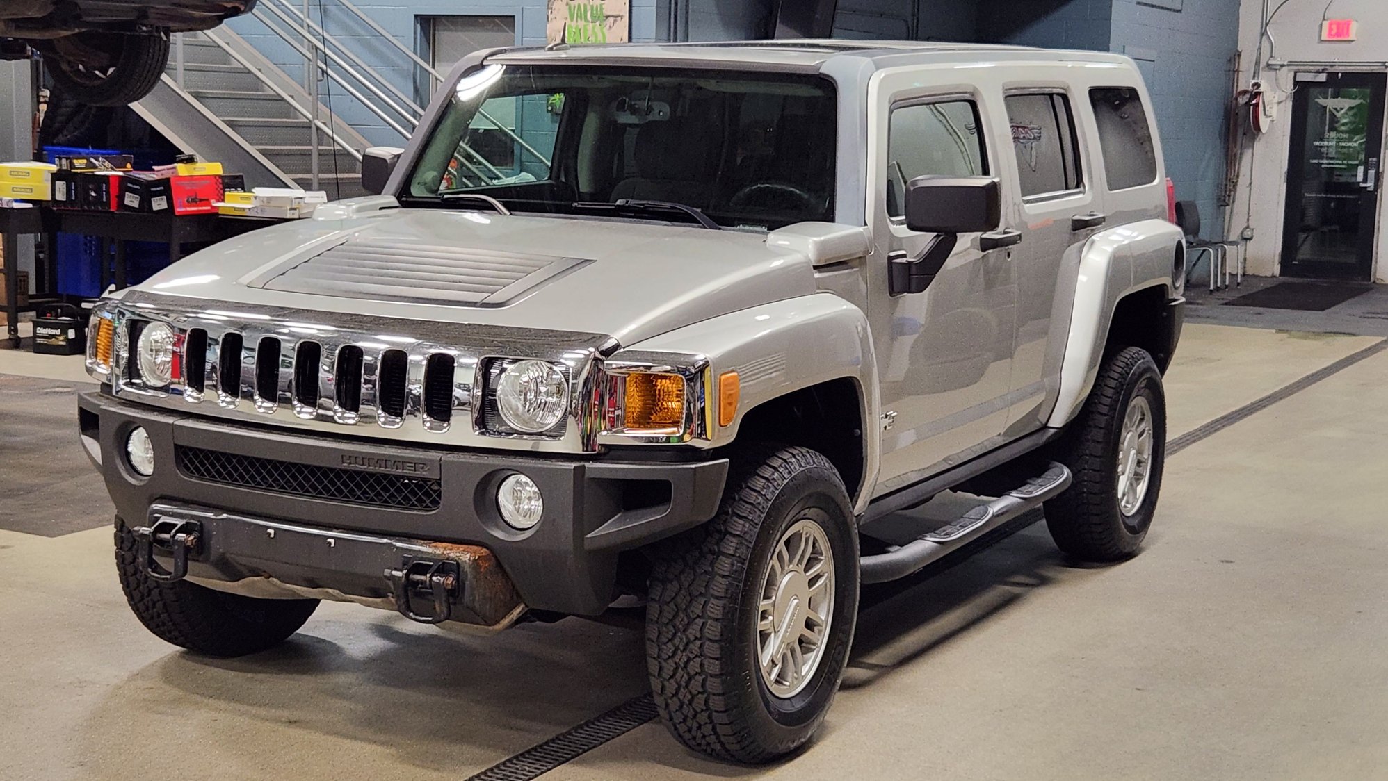

Some surface rust on front bumper (see pic)
Drives and handles perfect, very nice ride
They did some work on it, I think new brakes. Ask them.
I had it on a lift and the general underside frame and mechanical has surface rust, typical for this area, just like our 2006 Jeep Liberty with 92,000 miles has.
The lower control arm upper bump-stops need replacing
Shocks appear to be original
Good and even thread on the tires

That kind of rust on the front crash bar leads me to believe the frame must be toast as well.
Me thinks you dodged a bullet there...

Reasonably priced.

I too thought it was a great deal. That is why I shared it here for you people.
