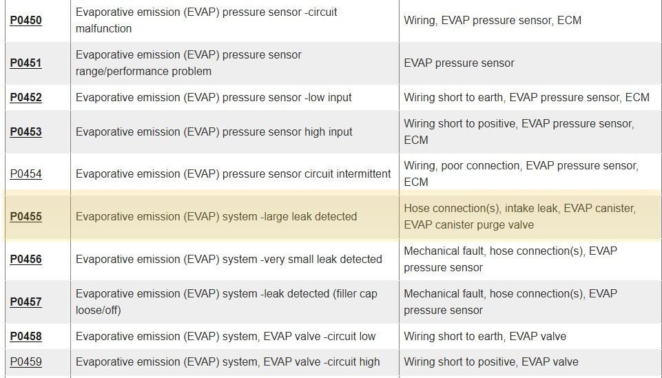

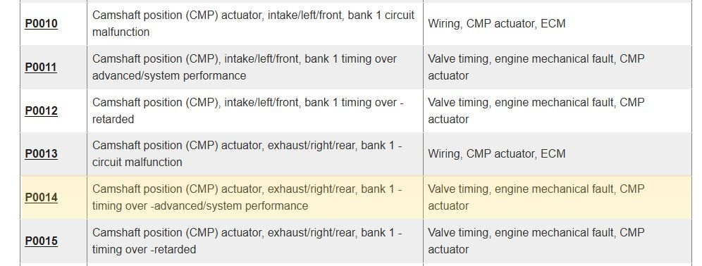

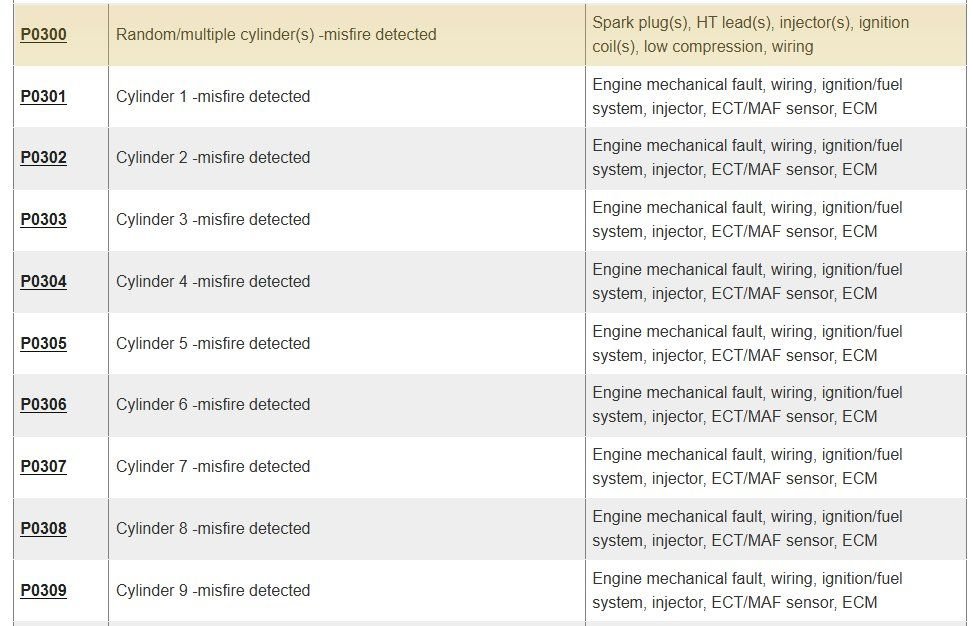

It is throwing 4 codes. Hoping you guys can give me some advice.

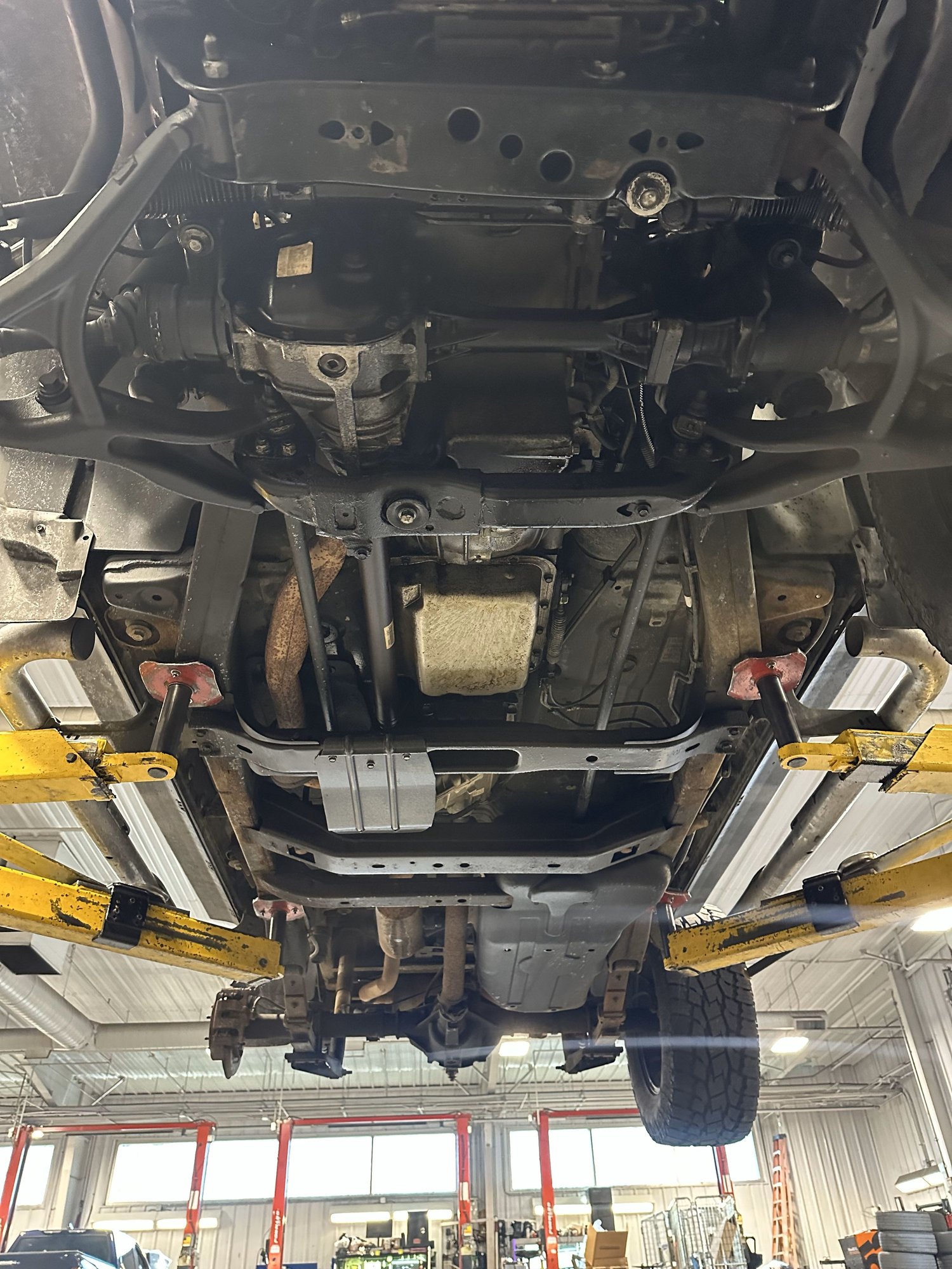

And here's a look underneath:
So they've cleared the codes but I assume they will come back. It drives fine with no hesitations or noticeable misfires. I'm trying to determine what may be the cause of each of these codes and whether it is worth it to pursue this vehicle further. It has a salvage title and is only $5K. If I'm going to wind up spending 10K on it I'll just start with a better example. This one has nice wheels and tires, roof rack, etc. that I want anyway and it has the black premium leather that I've noticed from ad photos and youtube is pretty indestructible. The interior on this thing is mint, even the mesh pockets on the back of the seats are in good shape. This was driven by a female the last few years and I'm told the snorkel was from the previous owner. No significant rust on the frame.
So can anyone please give me some advice on these codes as to what repairs I could be looking at? Should I run away? Thanks in advance for any help.

Hope this might be helpful. Couldn't find an edit button to edit the original post.

i would just move on from this one. timing chain probably has slop. the engine is showing signs that it needs an overhaul of unobtanium parts. the v8 alpha engine parts are available if you wish to consider that in your hunt for a hummer. towing is not a strong point for an i5 either.

It's actually pretty clean. Agreed salvage title is a red flag but if you can get it for say $3700 to $4350 I'd maybe take a stab at it. Lol! Mind ya, I'm stupid so a 18y.o. H3 is right up my alley. I have a soft spot for neglected Hummers hahha!
Seriously, take it to a reputable shop and have them diagnose it b4 you buy. Money saved if it's a dumpster fire. South Main Auto in up state NY or Pine Hollow Auto in Pennsylvania both will be more then equipped to repair it. Or if your very creative and auto savvy do some wrench'n.

Another consideration on this one is that it also looks like its been flat towed behind an RV. Giveaway is the shackles mounts in the front have been replaced with mounts for using a tow bar. I understand you can flat tow a hummer without the key in the ignition so flat tow miles might not show up on the odometer.
