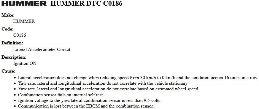

C0186 Lateral Accelerometer Circuit Malfunction
C0196 Yaw Rate Circuit Malfunction

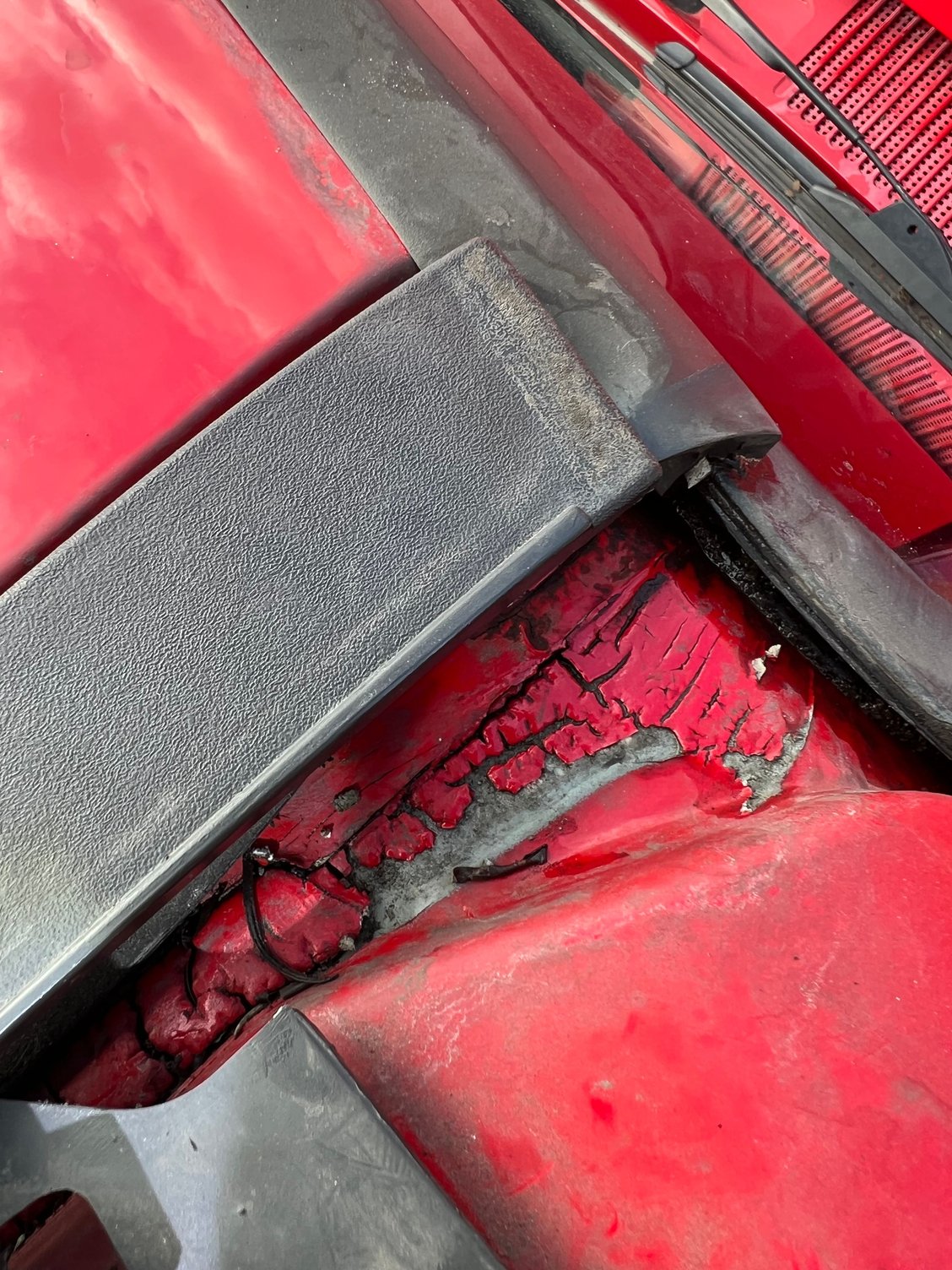

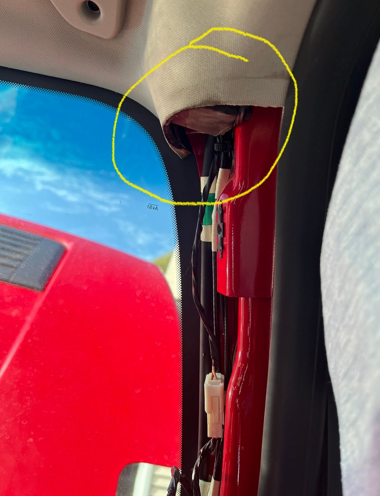

So I stripped the entire interior. Made sure all four drain plugs were unclogged (they already were but I made the openings bigger) but my interior carpet was soaked already. I noticed there is a drip from the front passenger side where the windshield meets the headliner. I don’t see any issues with the track along the roof and the sunroof drain plugs worked perfectly.
I’m thinking it might be the factory glue on the windshield after 17 years failing but I can seem to find a single post on this site where that has even been the case. I uploaded pictures below of where the leak is coming from. If I spray water on just the windshield area where it meets the roof I get water in the vehicle.
When the sunroof drains are clogged, the water overflows the sunroof tray (collects water and attached to the drains at each of the four corners) the water runs on top of the headliner and down the A Pillar. Not the windshield leaking. Do what the leak fixers do, run water on the top corner of the windshield and look for leaks inside while doing so.
I feel like this is a dumb question but the seam sealer is the glue connecting the windshield, right?
When I put water over the one spot in the corner of my car (the pictures above) right where the windshield and roof corner meet I get water coming in my A pillar. I also checked the rivet screws holding the roof molding down and they seem to all be in good shape with their rubber gaskets intact. If it’s not the windshield I’m pretty close to just pulling the headliner down.
seam sealer is used to keep water from going in between welded body panels it literally does what the name says. it is not used to glue in the windshield. that would be either butyl or urethane. even though seam sealer may also consist of urethane. but it stays flexable as opposed to seam sealer which can tend to be much firmer in consistency when dried.
but seam sealer might be on the panel seams underneath where the windshield adhesive has been applied.
