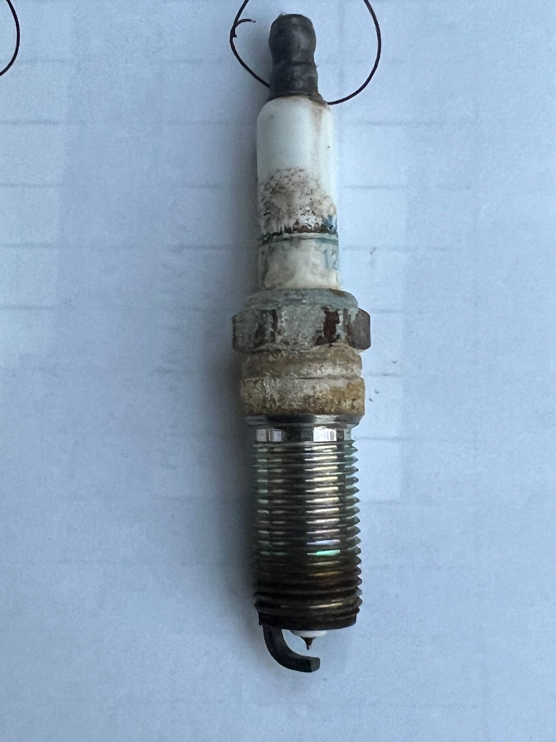

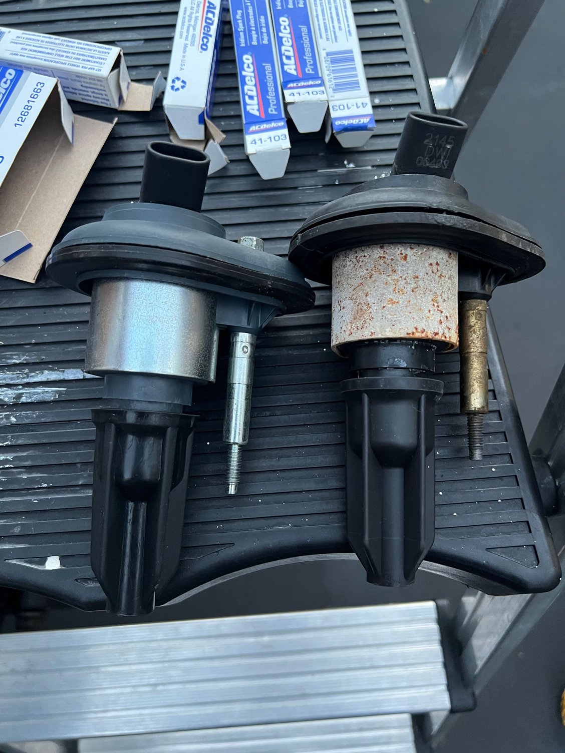

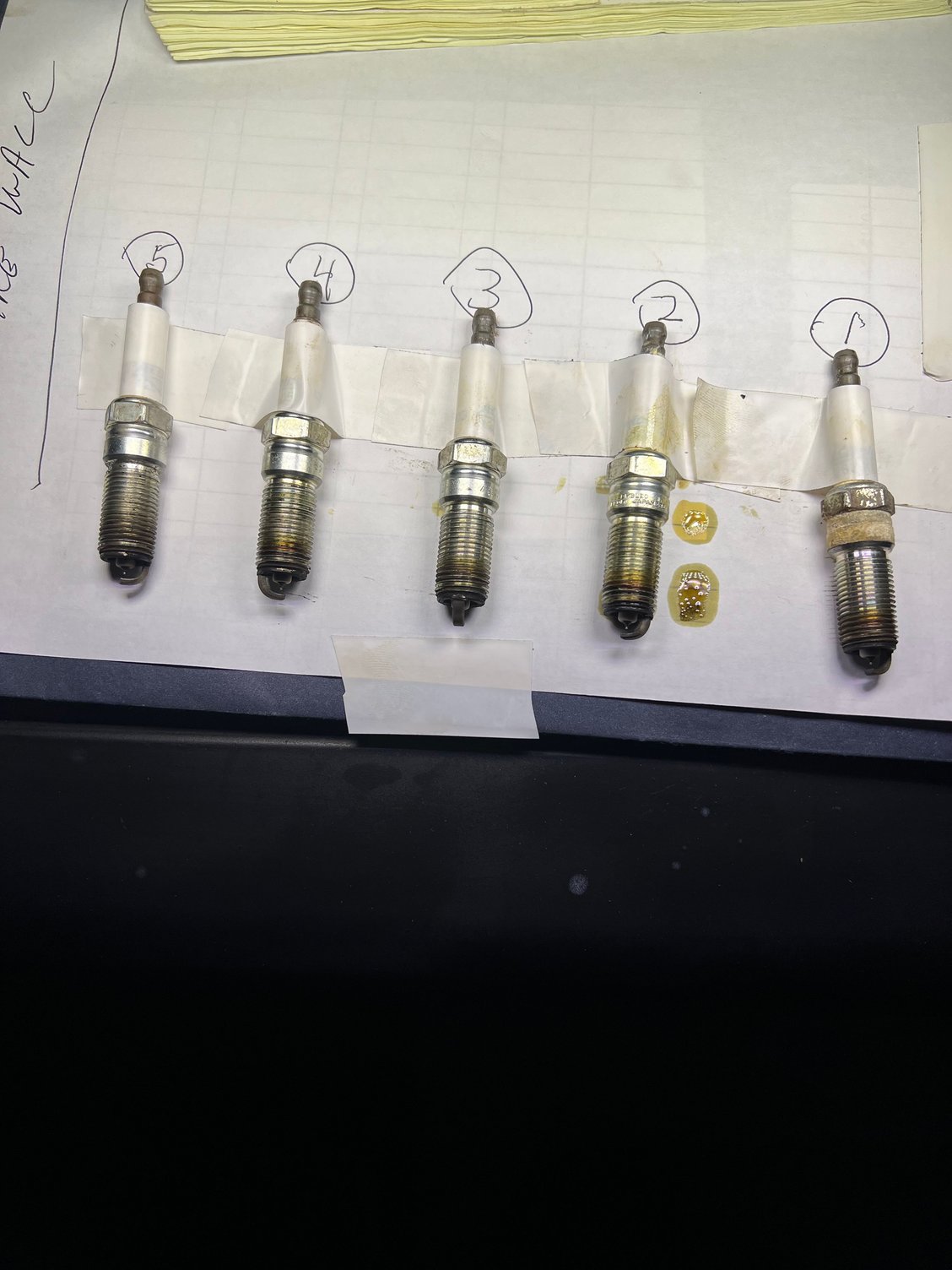

I didn’t want to start a new thread over this but I also changed the spark plugs. I noticed one plug had corrosion and so did the corresponding coil pack. This was in the cylinder closest to the radiator. Any idea what my plugs are showing? I’d take it I need to at least replace that one coil pack now but I wonder how it got like that. Engine seemed to run fine.
Old Sep 20, 2023 | 10:23 AM
Your front coil pack got like that because it is OLD and in the front where moisture can get to the easiest.
I would not have replaced it. Learned a long time ago: Don't fix it if it ain't broke.

I left the coils alone but did change the spark plugs (figured 17 years old with 80k+ miles is close enough to GMs 100k mile interval).
