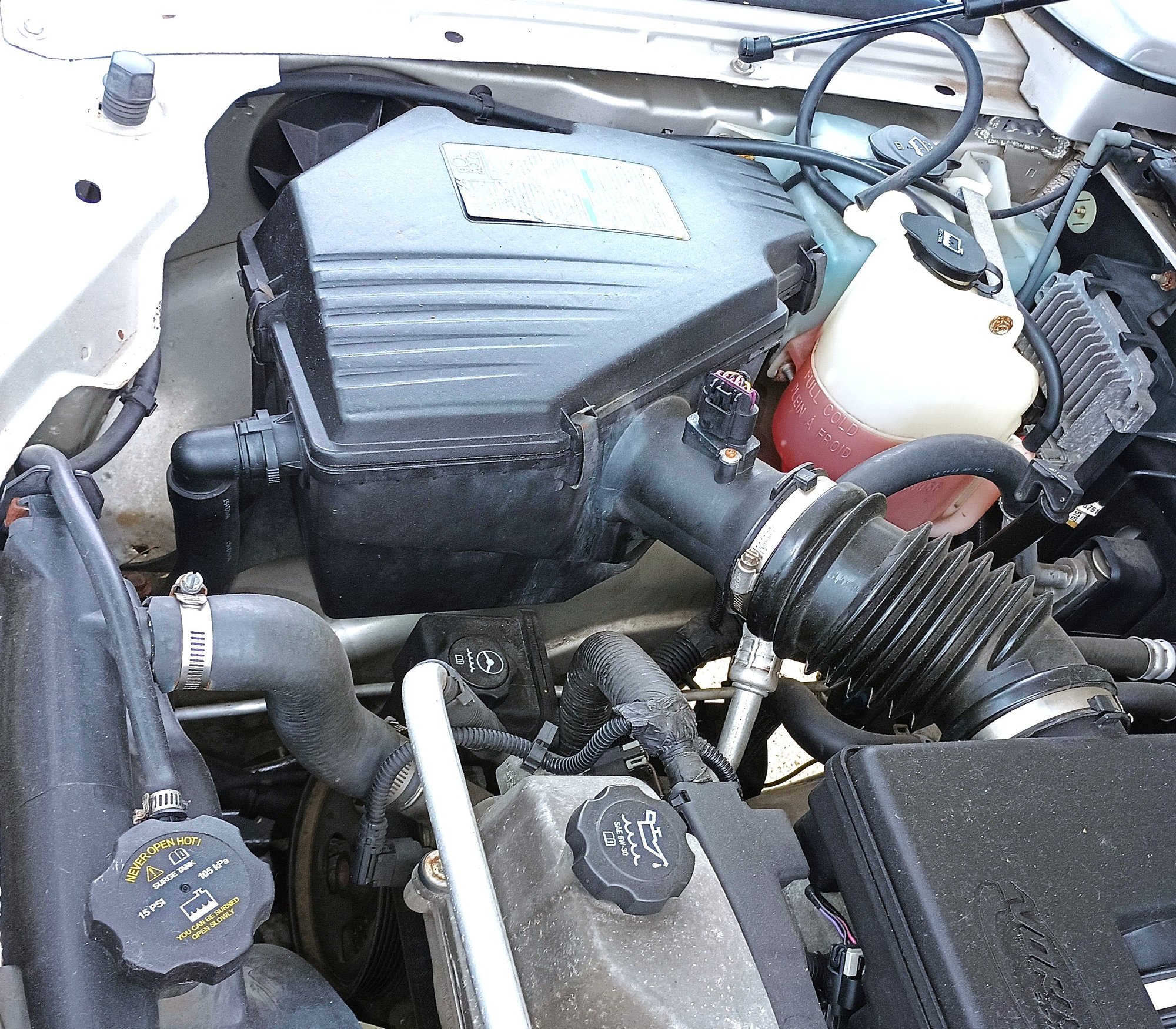

Replace the radiator cap!
The coolant overflow tank is accessed via the RADIATOR CAP. Top hose is overflow to the ground - lower hose is connected to radiator under the cap, here's a pic of mine showing the overflow hose looped for the picture reposition back down below after.:

No need to worry when you open the hood & see the coolant reservoir at the FULL line! Pic from '07 today posted above:
