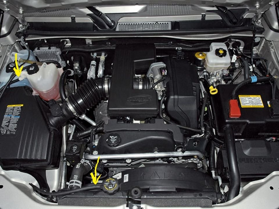

hey folks, I got 2007 hummer H3 around 135k miles. recently all the sudden I been having bubbles coming from the coolant reservoir and overheating like 220+. and when I drive on it, the coolant in the radiator is low but the reservoir still full. I did a chemical block test for blown head gasket and it came negative, no leak visible anywhere outside, no white smoke from exhaust and no mix coolant with oil. I did a pressure test and it's not holding pressure when I go 15PSI, it immediately start to go down slowly while bubbling coming from the coolant reservoir. I changed the thermostat thinking it's maybe not opening but still the same problem.. anyone knows what's going on? is it a bad head gasket???

i checked that and checked the engine oil but when I use the pressure tester as soon as I put air in there or pressure it start to bubble from the reservoir

no I don’t smell anything . And I don’t see any leak anywhere. The radiator is like less than a year old but you never know maybe it got a hole somewhere???
But if there is a hole wouldn’t it leak coolant?? Because I don’t see any leak! One day I was driving and all the sudden it start to get hot luckily I was close to home so I popped the hood and looked everywhere and I didn’t see anything but noticed air coming from the coolant reservoir .. I don’t know if it’s a head gasket since the chemical test came negative but the pressure test as soon as I pump 15 psi it immediately start to leak air and pressure into the coolant reservoir and bubbles and the pressure start to drop slowly

The only route from the radiator into the coolant reservoir is through the thermostat.

and I replaced that with brand new one and it still does it . Maybe there is a crack into gasket that the air passes theo to the coolant

Radiator Cap!

Radiator Cap!
That was the first thing I replaced I got a oem radiator cap and still does it
