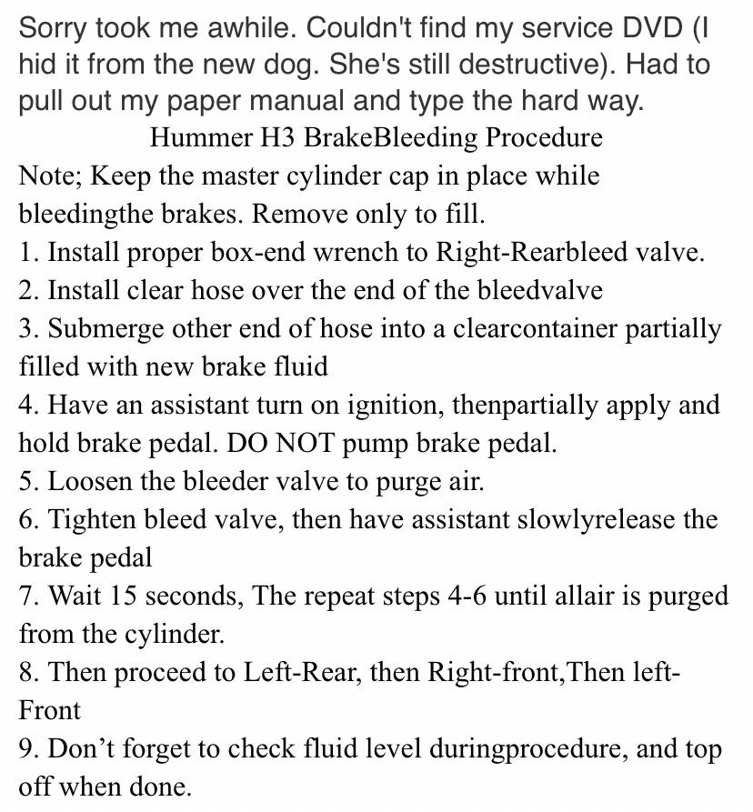

Reread Doc's message, and yes, I found that the reservoir level decreased at a faster rate than I had anticipated. Be sure to keep an eye on that as you bleed.[/QUOTE ok cool i was a little worried jist wanted to make sure thats how it went. yeah the front was quick compared to the back. so it made me nervous. but to as what i found on the bleed process doc can take a look. it looked legit so i followed it
brake bleeding process H3 Hummer

If it's coming out in spurts, then there is air in the lines.
