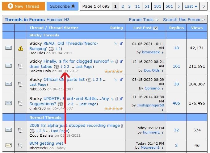

Doc, can you provide the link to solve?
Old May 26, 2021 | 05:17 PM
Old May 26, 2021 | 05:22 PM
Mbcreech1's Avatar
Joined: Mar 2021
Posts: 41
Ok great guys. Thanks for the solve.
