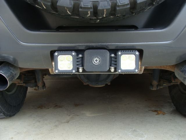

there is a forum member that makes one you can put on the trailer hitch https://hitchvision.com/shop?olsPage=products

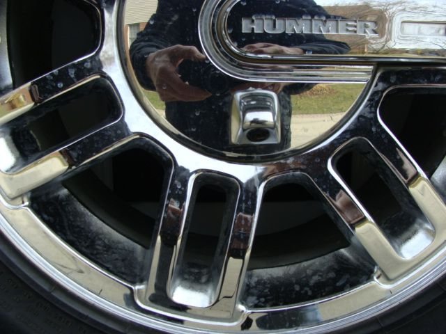

I've had this setup for 12 years and it's worked perfectly!
Took it one step further and added a second camera facing downward that I can toggle between the two.

The only reason I would not want the hitch camera alone is that I trailer.
When I want to back my rig up to a trailer I can't have a hitch cam and a ball hitch on at the same time.
Broken Halo, that chrome camera cover on the center cap is a nice custom touch!

But that spare wheel mounted camera looks awesome! It also avoids what I would consider to be the downsides of a license plate camera (at least on the H3):
  • low viewpoint
  • off center
Both make this not that useful to back up to a trailer. But that spare wheel mount would be perfect. Is this custom, or was this made with available off-the-shelf parts?

This isn't the company I bought from years ago, but looks like the same camera. I bought an extra hub cap (to be able to keep my original), drilled a hole mounted and wired....THAT SIMPLE. The camera has a quick disconnect harness so you can pop it off if you need to remove the spare.CCD universal Car rear view camera Car parking backup camera HD color night vision such solaris corolla k2 car reversing camera | CCTVonlineDIY

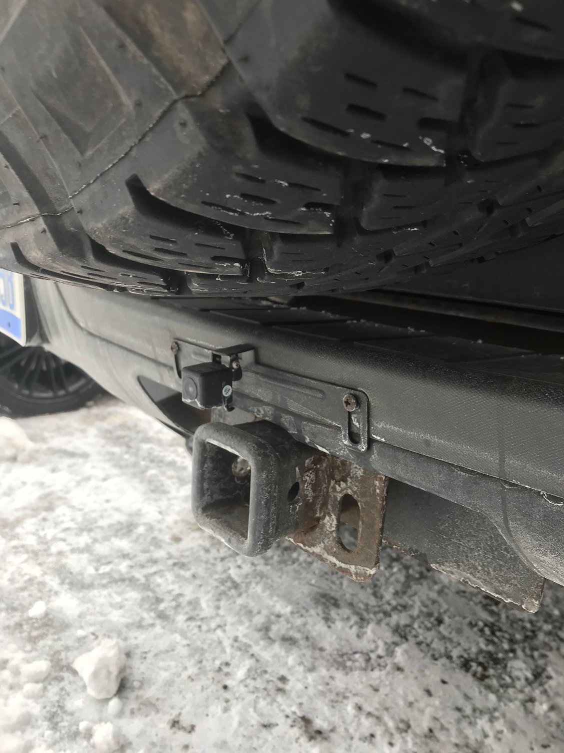

Mine is located right below the spare tire. It works fine.
