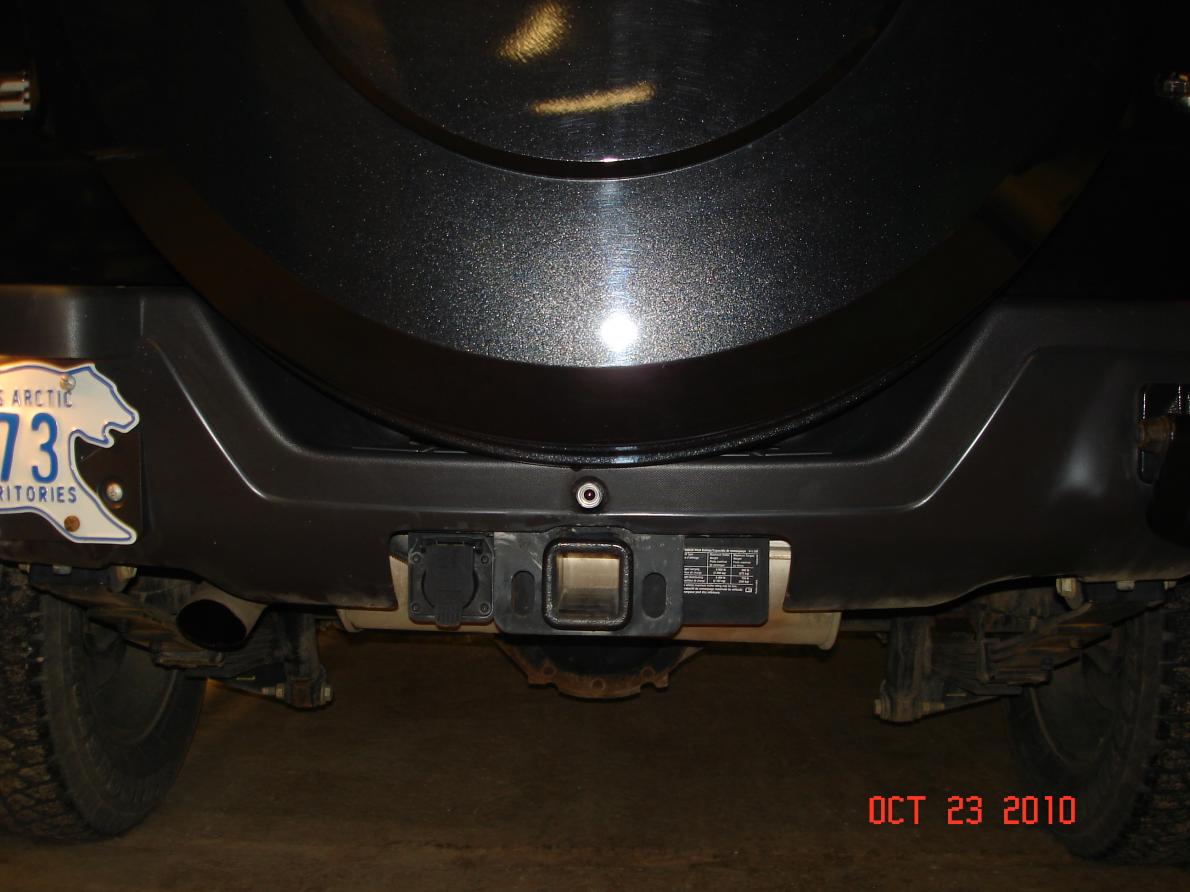

i installed mine right over the receiver and use a rear view mirror display (aftermarket)

Mine looks just like Mikeyd's. This is the one I bought:
Amazon.com: XO Vision HTC35 Universal Weatherproof Backup Camera with NightVision: Car Electronics
It's a flush mount camera so it doesn't stick out at all. They provided a hole saw so you just drill into the plastic on the bumper above the hitch and it mounts in that hole. I bought a Pioneer AVH-P4300DVD head unit that has a backup camera input so that is how I view the output.

Looks good. I was going to mount mine there but the metal behind the plastic bumper cover was curved which made me think twice. Did you drill a hole through the metal bumper or did you do something else?

I drilled through both the plastic and metal bumper. Made a spacer block to fill in the curve so the lock ring on the camera fit flat. Could have probably gone higher but I wanted to be able to have a little more gap to tighten the lock ring instead of being butted up against the top side of the metal bumper.
It overlaps the plastic trim a little but I'm over it, as long as it works as advertised.
