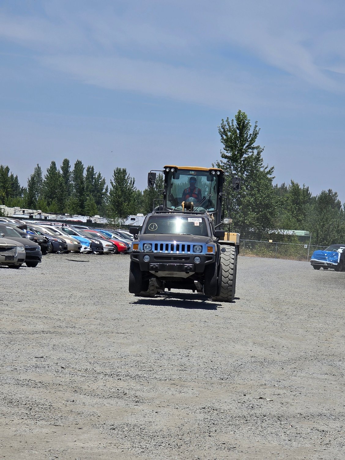

I purchased an 2007 h3 3.7 hummer from an insurance auction. Its a theft recovery. The hummer itself is cherry and looks to be almost garage kept. There's no wires cut or missing and everything is there. According to the carfax, it has right around 90k on it.
When I got it home, the battery was dead and key stuck in ignition. I put a new battery in it and when i turn the key on, the only thing I get on the dash is a check engine light. No other part of the cluster turns on. Also the rear brake lights are stuck on. I replaced the brake light switch with a gm switch and still nothing changed. I also took off the factory terminals and put new ones on since I know that's an issue. This is a non sunroof h3 and I pulled the connectors off the bcm and they look extremely clean. I put my buddies fancy code reader to it and got a u1064 (no connection with bcm) all fuses seem to be good and I did replace the mega 125 fuse to make sure. My gut is leaning towards pcm or bcm but also don't wanna throw money at it if that's not what it is. Any help would be appreciated.
