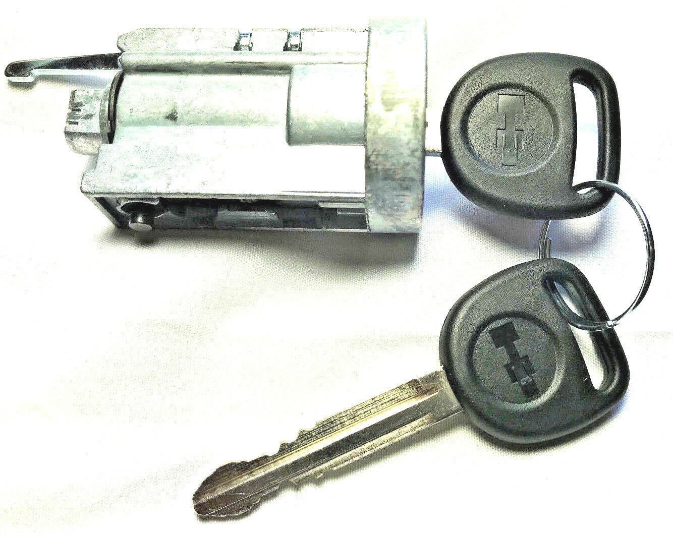

The IGNITION SWITCH is mounted at the base of the IGNITION LOCK HOUSING/CASE.
The IGNITION LOCK CYLINDER
89022365 89022365
is a separate part(NOT INCLUDED WITH IGNITION SWITCH/CASE
D1462G D1462G

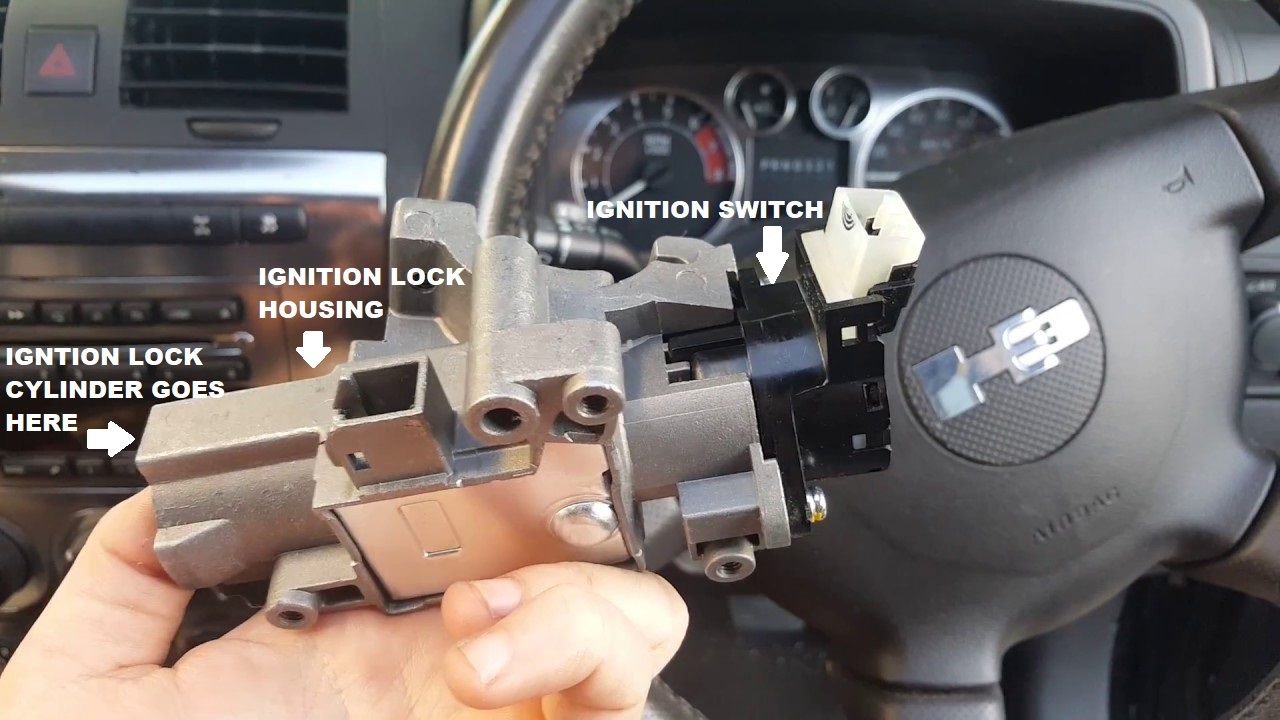

OK, the guy in the video called the IGNITION SWITCH a "sensor" because he did not know WTF the thing was he was replacing. THERE IS NO SENSOR.
There are three parts in the steering column that start the H3: 1) the keyed ignition lock cylinder;
2) the Ignition Case that #1 goes inside of;
and, 3) the IGNITION SWITCH........... otherwise known as the black thingy with 2 friggin screws attaching it to the Ignition Case opposite the key.
They can be purchased together as a complete assembly, parts #2 & #3 as a partial assembly, or individually as separate parts. Should be easily apparent now that the keyed cylinder is separate from the switch.... ie. you can use your current key with a new switch. However, you likely do not need a new switch, just clean the contact on the old one. We suggested the solution, do whatever you want.

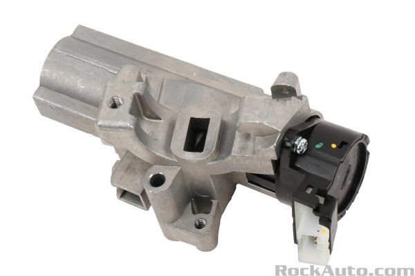

A pic of #2 & #3 put together.
