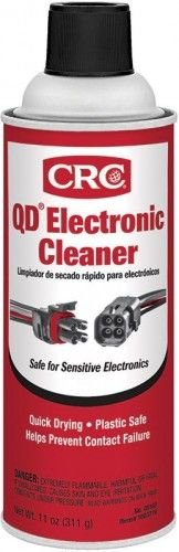

Ignition off, pull ignition switch connector and clean the connections with crc electronic cleaner. Let dry a minute, and reconnect. Should start up immediately.
Or you could replace the switch?

LHD or RHD same. I did notice there is a matchbox H3 on his key chain, I have a lot more weight on my key chain, never a problem with that! My point, I had the passlock issue 7yrs ago and through my research then, was to replace the ignition switch. I had the passlock issue again last year, and I didn't have to replace the ignition switch. I still have a good used ignition switch if I ever need it? Still using OE KEY & OE RKE 13+yrs later.
