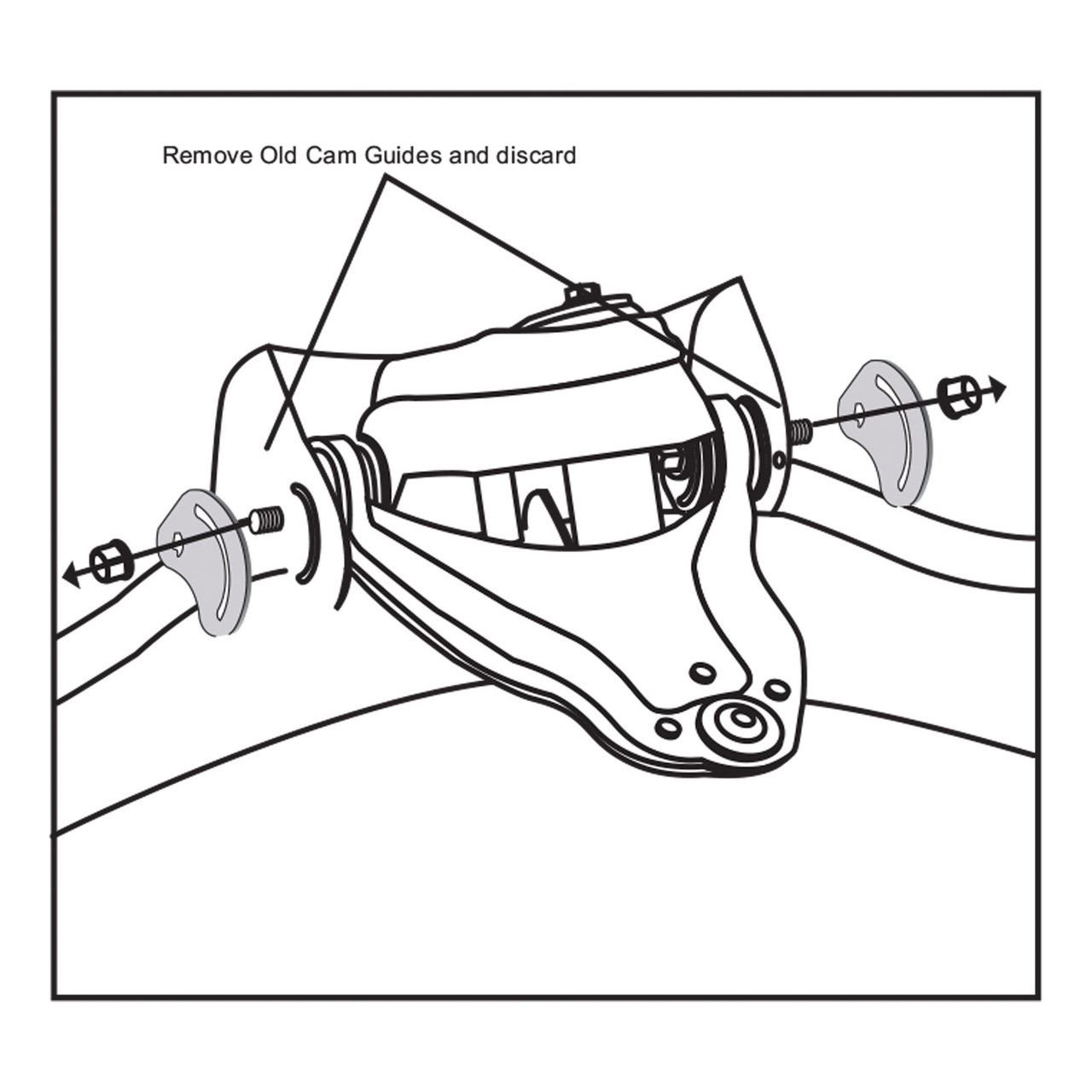

Can anyone confirm for me which way the camber adjusters go? I was pretty confident I had them on correctly to begin with but the tech states the pic below is how they should sit.

Yeah, watched that along with others. This is the second place I’ve been to get a simple alignment done! First place said the bolts were wrong. Now this place says they are upside down! Sure ain’t going to Firestone

2 alignment shops declined your business?
Install new camber adjusting bolt kits the proper way as shown above in the video adjusted close to -0- degree camber tight then take in for an alignment.
Any reputable alignment shop can easily adjust camber/caster with new adjusting bolt kits.
