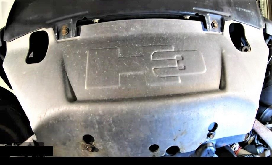

That is the splash guard that the factory put on all 2006-07s. The 2008 + have the revised ugly nose.

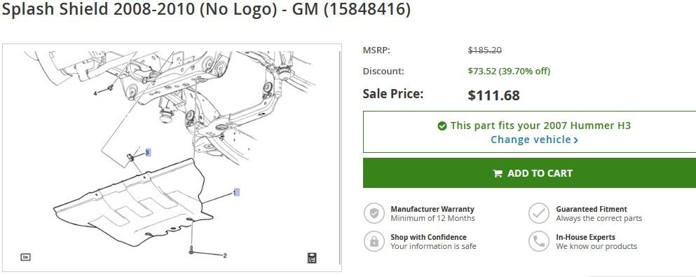

Do you know if it is interchangeable with 2008+, like the part description implies? "2007-2010 Splash Shield"

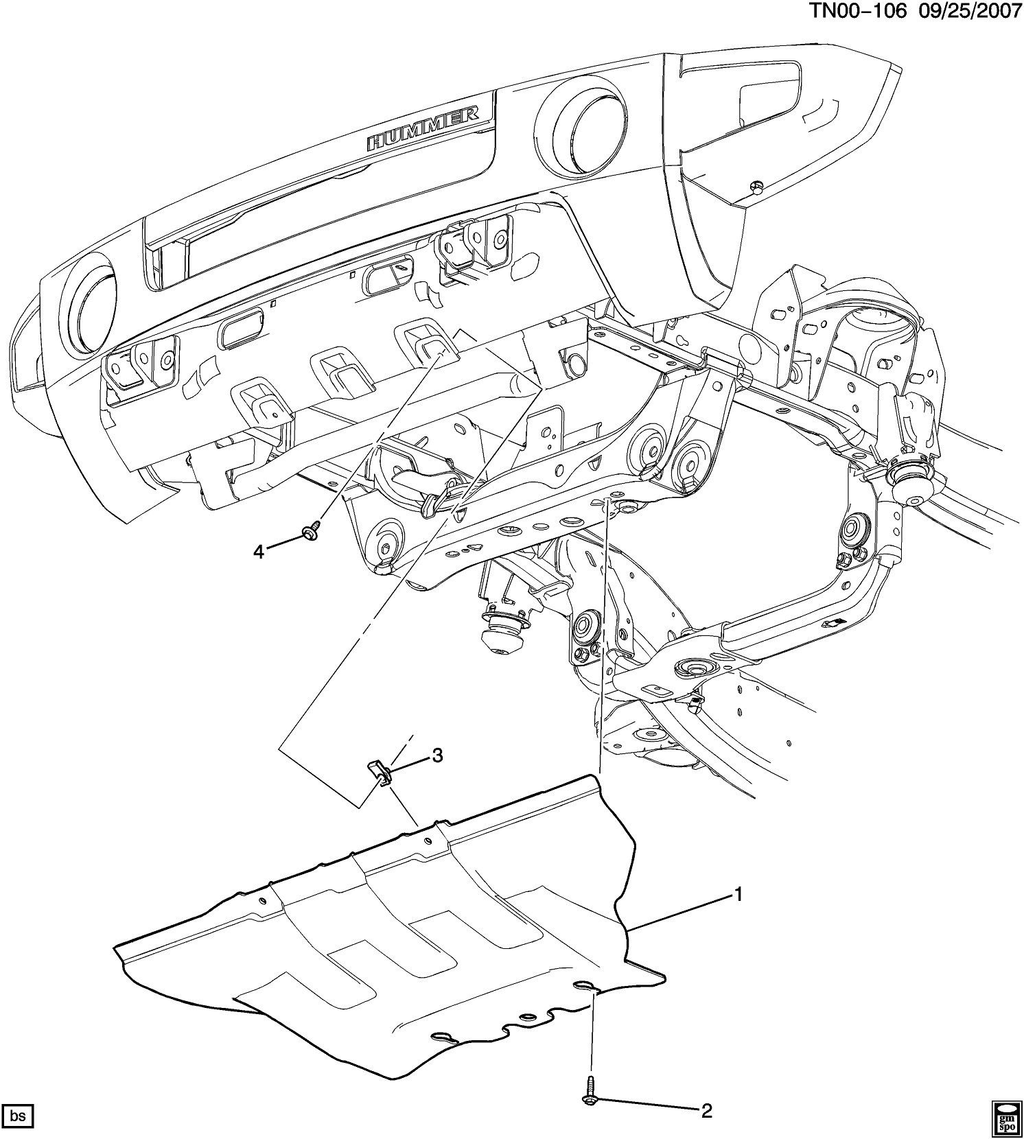

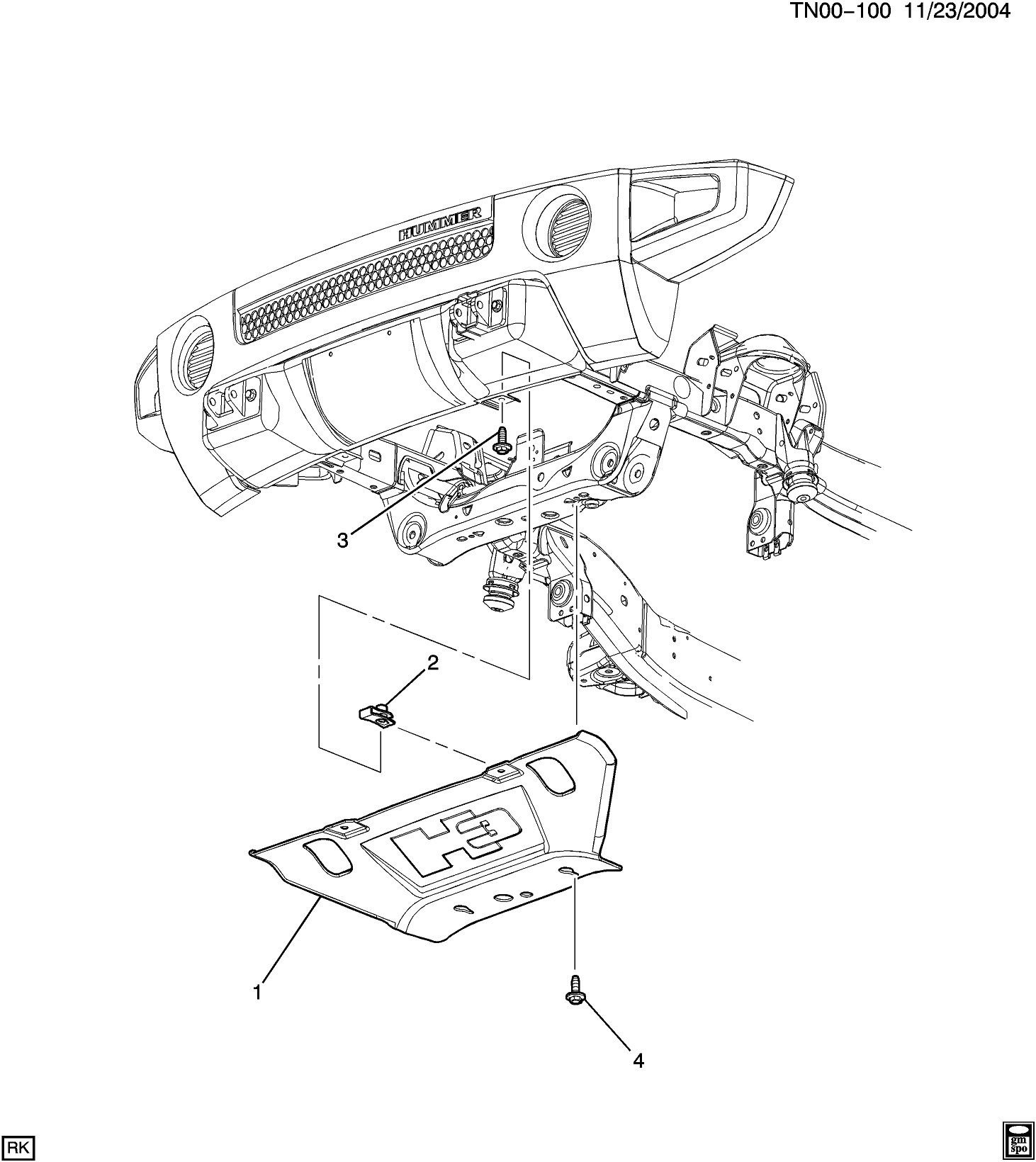

Yes I do. My 2009 has one, but it also is attached to my BA Winch Bumper which will only work with the older style. The old 06/07 splash guard does not correctly bolt on to the 2008+ impact bar. You could probably "make it work" ... but it will look like that.
2008+s do not have a flat bottom on the impact bar, the 06/07s do with only two tabs with holes for the older style splash guard to bolt on.

The difference is the impact bar grooved design. The skid plate is the same on all years, therefore the rear bolts match.
GM sites show they are interchangeable. Check measurement between the front bolts, my '07 front bolts are 18-1/2" apart on center.
