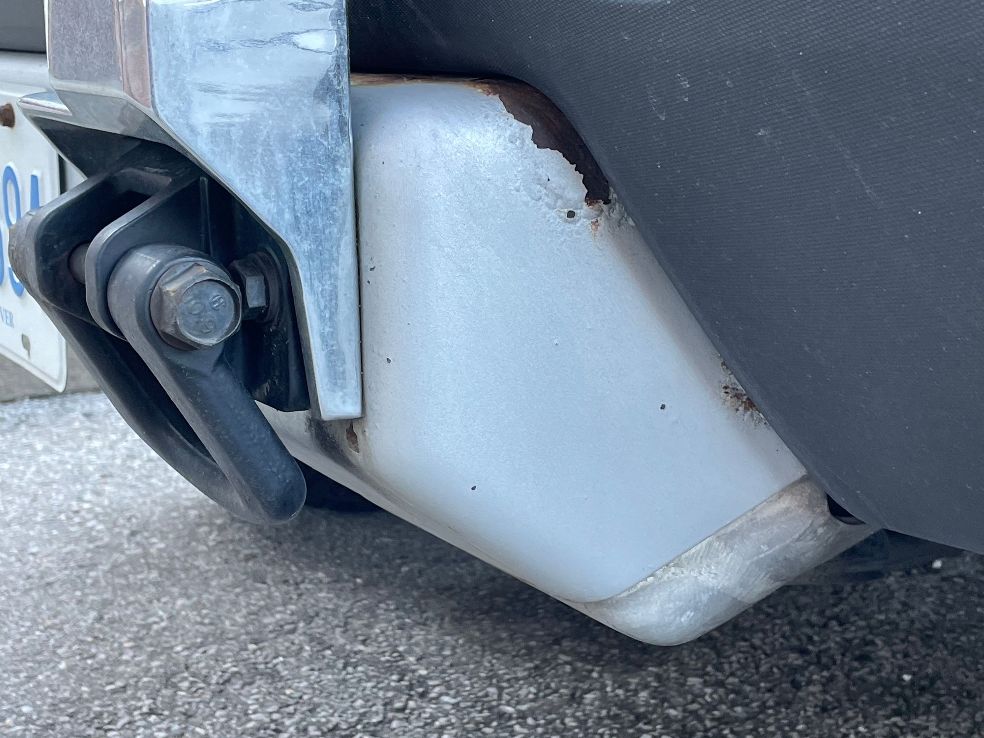

Can the Center part under the bumpier be replaced? See picture. Mine has some rust on it. Anyone know the name of this part, where I can get
one and can this part be replaced? I heard sometimes if you take the bumper apart it’s very had to be put together.

Nothing hard about removing the bumper, taking it apart, and putting it back together. Unplug the fog lights and 8 bolts (plus 2 small torx heads if your model had them in the center of the D Ring Brackets). On a 1-10 scale, about a 2.5.

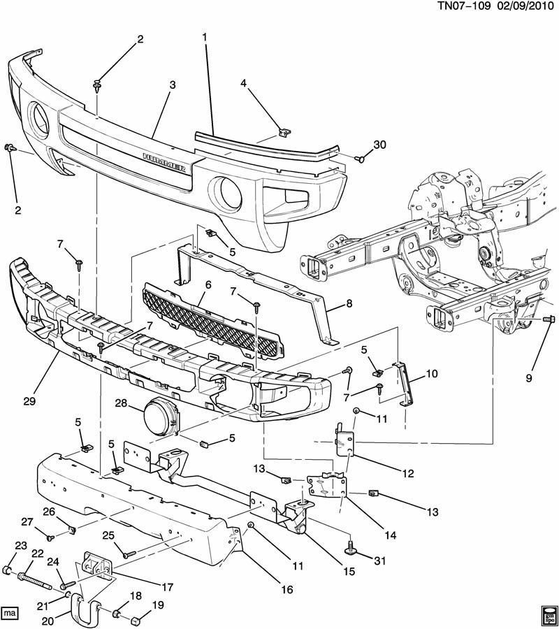

The center part of the bumper, #16 the metal box is an bumper impact bar and they used one part for the 2006-07, and a different one for 2008+. You will likely also need the bumper filler #29 as they get broke easy and provide the support for the cover and brackets etc.. The filler is all plastic, widely available for about $200, the bumper impact bar, NOT. Look on ebay, they are available used for less.

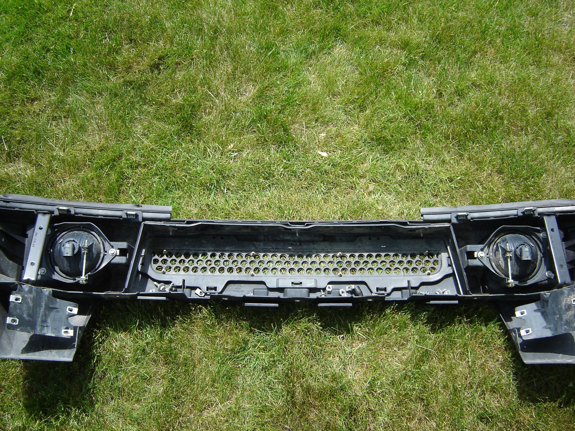

This is the inside of my old 07 bumper to give you an idea, just a bunch of clips and small bolts holding it all together.

if it is just surface rust just grind it and paint it.

I repainted mine and this is a perfect match. You want the 'Aluminum' version.

Perfect. Could I get away with not take the bumper off, dealing with the rust and the paint or does it have to come off?
thanks everyone for your help. It’s much appreciated.
Old Dec 16, 2021 | 02:52 PM
Broken Halo's Avatar
Posts: 1,461
As Doc said, it's not difficult, just a pain in the *** to have to do if your only concern is paint touch up. Mine starting to show rust in the exact same area as yours. I've had the bumper assembly apart so I know how to do it, I just didn't want to go thru the hassle for some touch up. Mask off the area and sand or wire brush and use the recommended paint. True, you won't be able to get the rust behind the plastic trim but it will look good enough that you'll be happy with the results.
