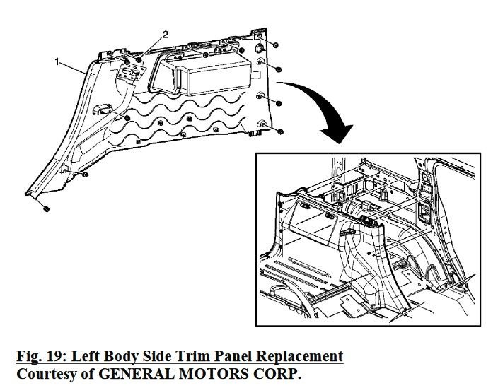

It is expected to rain again tomorrow in LA, and need to fix this fast.
Water, quite a bit, was found on the speaker cover in the cargo area of the driver's side. Saw no evidence of water on the headliner.
Could not find a source of where this water is coming from.
Pulled the back seats up and the rug is wet as well. So getting that wonderful moldy smell in the car now.
Last time this happened, years ago, the stealership fixed it, so clueless how I can go about fixing this asap.
Looked around, but unsure on what steps to take.
Please advise.
Thanks!

Pull the inner panel, spray water on the outside and check inside for water intrusion source.
More info here:::>>> Rear fender clips leaking into rear cargo area

Inner panel?
Headliner?
Or the rear inner panels in the cargo area?
