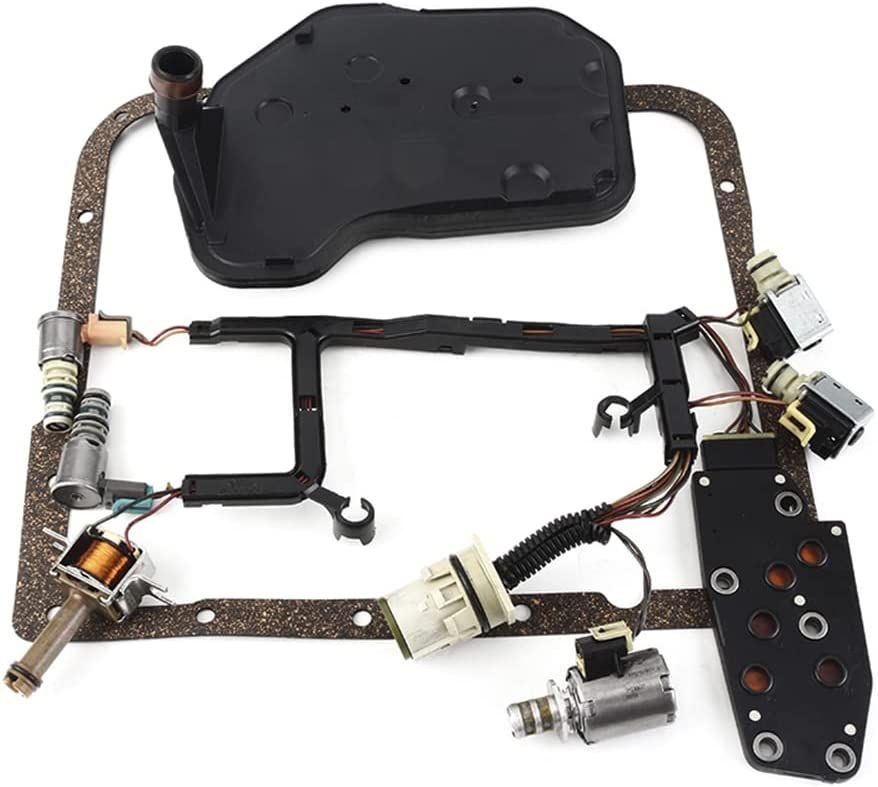

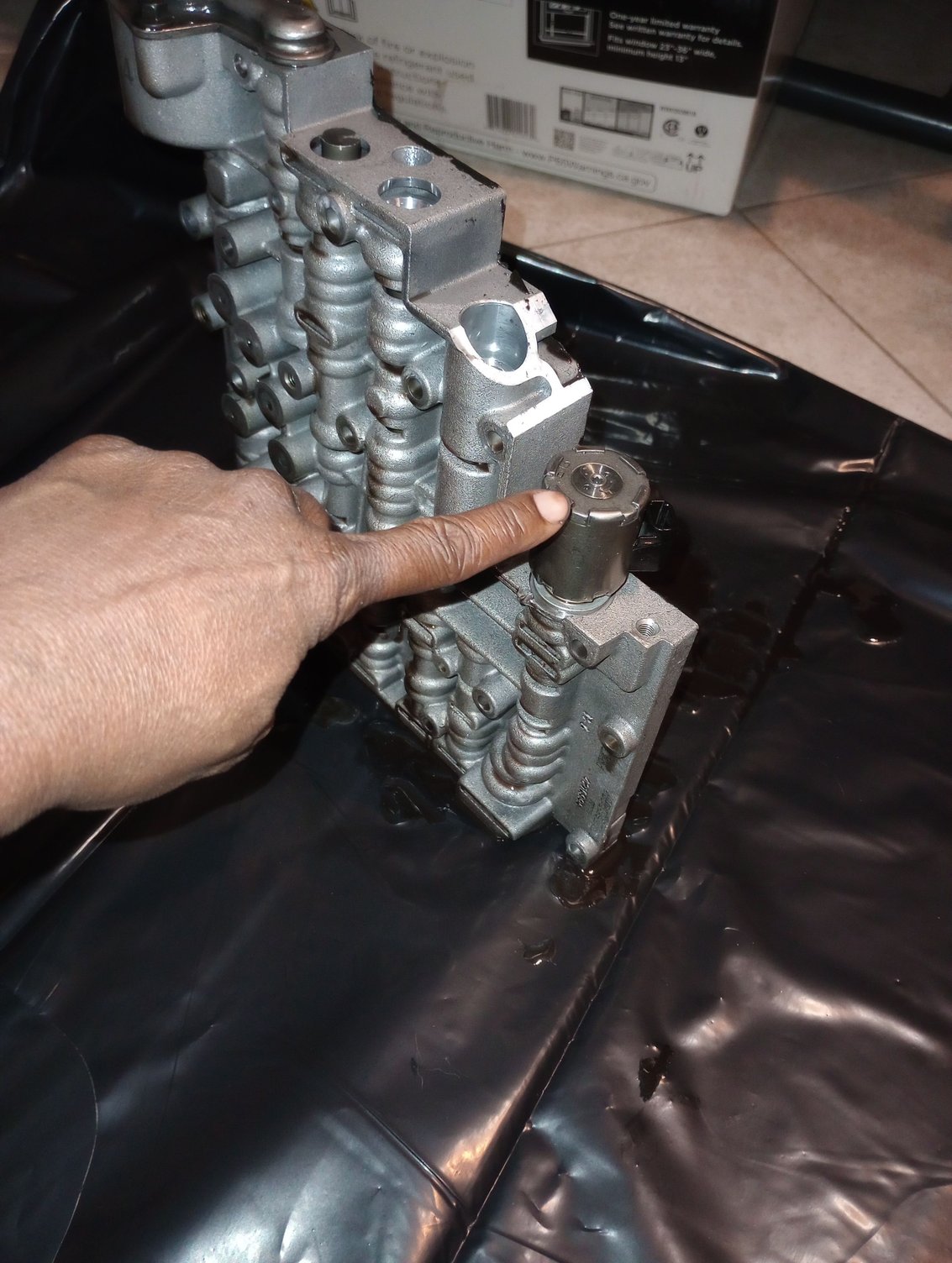

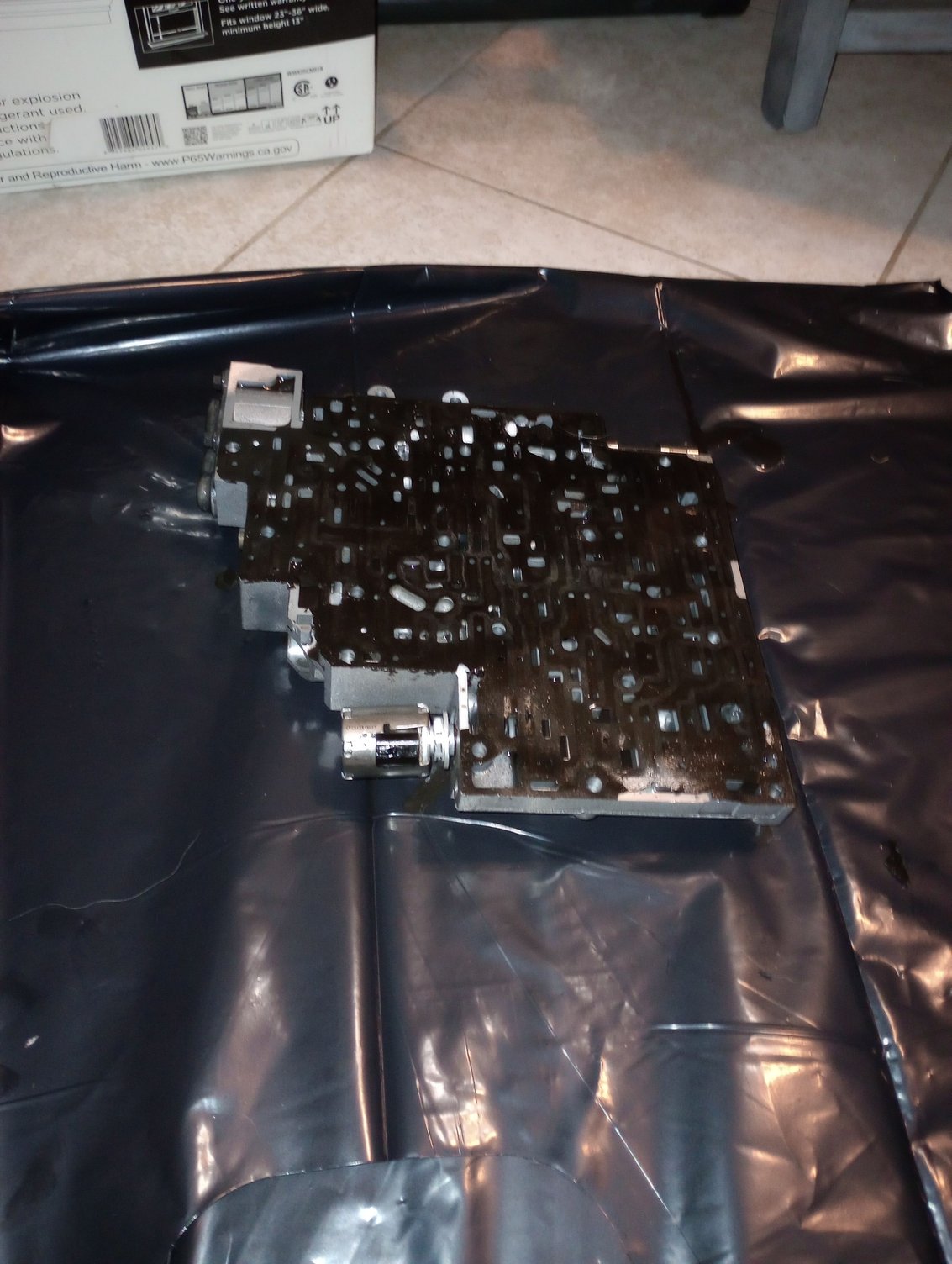

I know that now. I didn't before. I'm a girllll 😂 lol Update November 23, 2022.
1 My transmission valve body gasket was crumbling & particles are in the valve.
2 Valve body is cracked
3 The shift 1-2, 2-3 shift solenoids we're bad
4 The TCC/PWM was bad.
5 The Pressure control solenoid is stuck in the valve body.
6 Transmission fluid was black. My check ***** are missing 😬
Soooooooo: A New transmission is loading!

I was been supposed to update.
Update December 13, 2022 & the end of my problems, Yay!
It's fixed & running great!
New: MAP, MAF, Camshaft position (intake & exhaust), Crankshaft, 1-2 shift solenoid, 2-3 shift solenoid, 3-2 shift solenoid, EPC/PCS solenoid, TCC lock up solenoid, TCC pulse w/mod solenoid, Transmission & motor oils with new filters, & VVT solenoid.
I WANTED to do ALL of this! I could've just fixed my main problems 🤷🏻‍♀️( changing oils & replace the crankshaft sensor) drive for 100 miles & be back on this forum🙄 but nope! I'd rather fix it ahead of time. It took me some time but I fixed my OWN truck💪🏻
