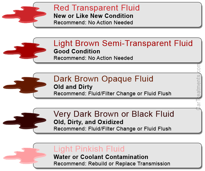

Old Oct 31, 2022 | 10:25 AM
Welcome to HF. The HF Help & Suggestion Center is for asking questions about how to use forum features, not for anything to do with vehicles.
How many miles on the H3? I would check the Trans Fluid Level and Quality using a white paper towel to wipr off the dip stick.

if the rpms are high but the truck is slow then your transmission might be slipping. check the transmission fluid level.
I will try checking the transmission fluid now. I'll flush it too.
I have 196,506 sorry I thought it was 158,000. And I'm about to do what you suggested.
