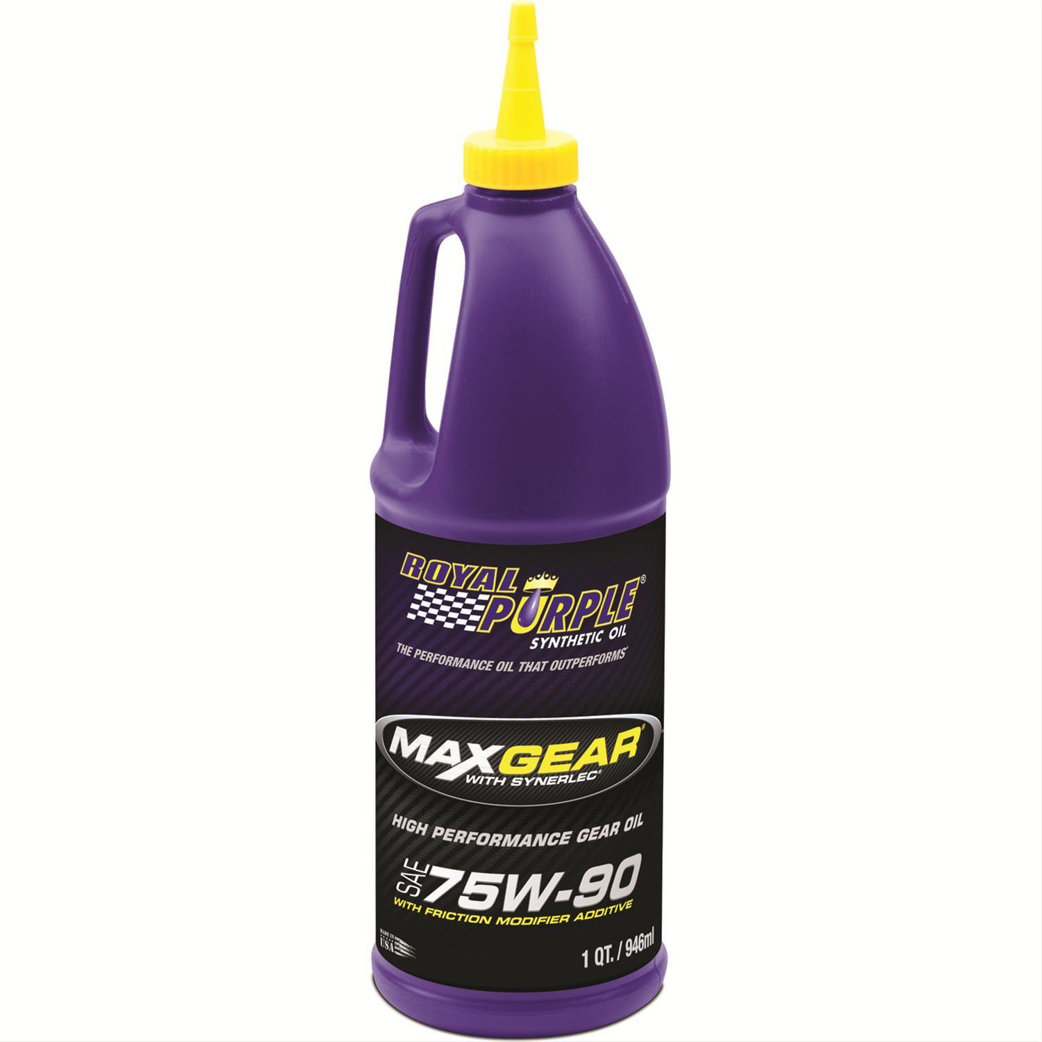

When was the last time you replaced the rear differential fluid?

Btw, you may need to pull the sensor and clean that too. GL
I tried to pull my dsr oem sensor last year and it broke, however you stated that the rears sensors are new.

You have an intermittent issue that could be caused by debris floating around in the rear axle, causing a signal loss to the LEFT REAR sensor. Start by changing the fluid!
Sorry, as this could not be caused by front brake pad replacement.
