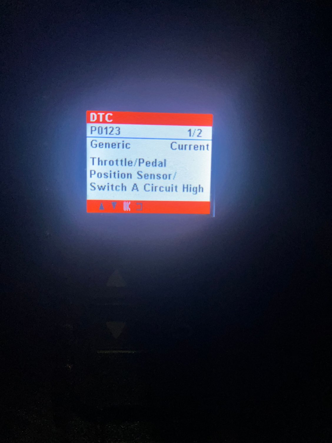

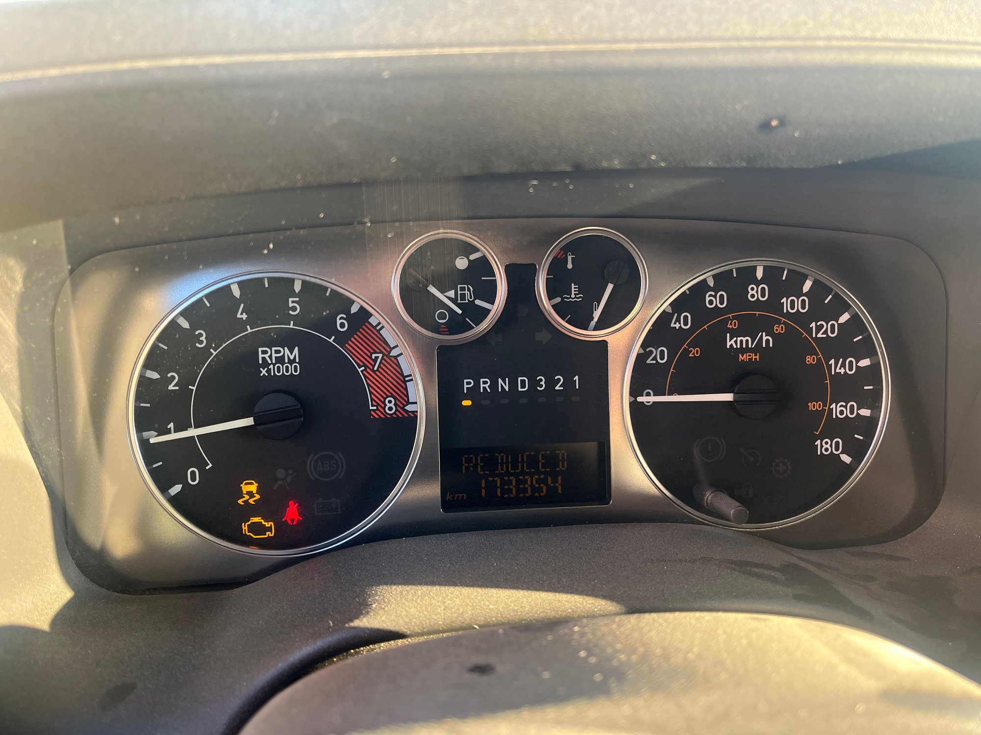

Recently have run into power reduced mode issues with my 2006 H3. I started by checking all the contacts on all the relays, fuses, and wiring harness connections. They are clean. I switched relays around and no change. Randomly had number 5 cylinder misfiring. Replaced a coil and that fixed that. Still in reduced power mode I found a broken wire to the throttle body and repaired it. That definitely helped it run smoother again but I am still in power reduced mode. I clear the codes and it is an active code always. I currently only have code P0123 Throttle / Pedal position sensor / switch A circuit high. It is running smooth on all 5 cylinders too. I changed out my original pedal yesterday for a new one and no change. I have opened up all the wiring harness on top of the engine and wiggled wires all day yesterday. No change.

Cleaned throttle body. Did re learn process and code P0123 has been active the whole time. Can not clear code as it’s active. New throttle body?
