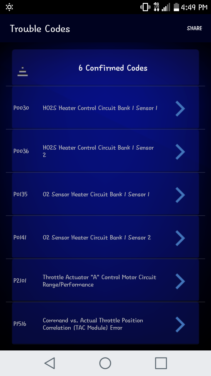

At first the truck would start and die after a few seconds. I pulled the codesshown above as 6 confirmed codes. I then replaced the oxygen sensors and throttle body and the truck starts and runs but it shows a reduced powed on the message center between the gauges. The truck wont rev over 2000rpm on idle or driving. I replaced the pcm after that and still am having the same issues with this truck. Im kinda stumped does anyone know what this could be?

Second pic is codes after replaceing parts
