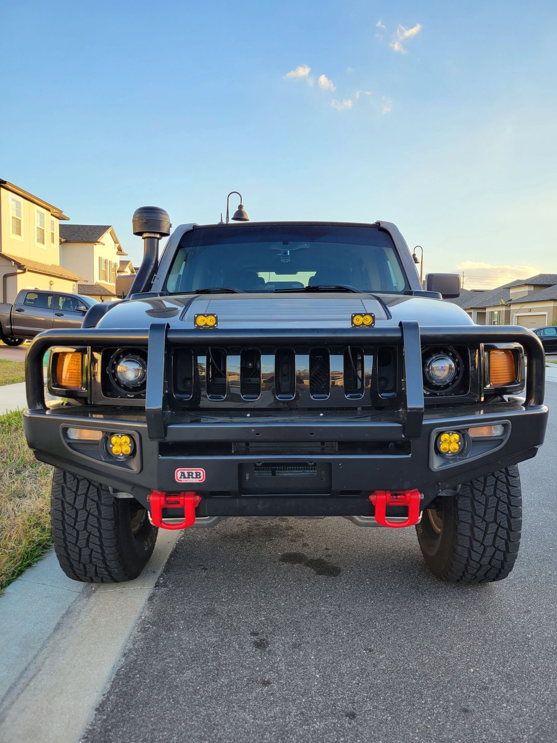

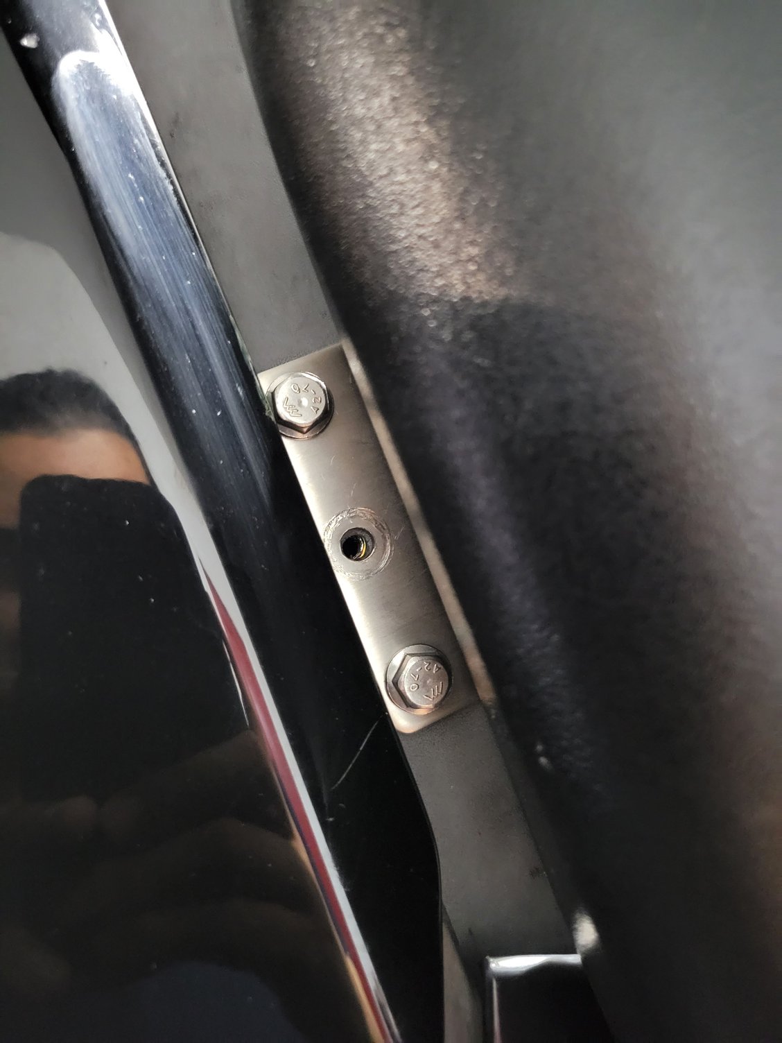

Added one of the first batch of lased designs metal brackets for the headlights, changed set up to morimoto super7 2.0

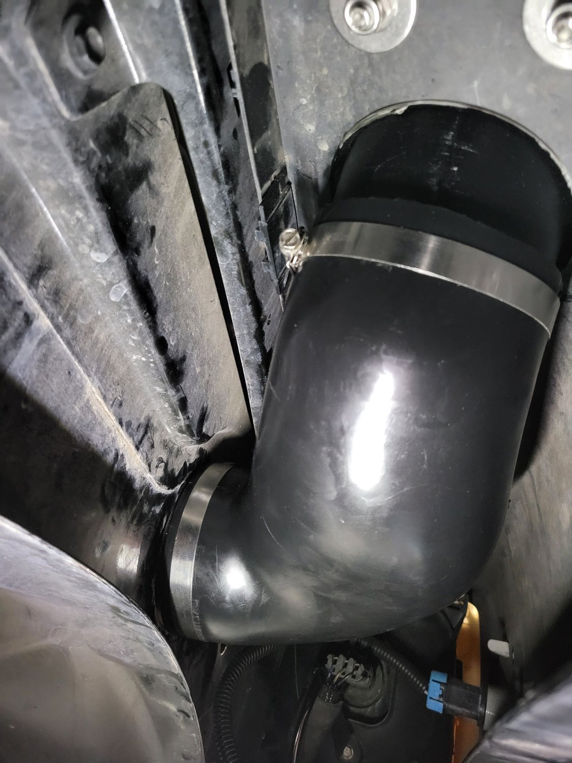

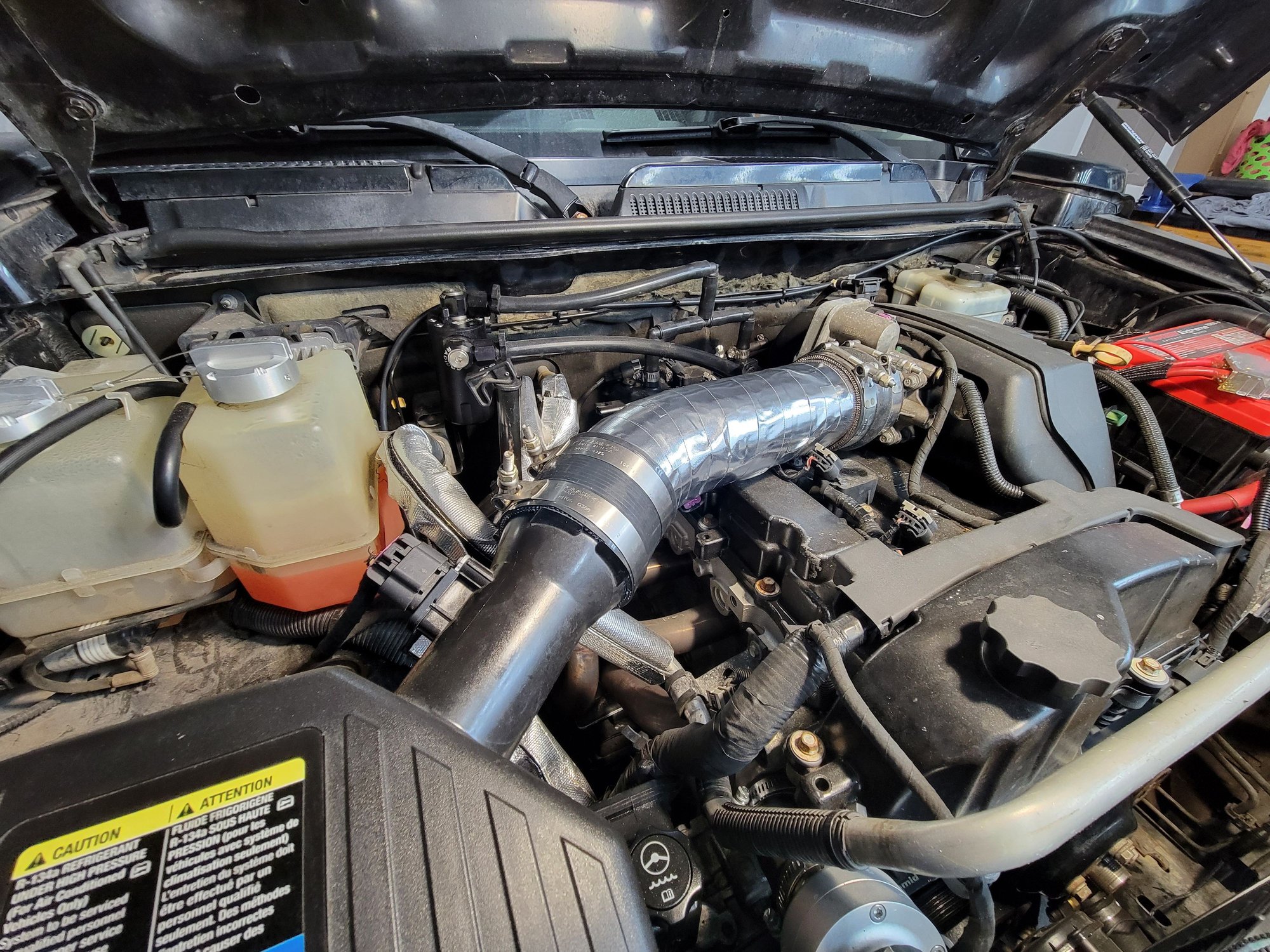

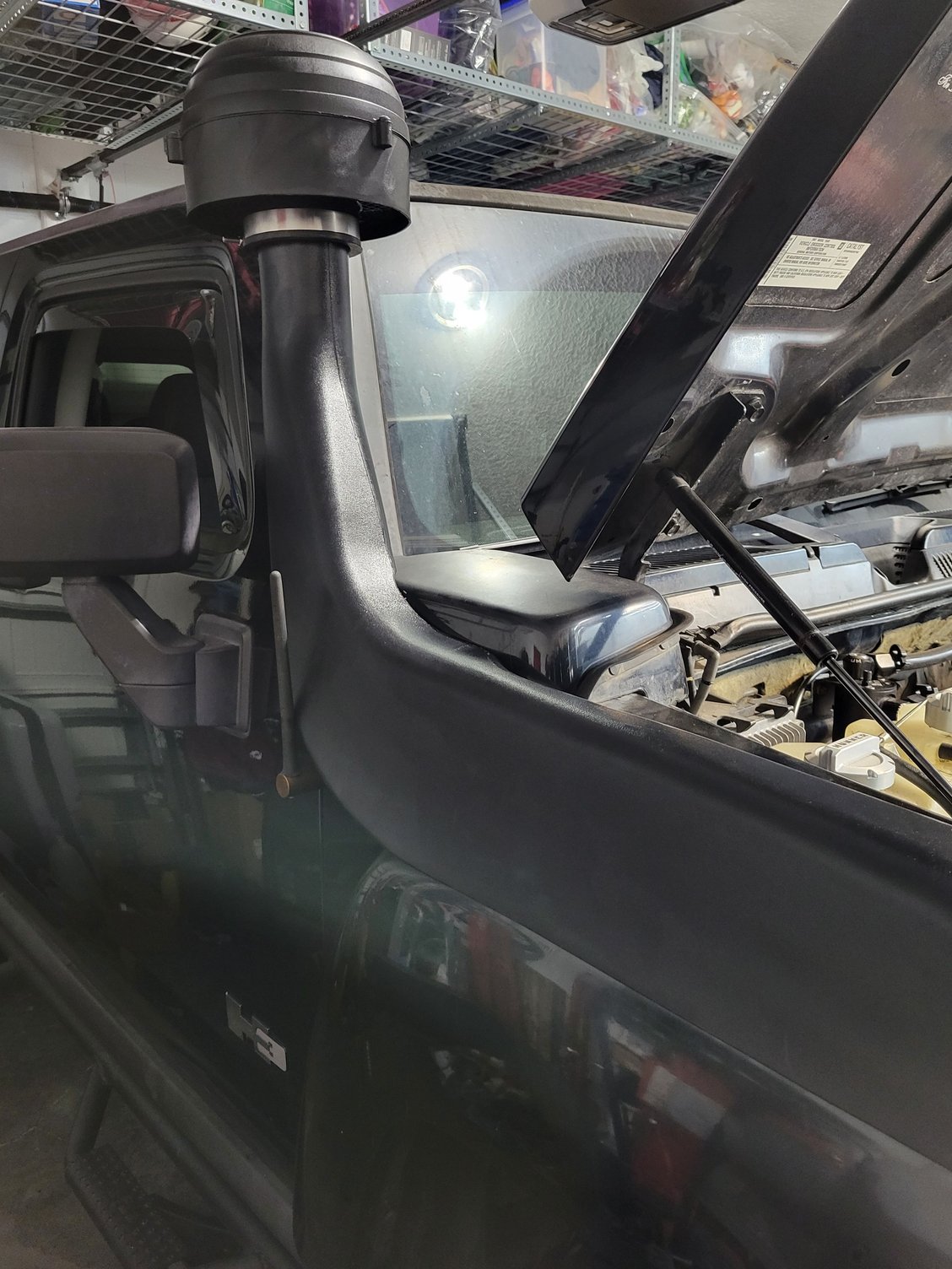

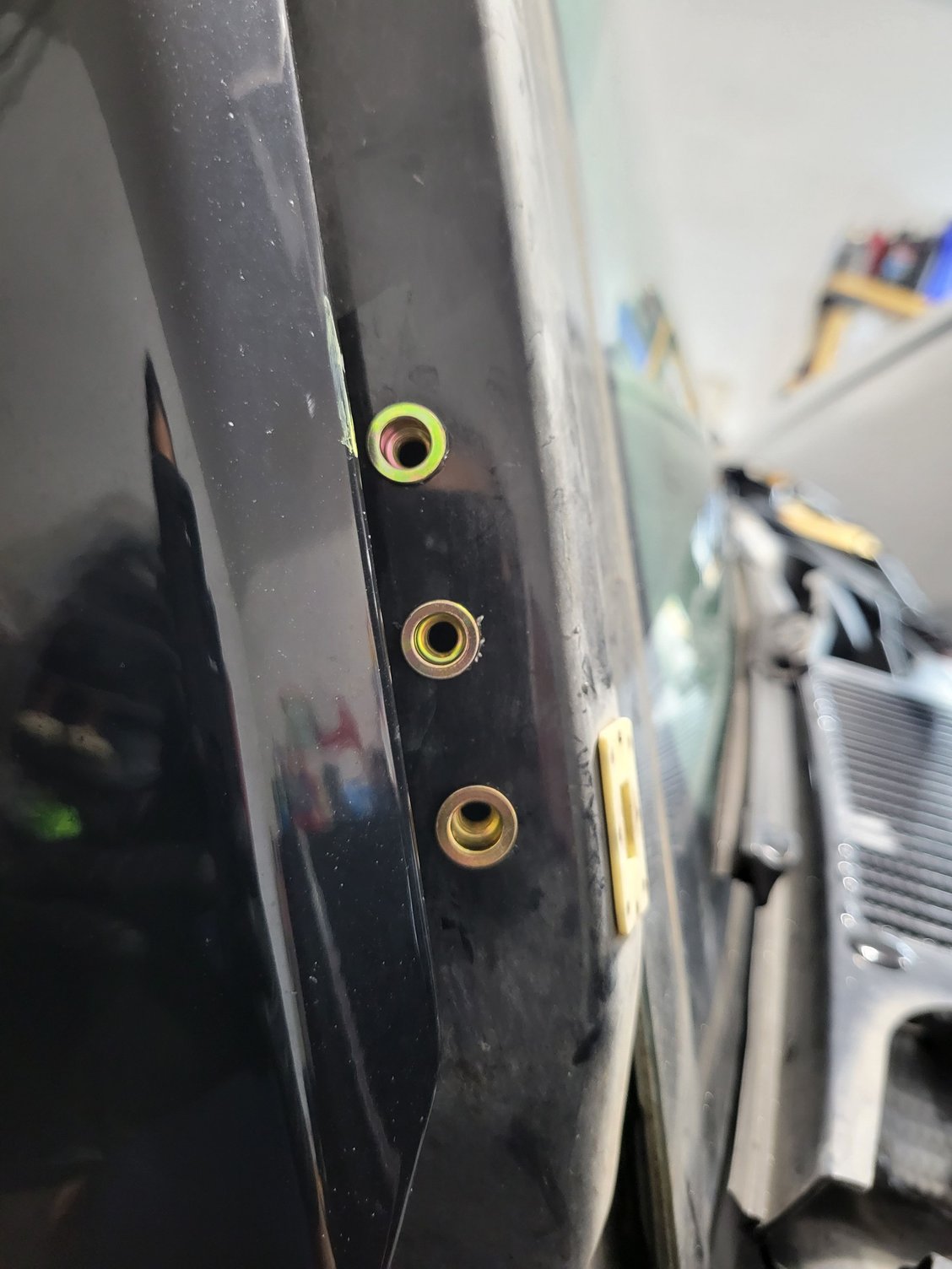

Finally put my snorkel on and precleaner after sitting a while, gonna do the steering rack and torsion bars this weekend along with a high flow magnaflow rear cat, I'm getting rid of the test pipe to quite it down a bit. Instead of using rivets for the mounting of the snorkel I used rivet nuts and m6 bolts that way I can remove if need be to work on it if it's in the way. I did mess up the middle one so I have to redo.
also wrapped the airdoc intake with dei heat reflective tape.

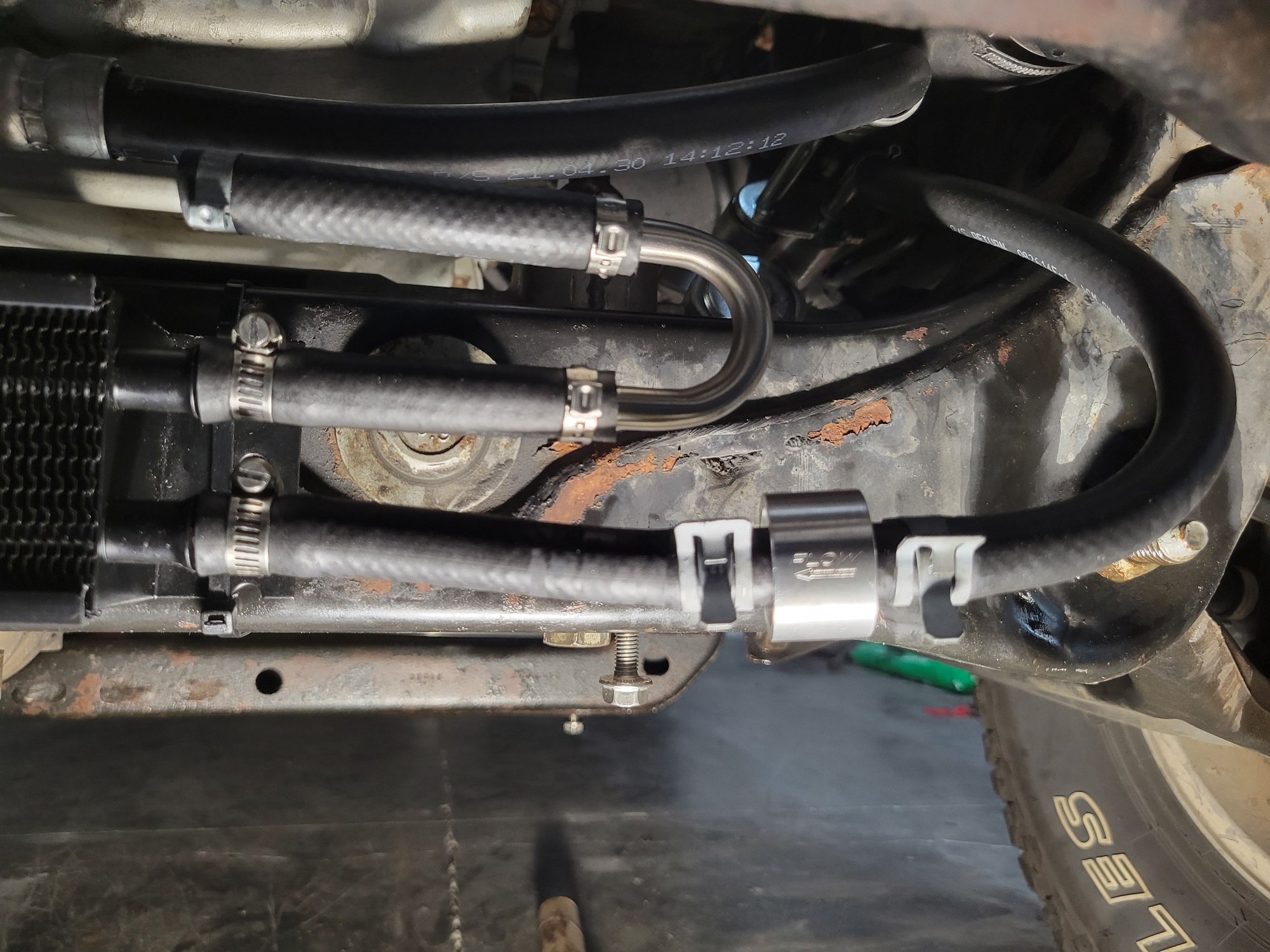

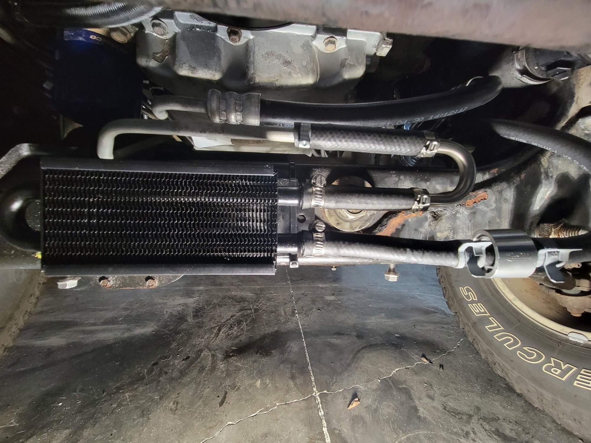

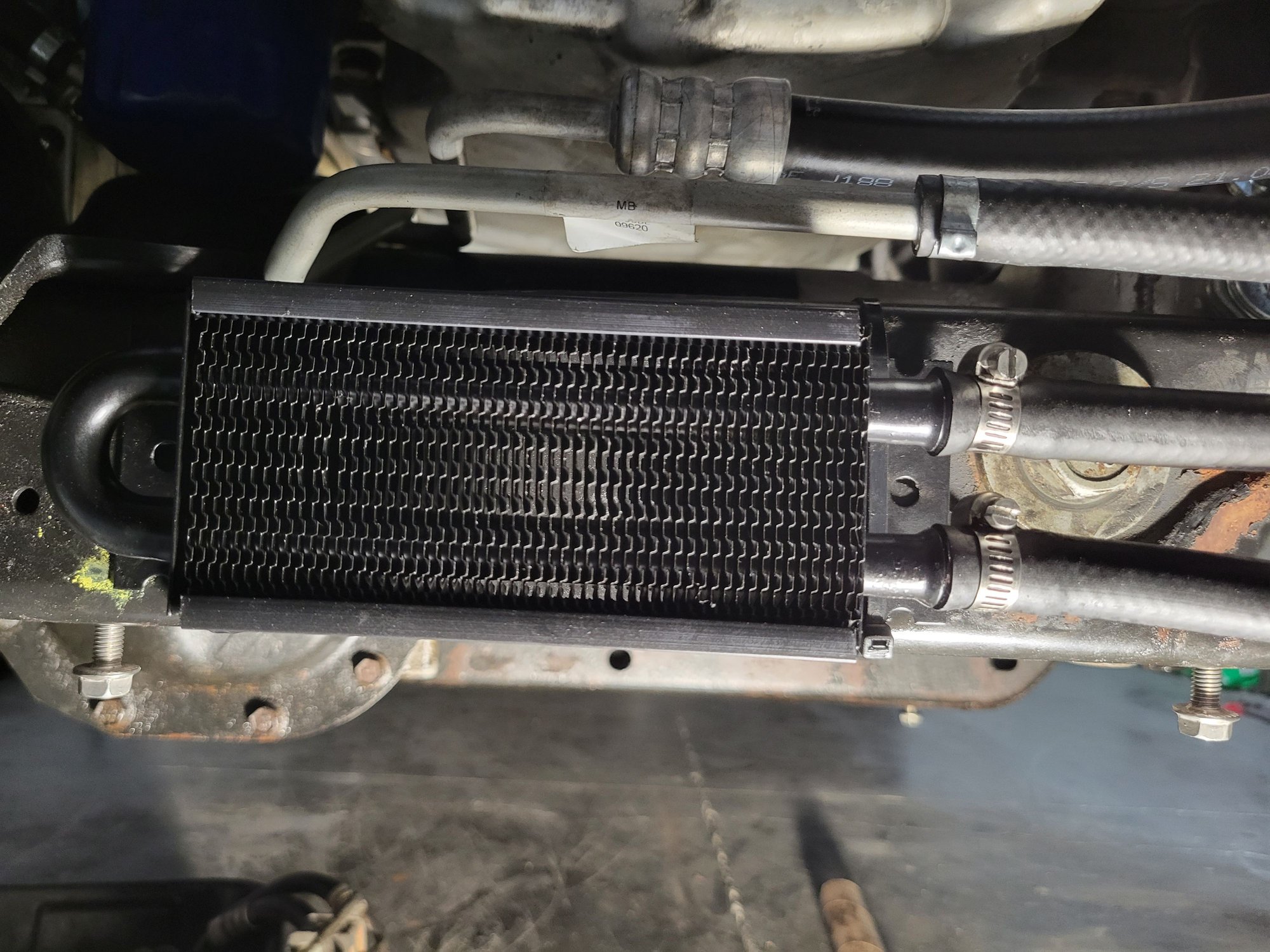

thanks Doc much appreciated. My h3 never came with the factory cooler, so i made a kit with oem parts and a serviceable inline filter.

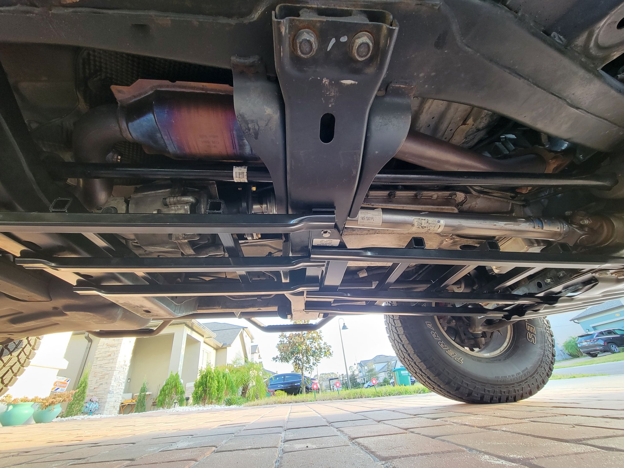

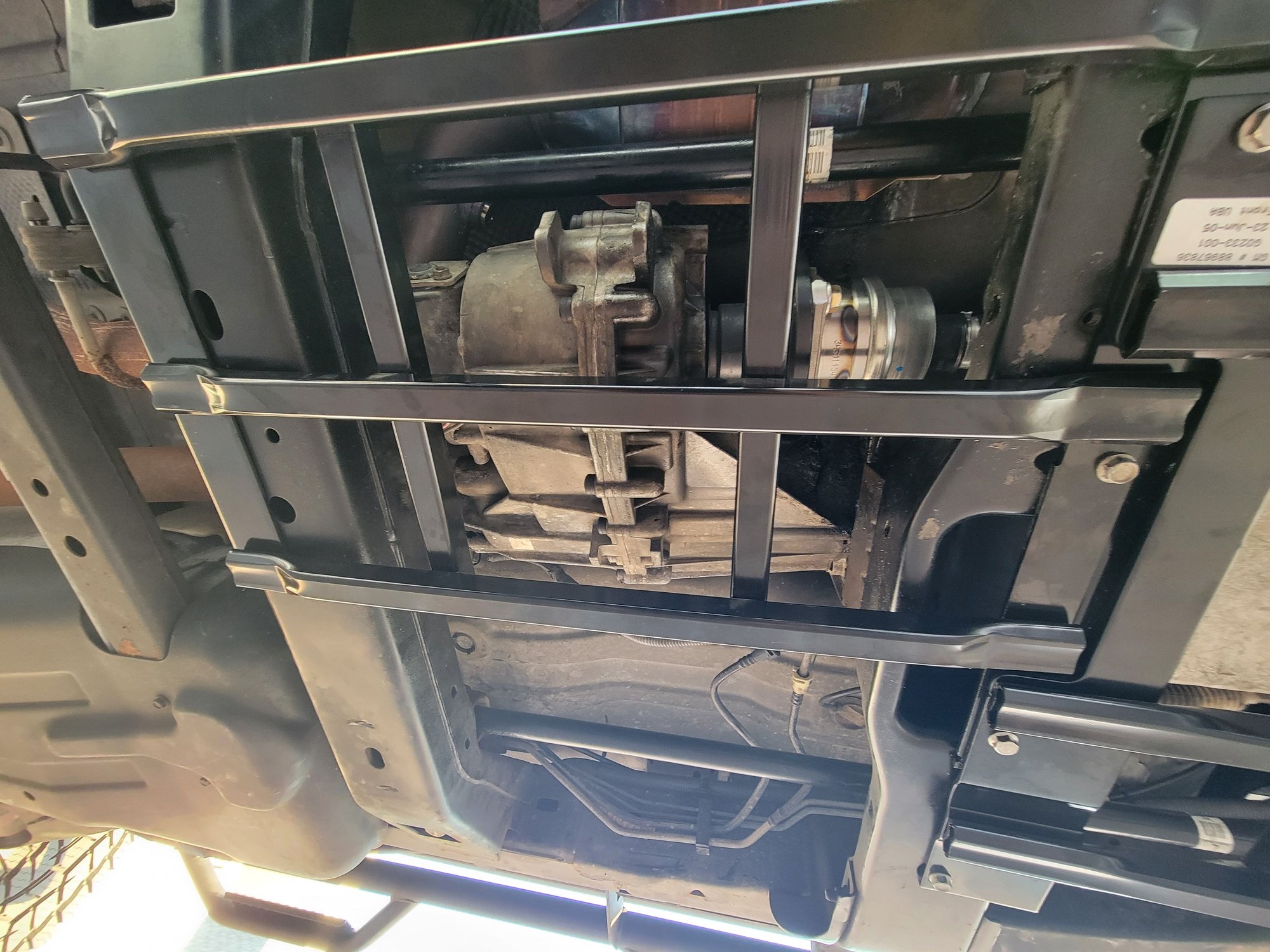

Finally got a chance to install the rare OEM UCP, even though I have a differential drop, bolted up just fine.
