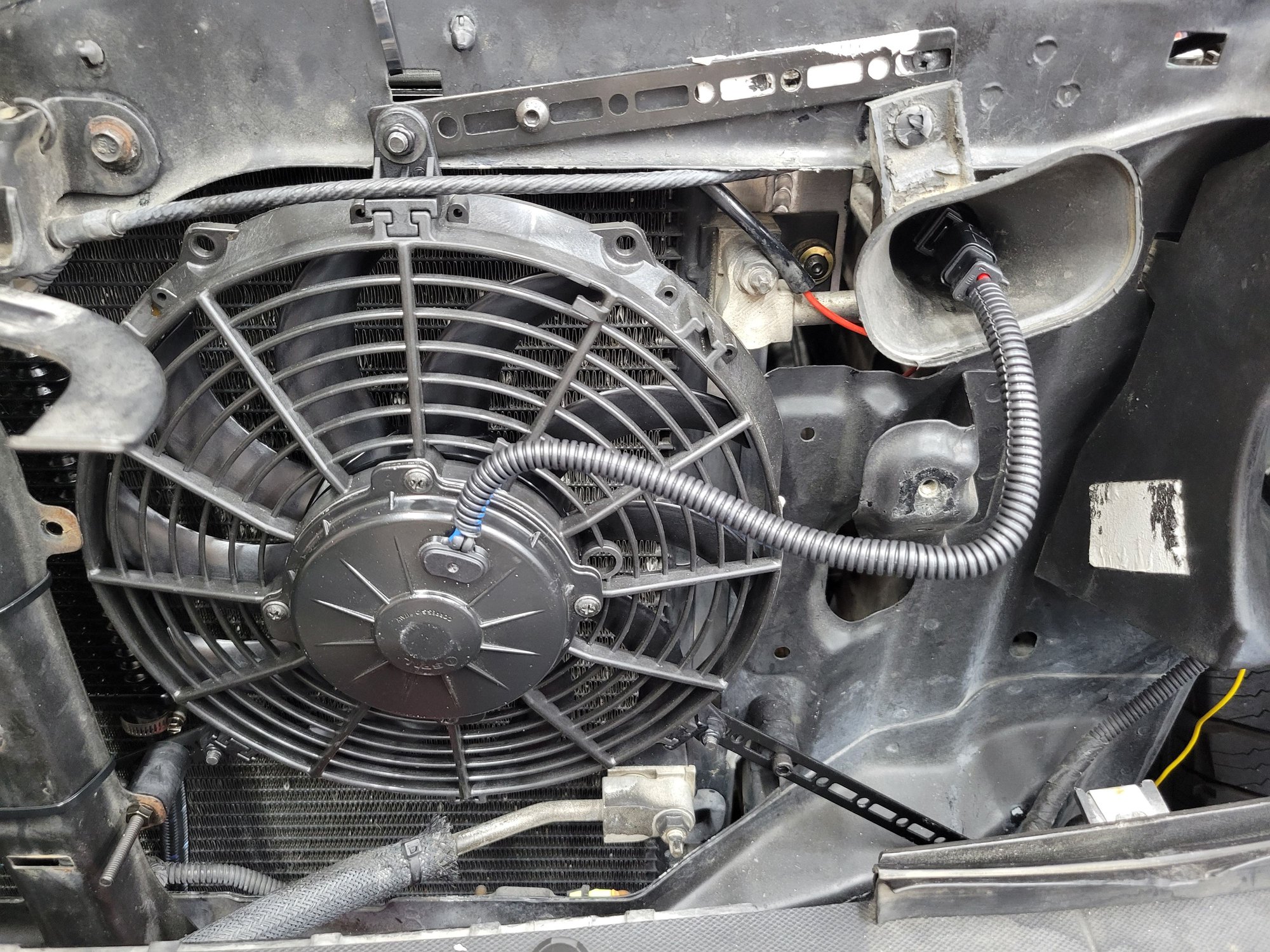

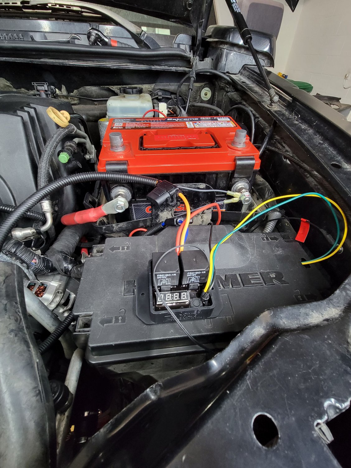

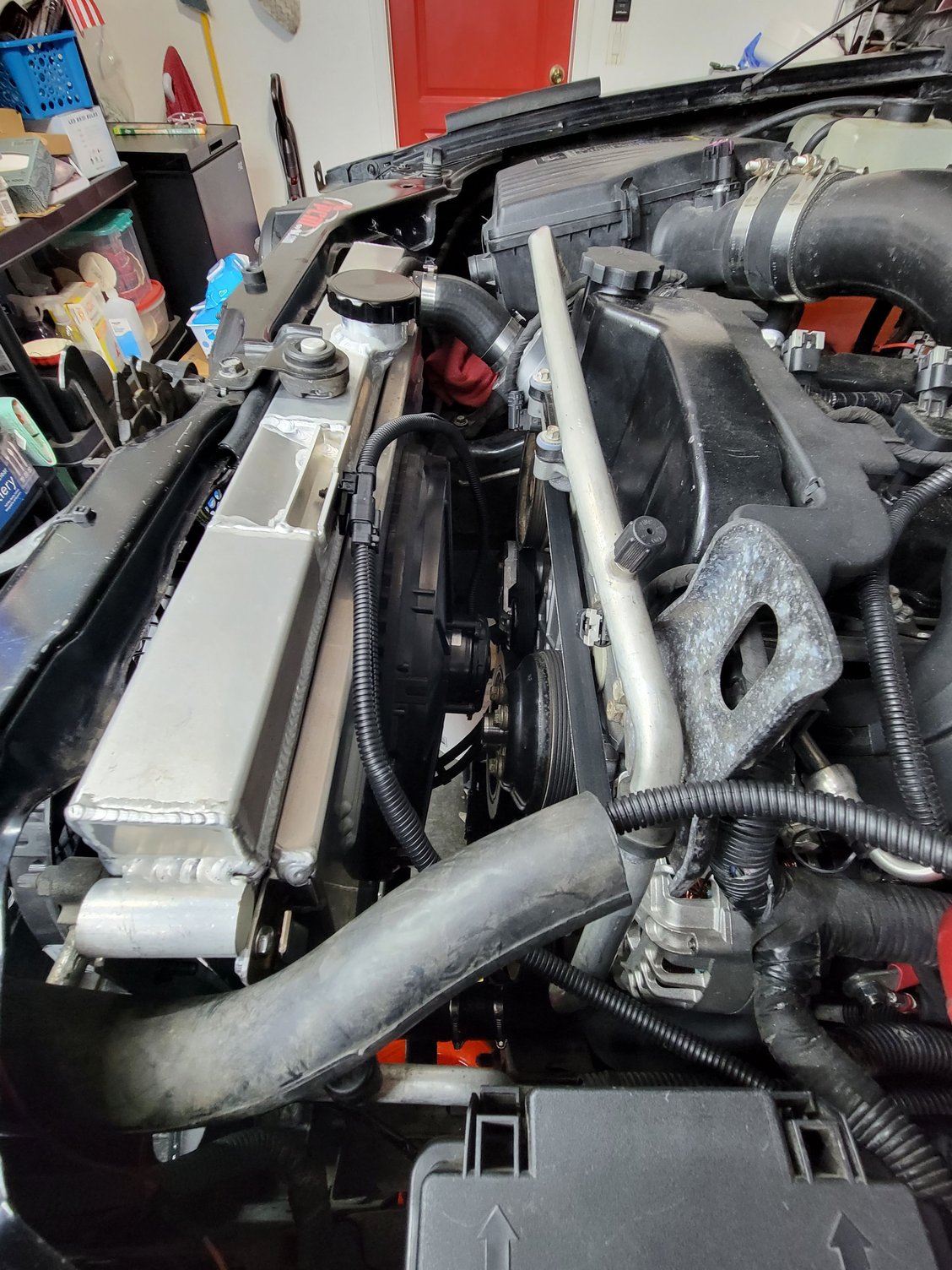

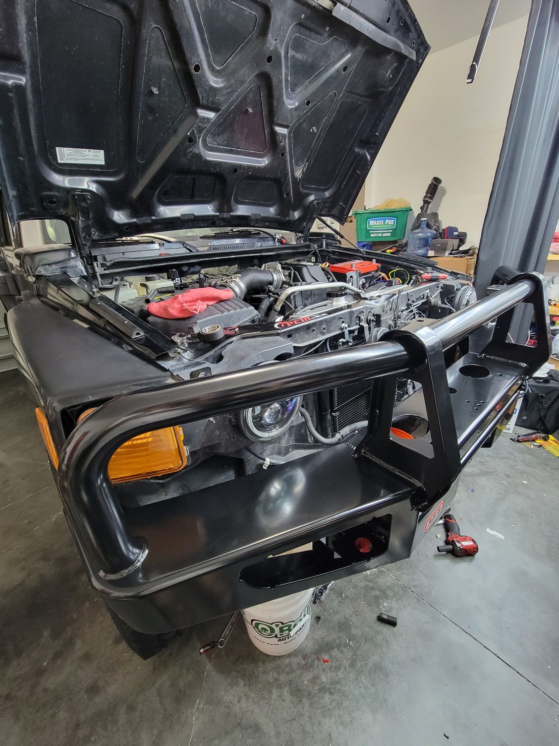

Relocated the fan controller to better spot more visible and near the battery.
mocked up of how it should look like behind the grille.

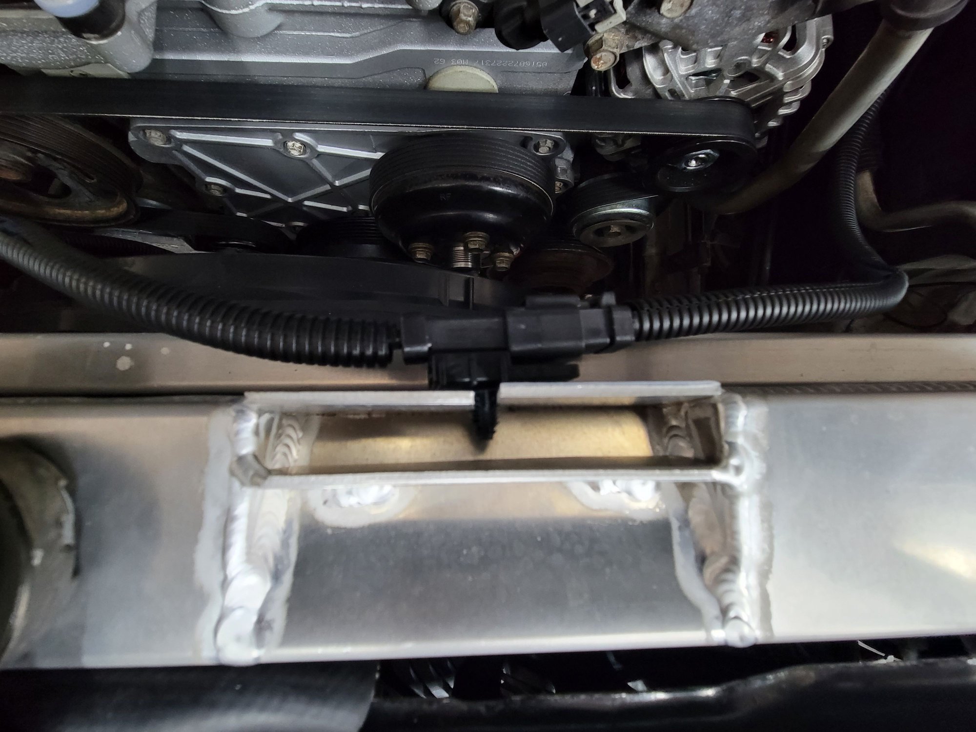

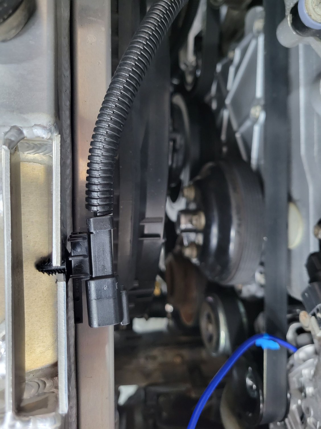

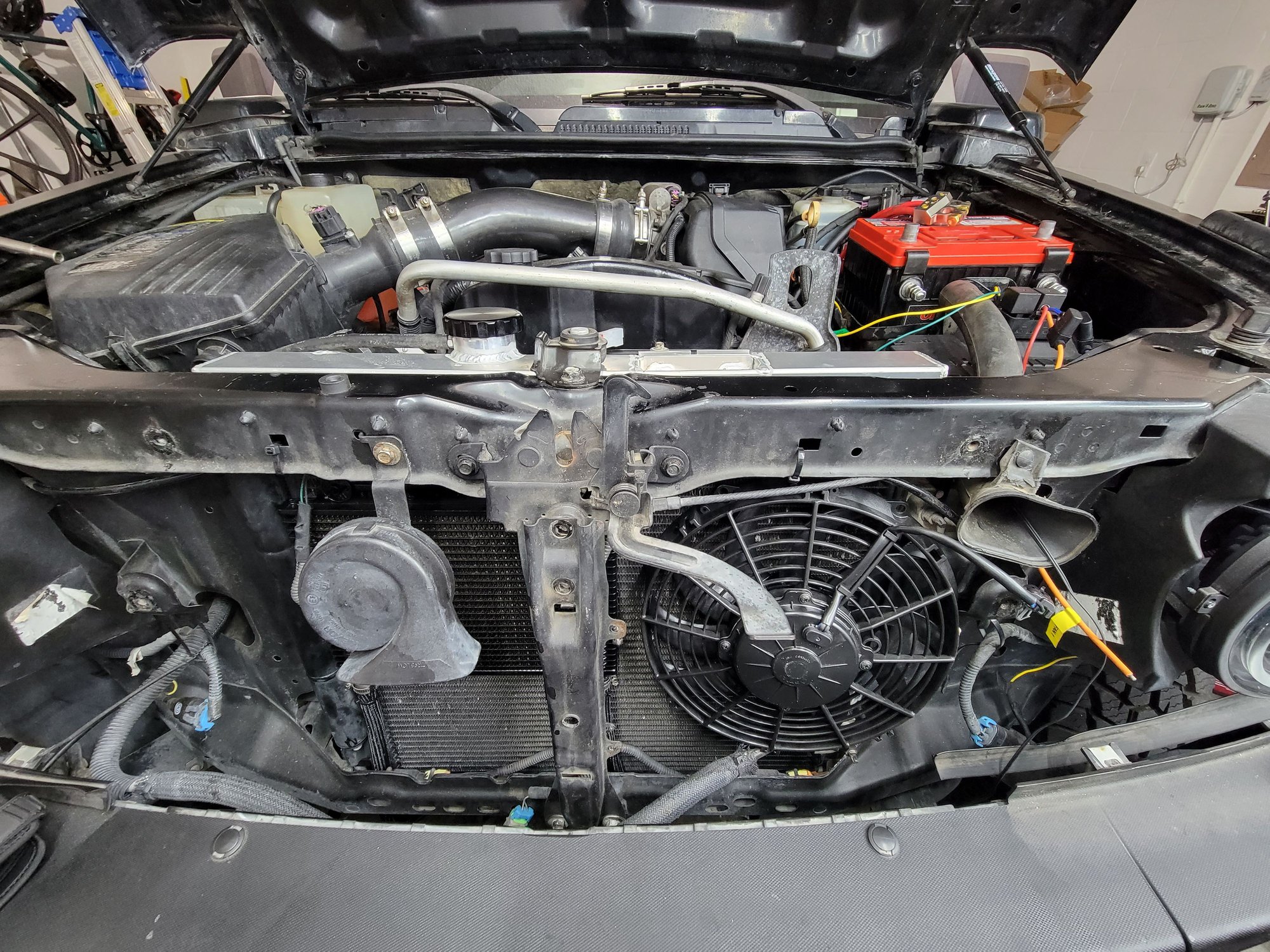

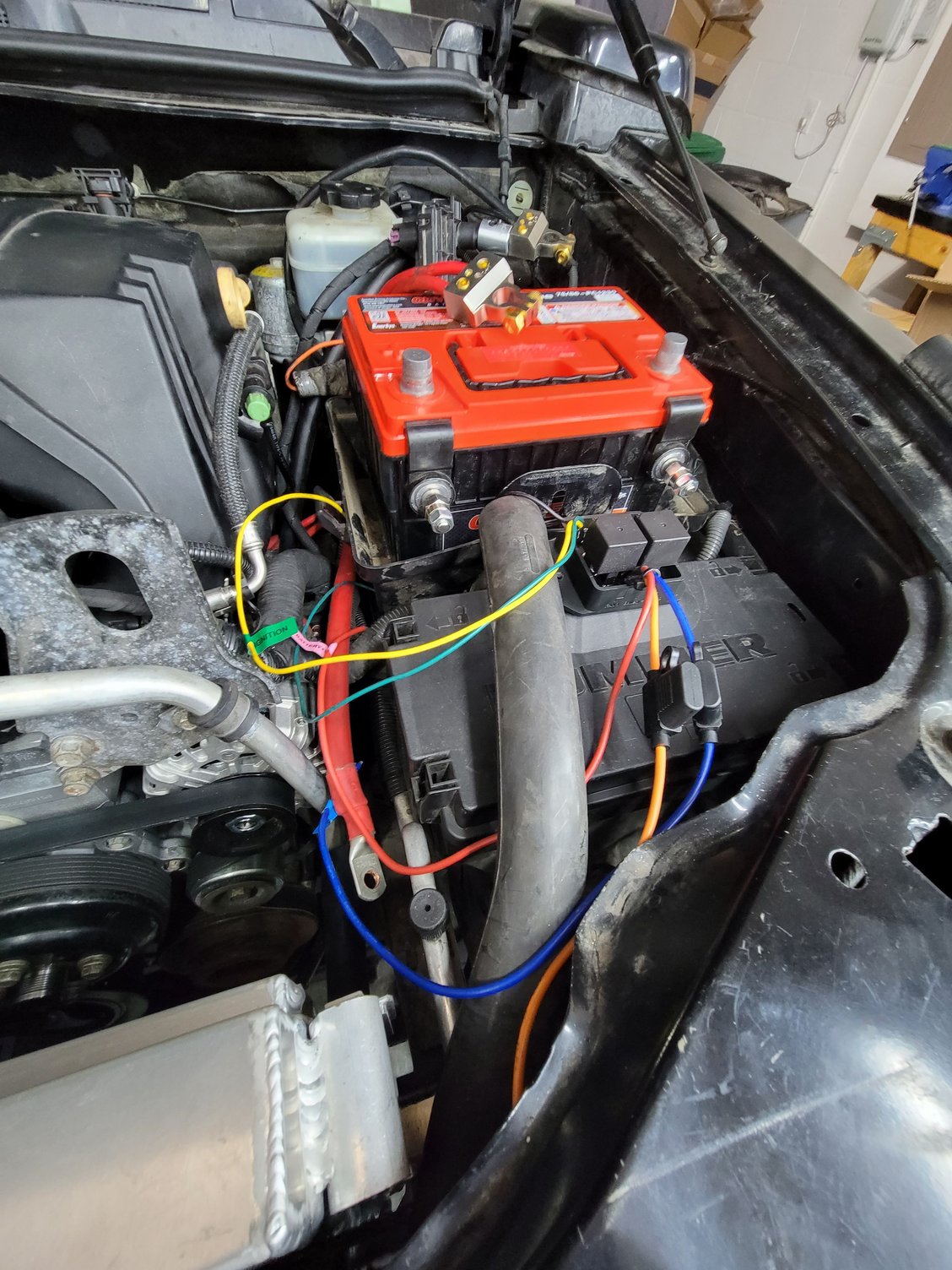

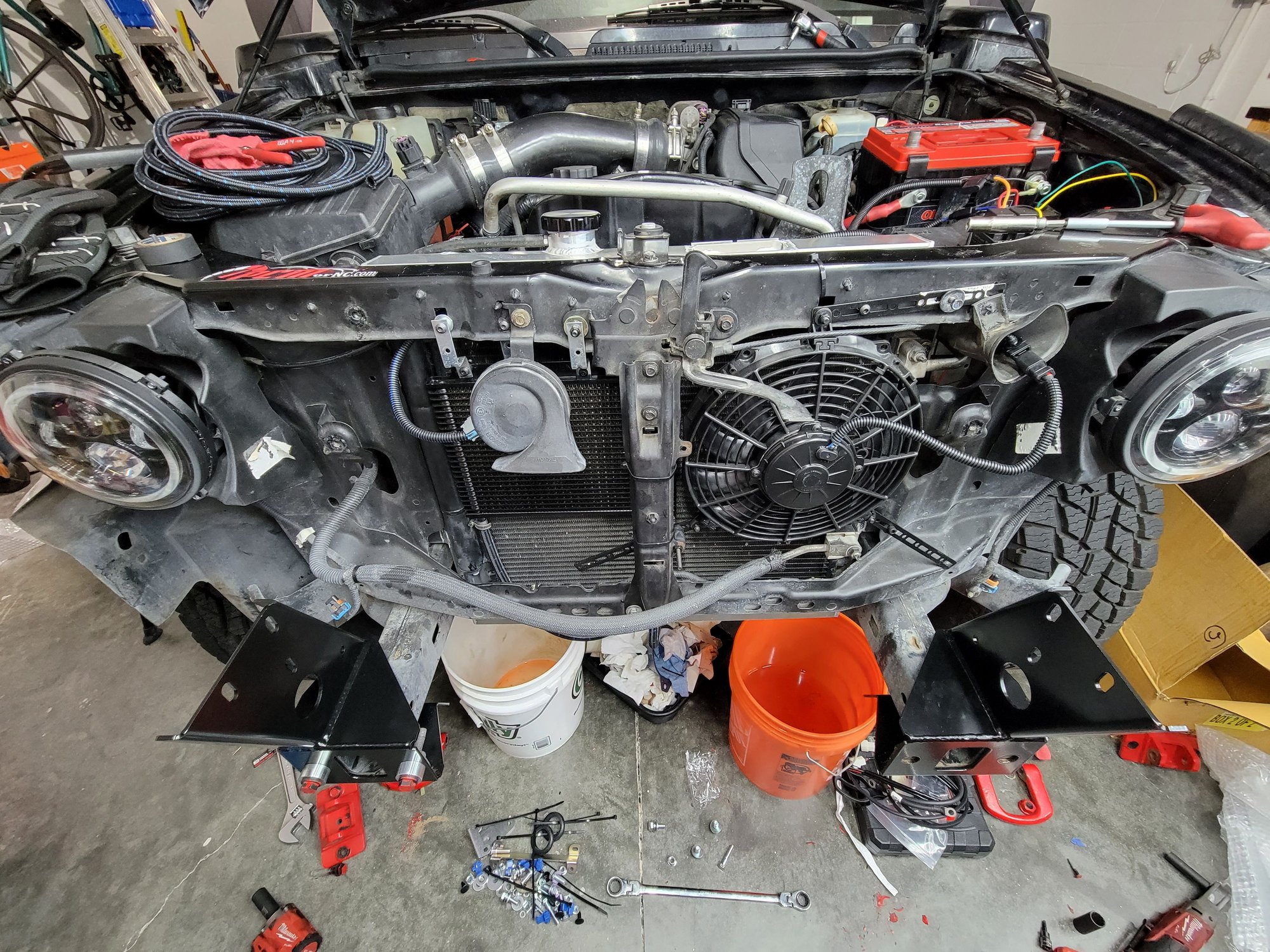

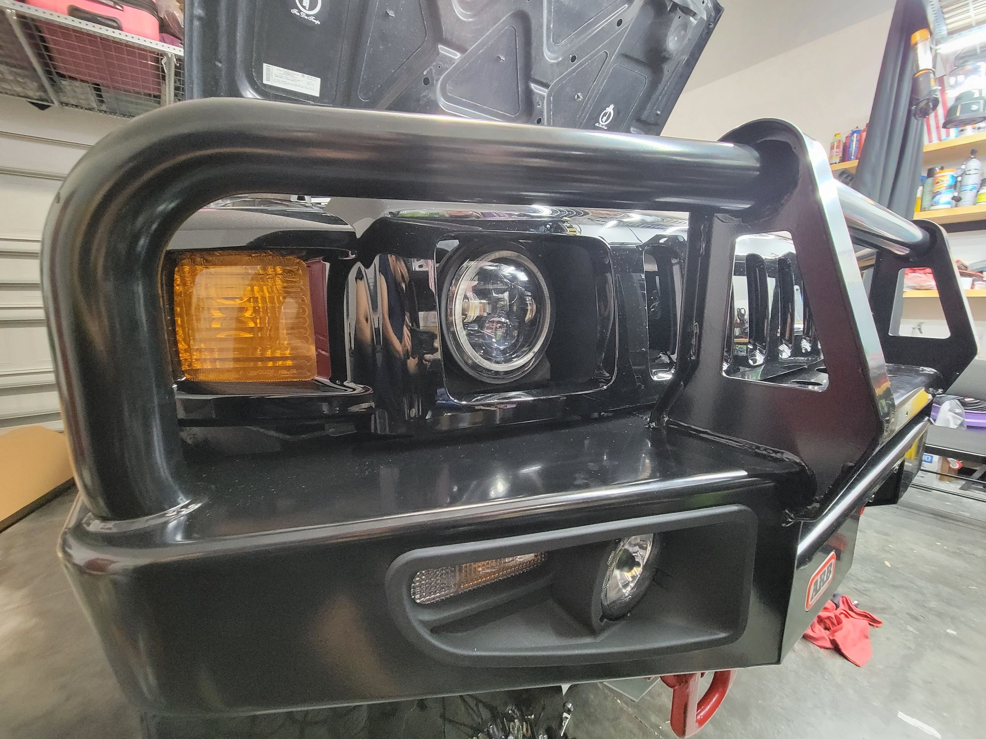

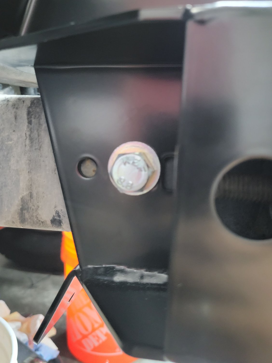

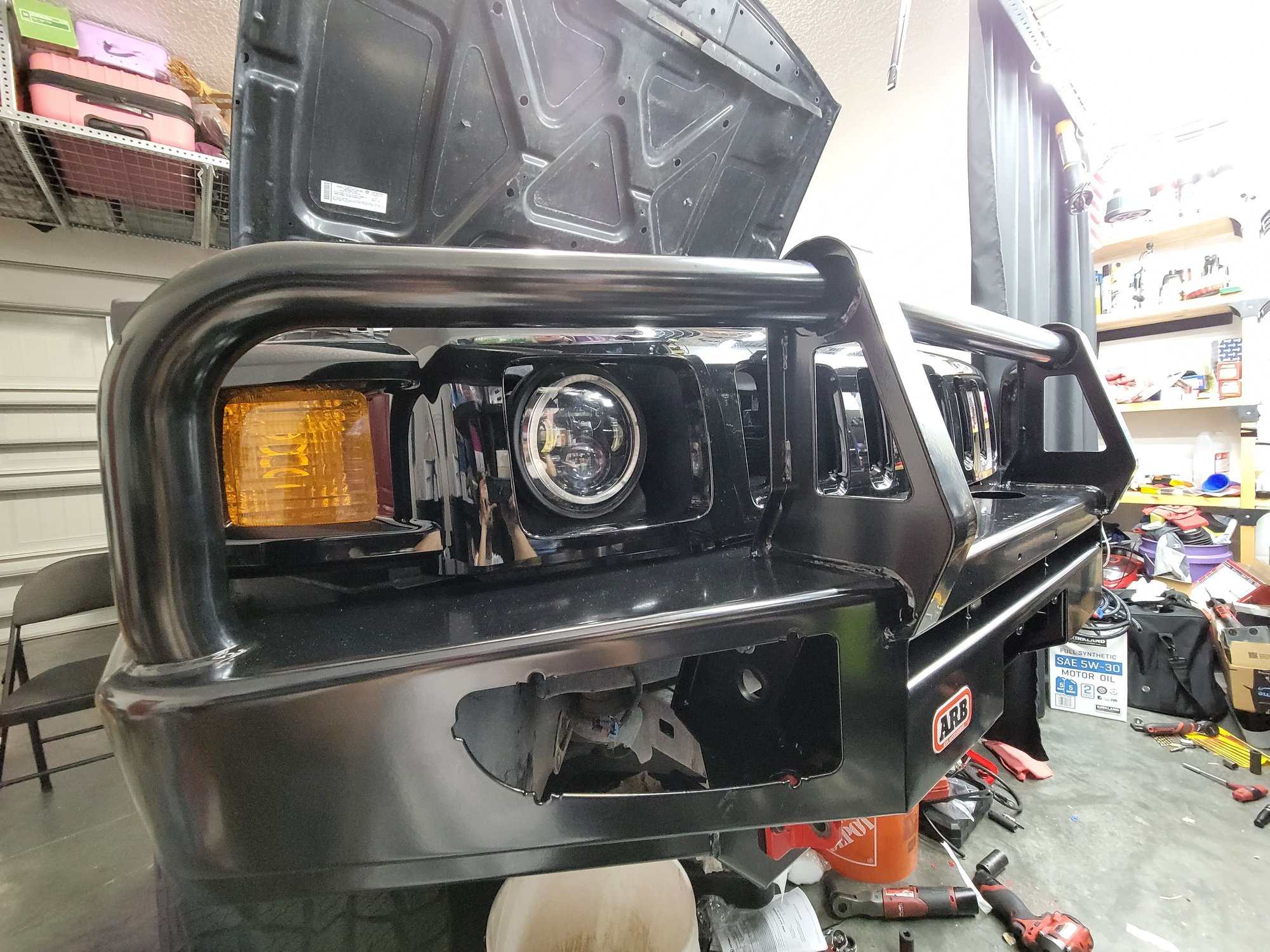

Cleaned up the harness and mounted the fan with dtp connector. Wired up the controller and love the soft start between the fans. Reading is super accurate from the Thermostat kit.
everything is digital. Mounted the arb bumper as well. Still need to wire up the fogs and turn signals.

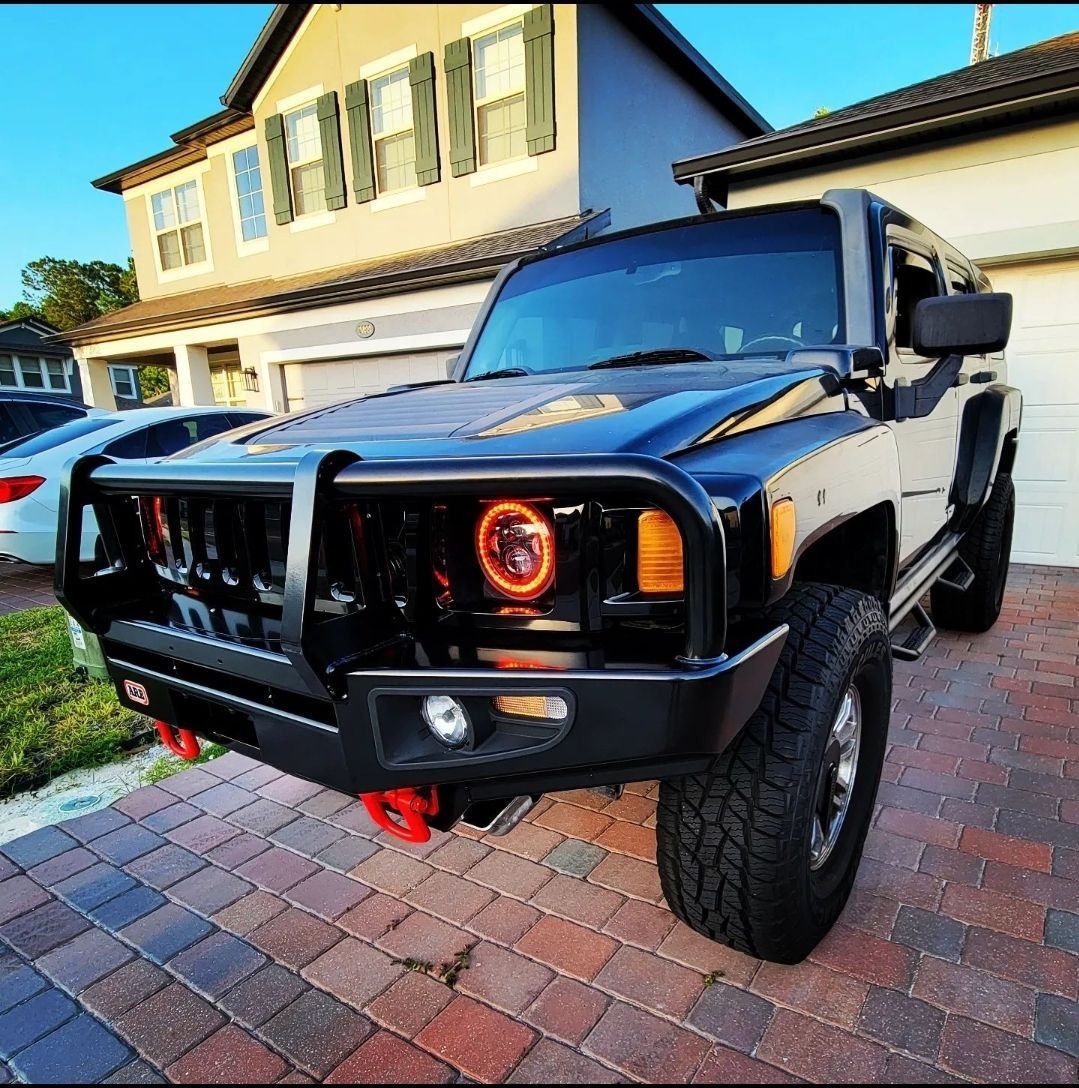

I will be replacing the headlights for morimoto projectors in the next month.

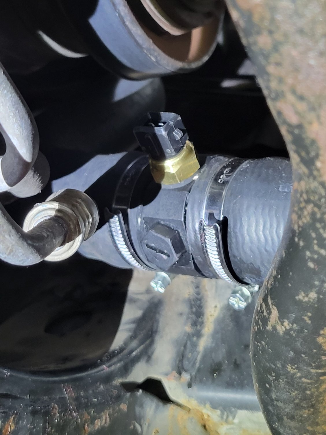

Was having issues with the jegs Thermostat, do I swapped out for a gates 160 degree Stat. Faster warmup times, and even when ac blasting I maintain an average temp of 180 ac blasting in 95 degree Florida weather.

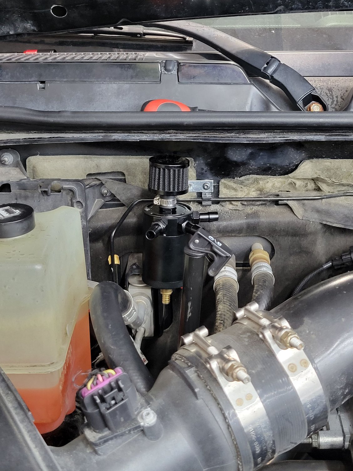

Nice! Those Arb Bumpers are sweat. Great work.
However, don't get me going on catch cans.

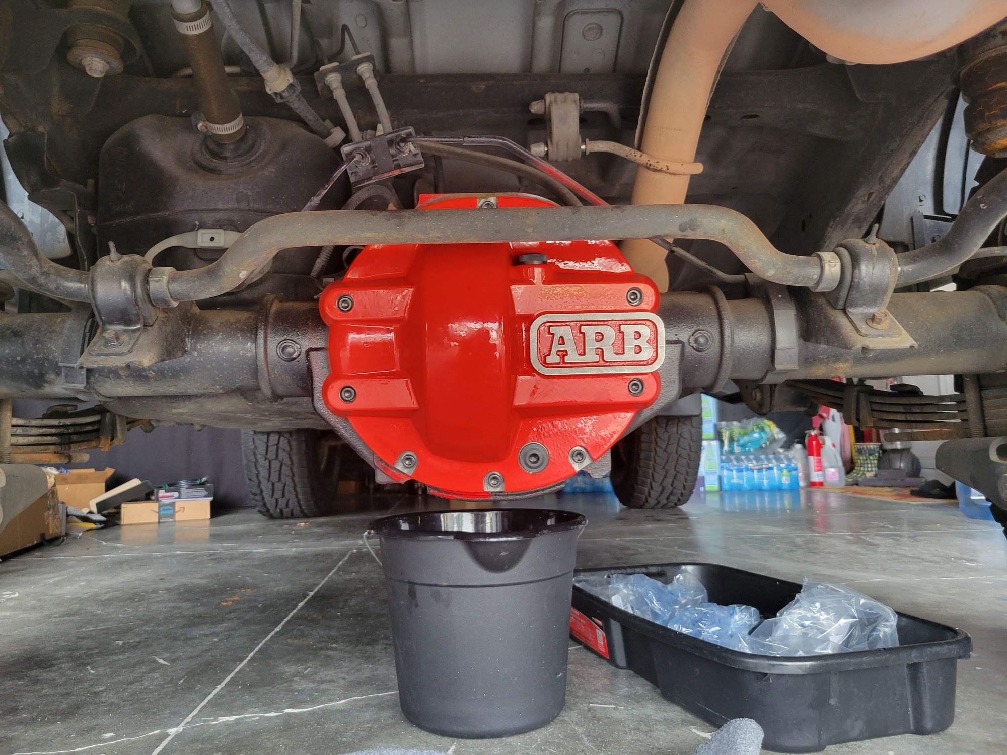

Thanks doing another round of maintenance. Picked up the arb rear differential cover, along with their breather kit. Changing the rest of the fluids.

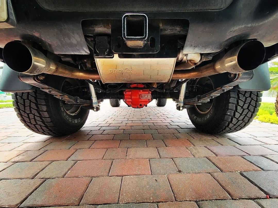

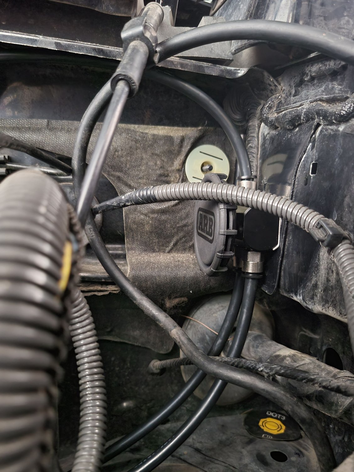

Old May 21, 2022 | 07:57 PM
  #60
Lord_Vien's Avatar

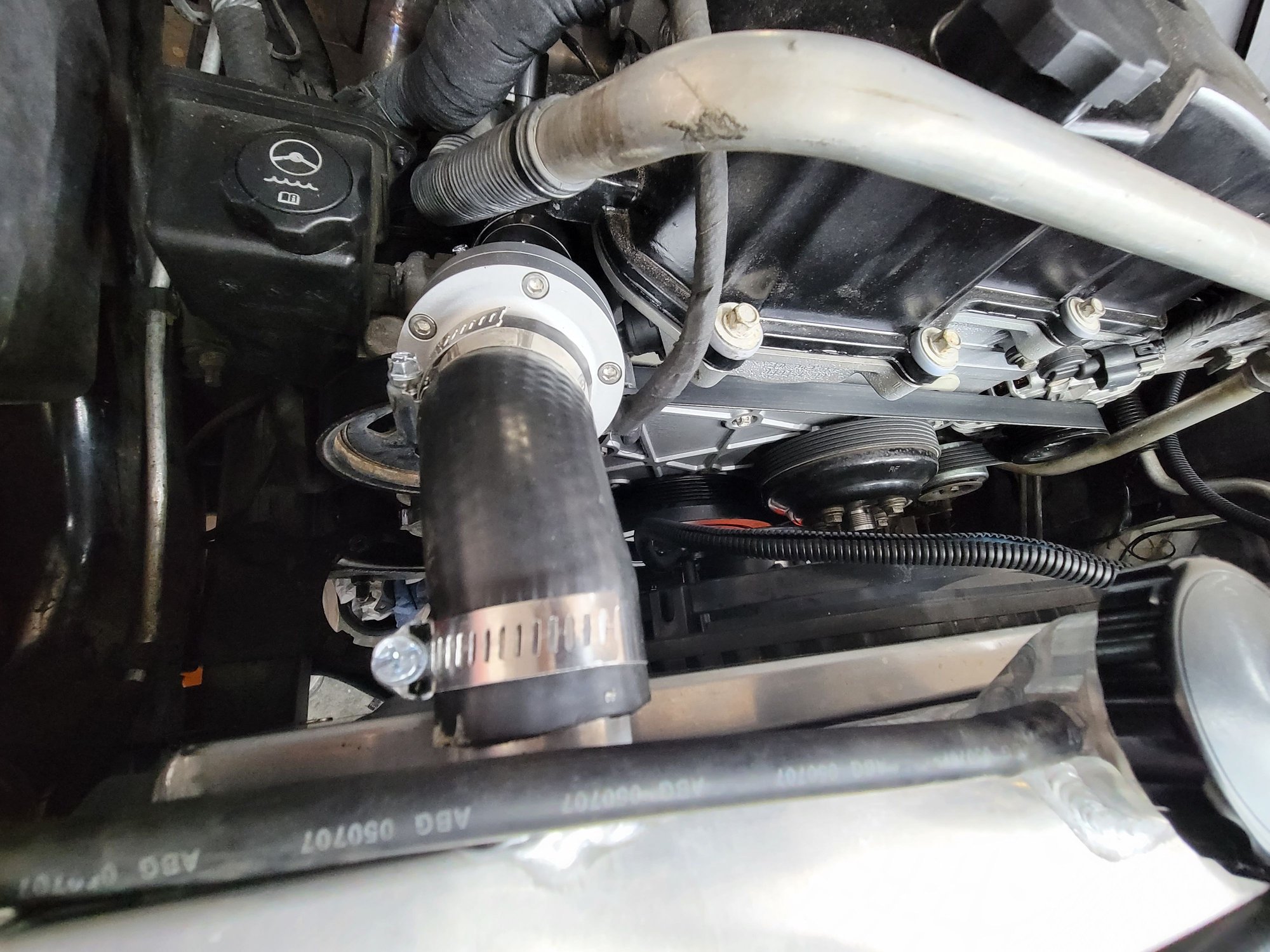

Joined: Jul 2020
Posts: 115

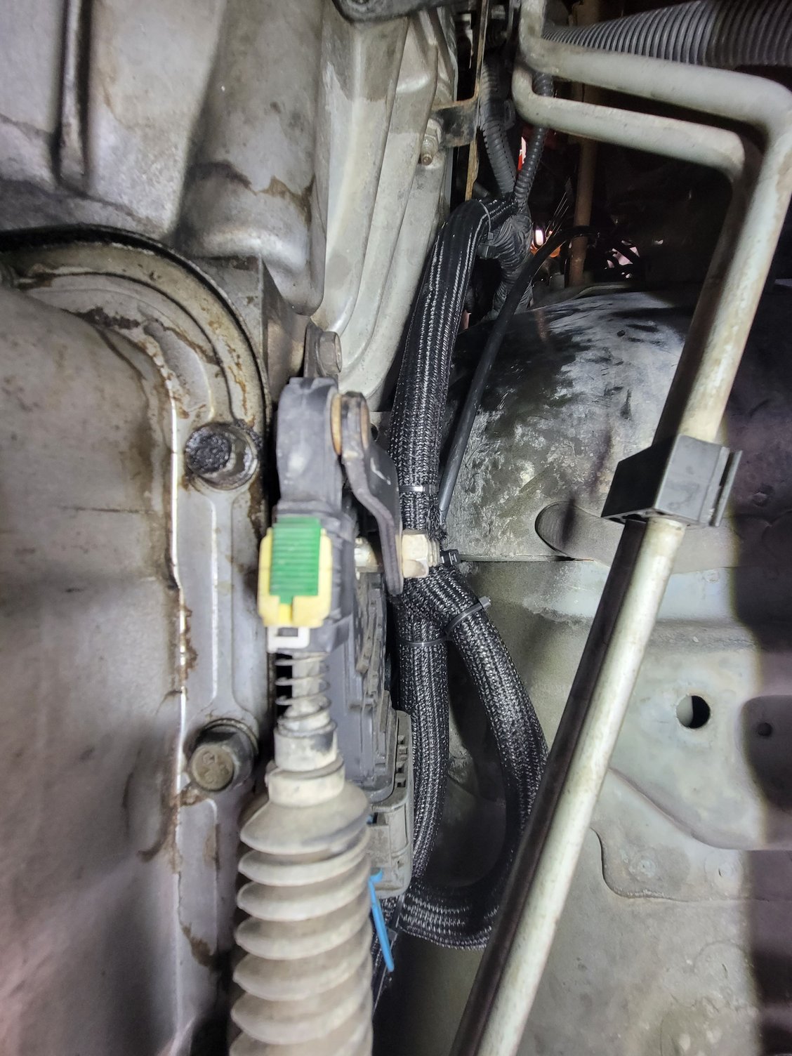

Installed the arb upgraded rear differential cover, and the differential breather kit. My God was it a PITA but also touched up exposed wired over the transmission. Also installed the 08-09 airbox and airdoc intake. The box was also a PITA because there is a stud you have to take out on the 07s and one of the mounting points is different. Since I have a tune and deleted the whole air pump and egr valve assembly. The tube that used to go to the airpump now sits facing the front as a air dam.
