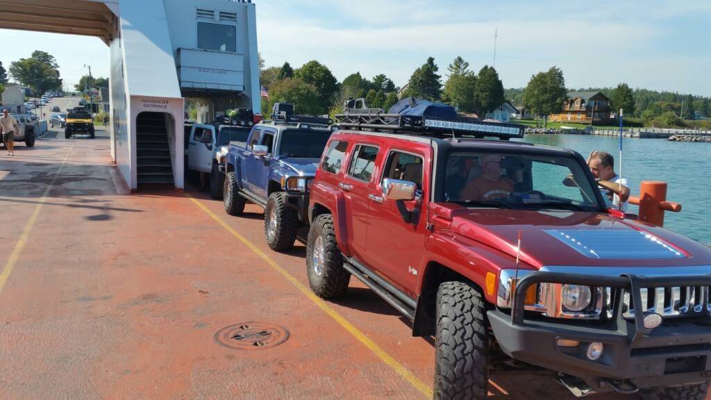

Originally Posted by TAINTER
ARB is a great bumper. we have had several.
Personally crash tested on the H3T by a crack head in a head on. ARB did it's job.
wow nice thanks for the pics, I have heard the weight of it affects the front end dive what is your perspective ? how much added weight for the front?

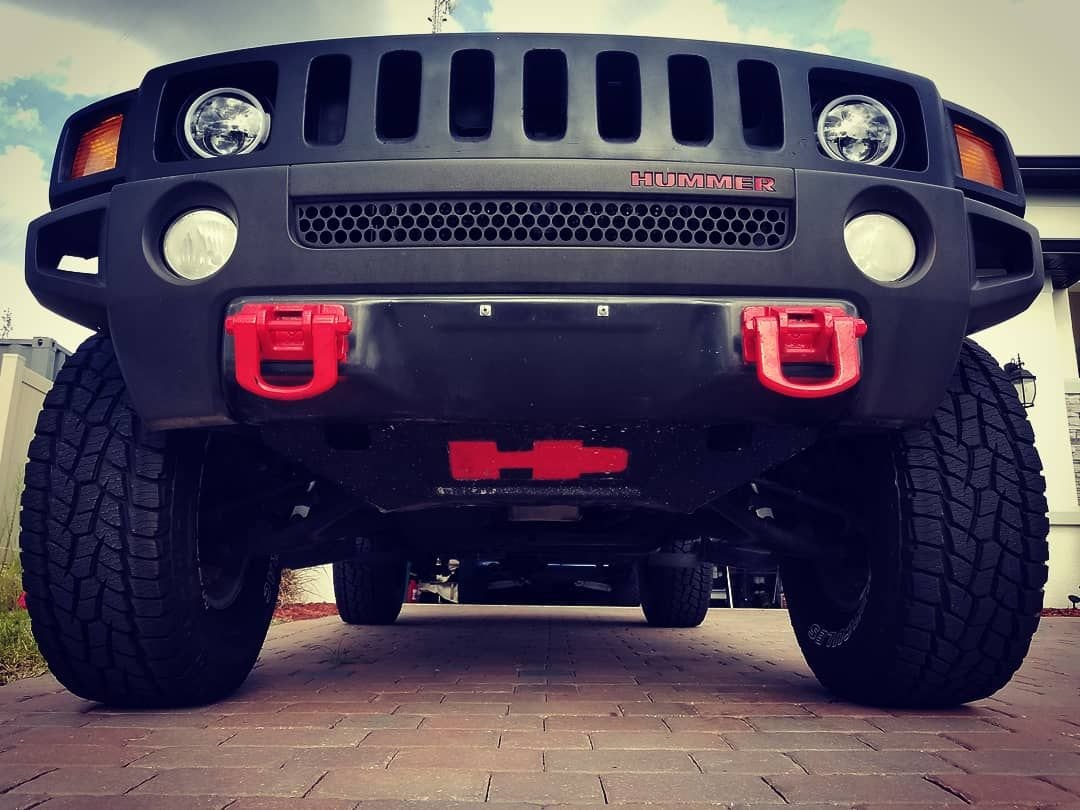

Old Aug 7, 2020 | 04:27 PM
Lord_Vien's Avatar
Joined: Jul 2020
Posts: 115
Old Aug 7, 2020 | 04:29 PM
Lord_Vien's Avatar
Joined: Jul 2020
Posts: 115
Also because the ARB bumper weights 485lbs ive decided against it, instead my buddy is going to fabricate on for me that will be half the weight. Stay tuned!!
