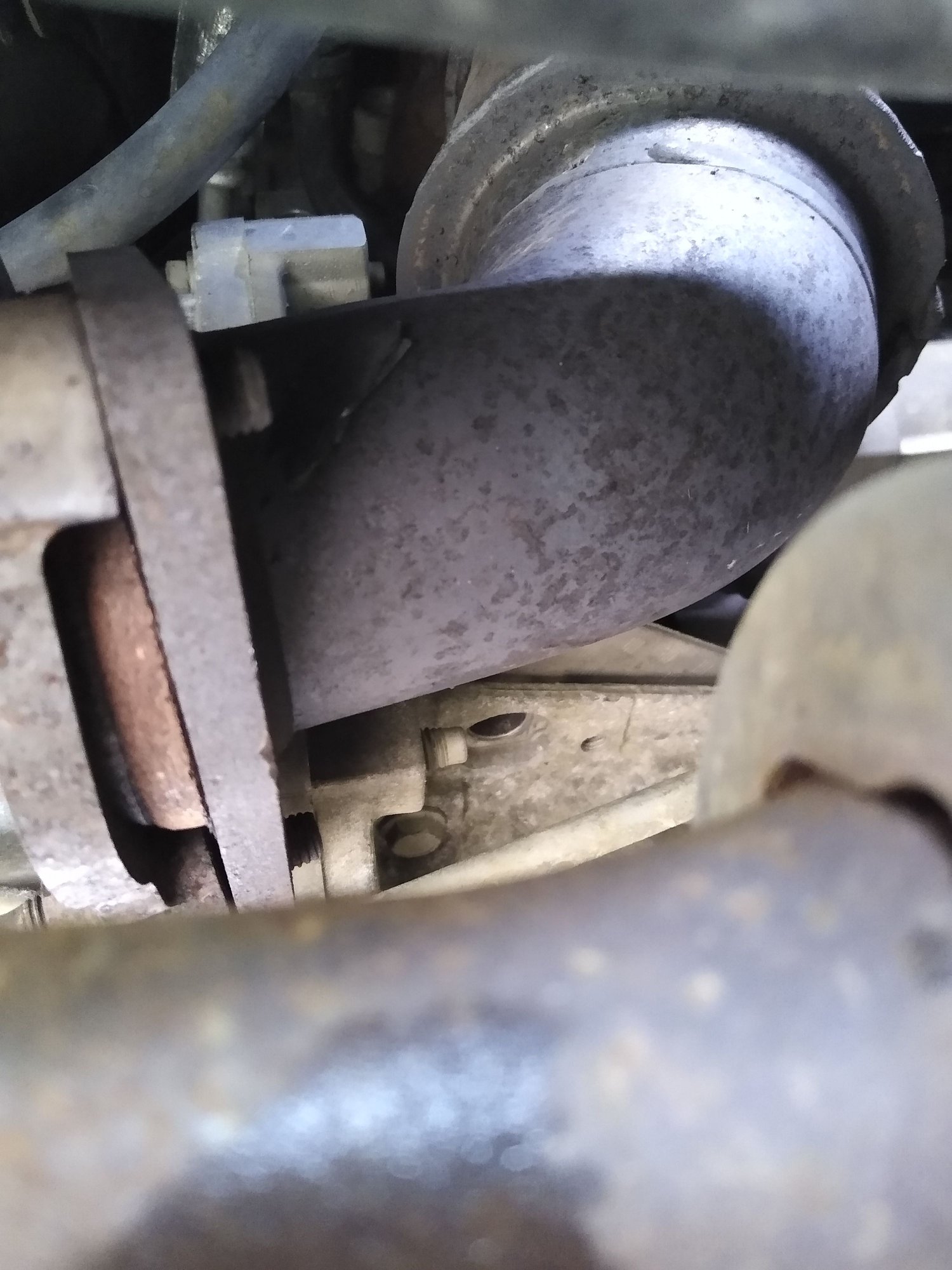

I had a very similar issue with rattling. Check the small heat shield at the 90 degree angle on the exhaust. It wouldn't make any noise when i hit it with a mallet, but the sound went away after removing it. I essentially used tin snips and pliers to remove it.

Default Solved!!!!
Thank you everyone for your help it was in fact the exhaust shield on the first bend . The top weld was almost completely cracked through. It was tuff to spot up there.
Mr. MIG welder and I got it back together in about 10 minutes!
Thank you again!!
