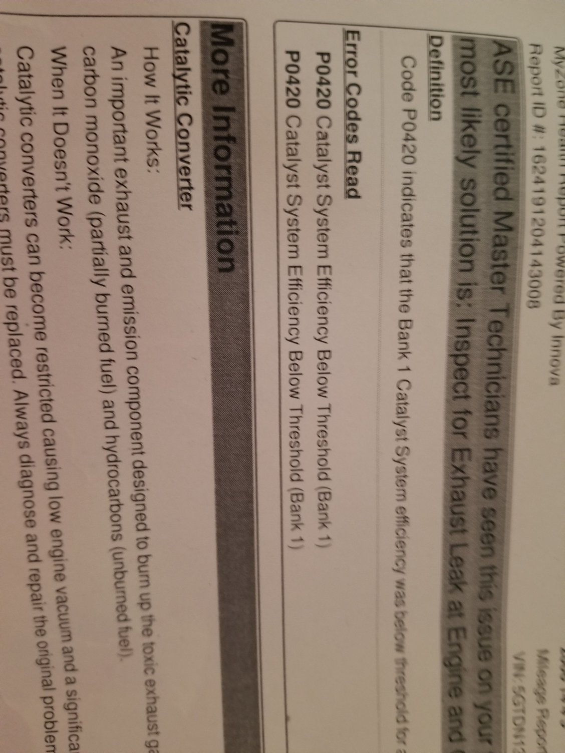

it is a PO420 code. I am NOT mechanically inclined, but great with flowers! Lol. I can you tube about anything and fix it. I just bought this H3 so trying to get it all figured out.

this explains a bit about your code https://www.obd-codes.com/p0420
was the catalytic aftermarket or original?

AutoZone readout
Old Dec 5, 2019 | 04:34 PM
Click on above, read and learn.
