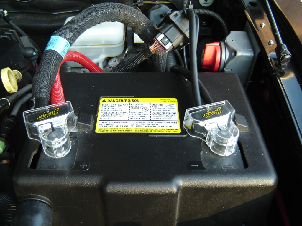

Are you still using the OEM crappy azzed battery terminal connectors??????
The FIRST thing to point to is those POS terminal connectors. The PCM is sensitive to the tiniest changes in voltage, and the OEM terminals SUCK! There are many, many, many posts on this. Get a good quality aftermarket kit like Stingers. These are on my truck, never a single problem since.
To rule out this simple problem, first thing everybody with an H3 should do id replace the battery terminal connectors. Cheap insurance against electrical gremlins.

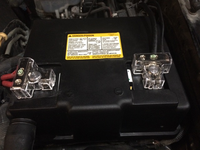

OK, I replaced the battery with a brand new one and yesterday I replaced the terminal connectors with aftermarket ones. All seemed good yesterday, then this morning...same thing! It went into its somewhat violent pulsating limp mode with the errors on the display. Never even made it out of the driveway.
Where would you guys go from here?
