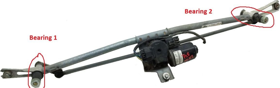

Had a similar issue, in my case it was the wiper-arm linkage, the bushing on the bearings had worn-out so the wiper-arms could lifted away from the glass, there was also a loud "clunk" as the wipers changed direction due to the excessive play in the bearings.
It was an easy fix, take a thick rubber washer with a hole the same size as the bearing shaft, put a slice in the washer and ease over the shaft so the wiper-mount cant move away.
It worked very well and has lasted years!
Not saying its the same issue, but it's easy to check, pull on the wiper side and if there's a large amount of play that will be the issue, also listen for a "clunk"
