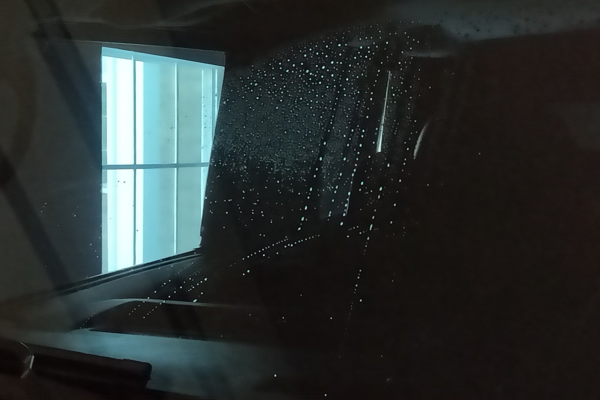

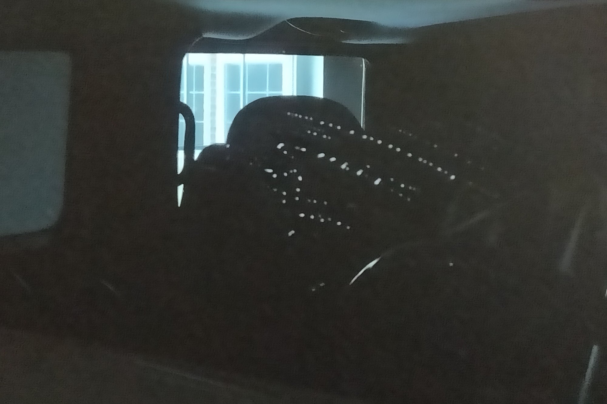

Replaced blades with premium Rain X
Replaced both arms with OEM GM arms.
Still missing the exact same areas.
Any ideas? Bad windshield?

The new arms do have good spring tension. Specifically checked.
The new blades are 16" - as per the manual.
I did not clean the blades with alcohol.
The windshield was clean - with a commercial cleaner and lint free paper shop towels.
I also (2x) swapped the new blades to the other side. The areas remained untouched regardless of which blade.
I will clean with alcohol and give it another go.
Appreciate the reply.
Just cleaned the blades with 91% alcohol. No difference.
I was "surprised" at how much black came off.
I think I will try another set of blades. However, there is clear "non-contact" between the blade and windshield during the wiping stroke.
I will check with feelers to see if there is any gap at rest.

Just checked contact (at rest) with a .006 feeler. Gaps present that align with the missed areas.
Time to research wiper blades.
Have used Rain X blades for years. Always the premium style. Replace every fall. Never had an issue with any other vehicle.
This H2 sut is new to me. Learning this "used" vehicle.
