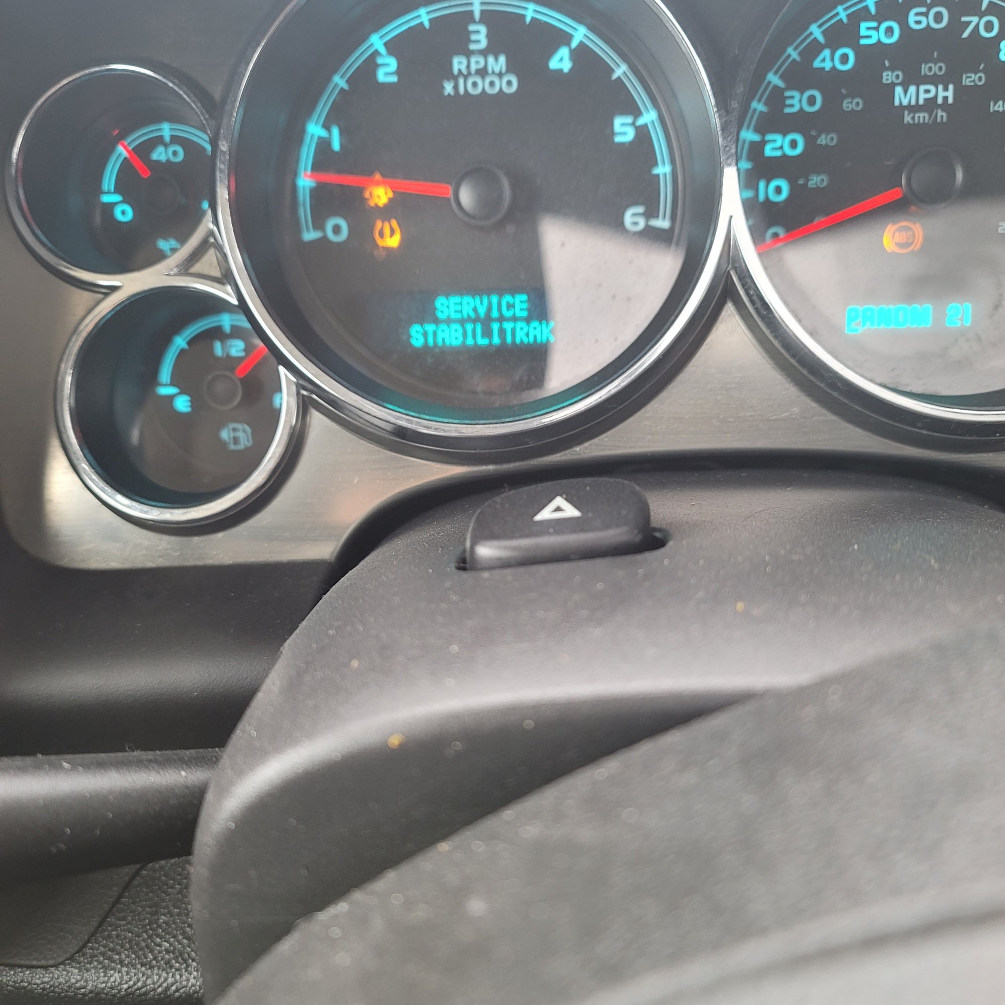

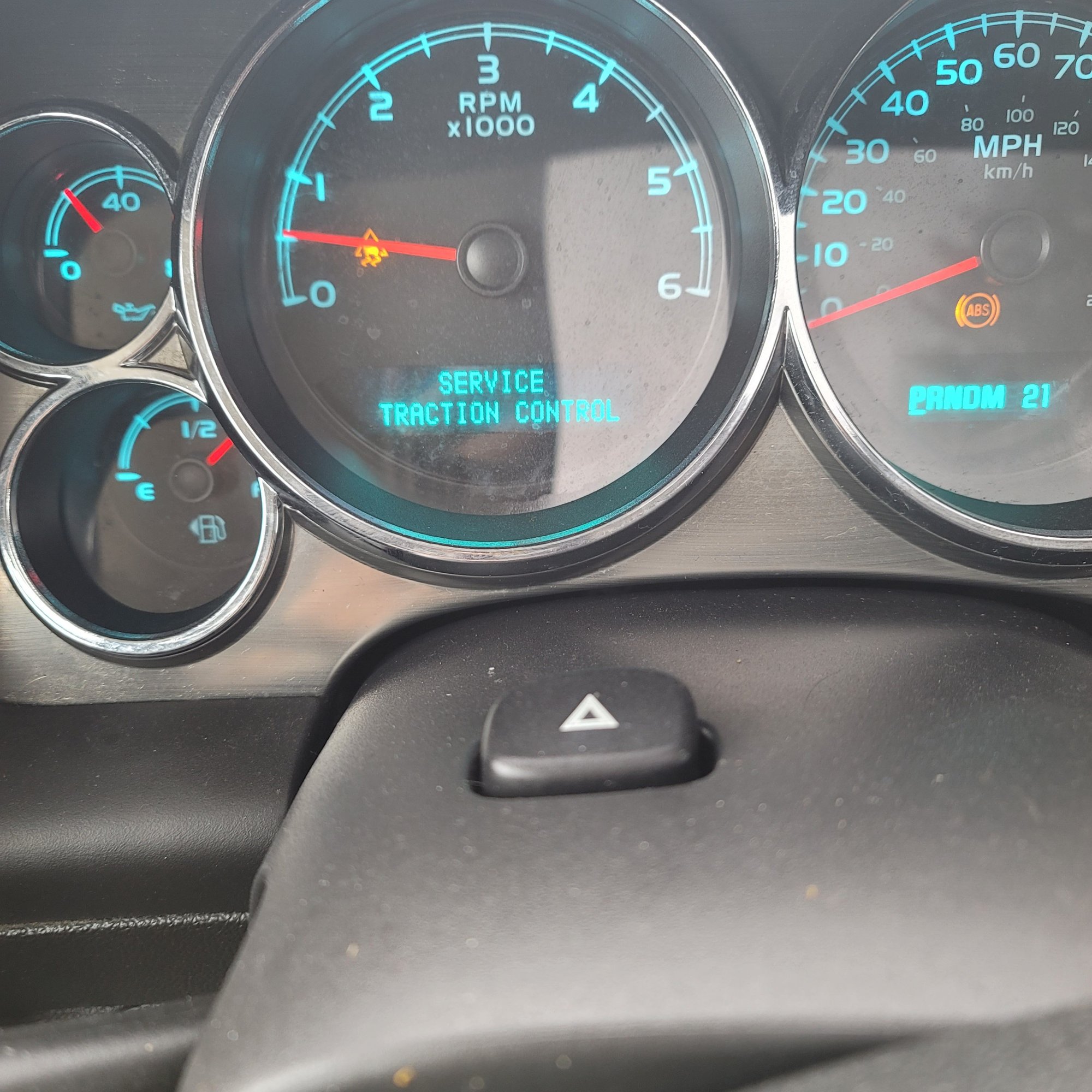

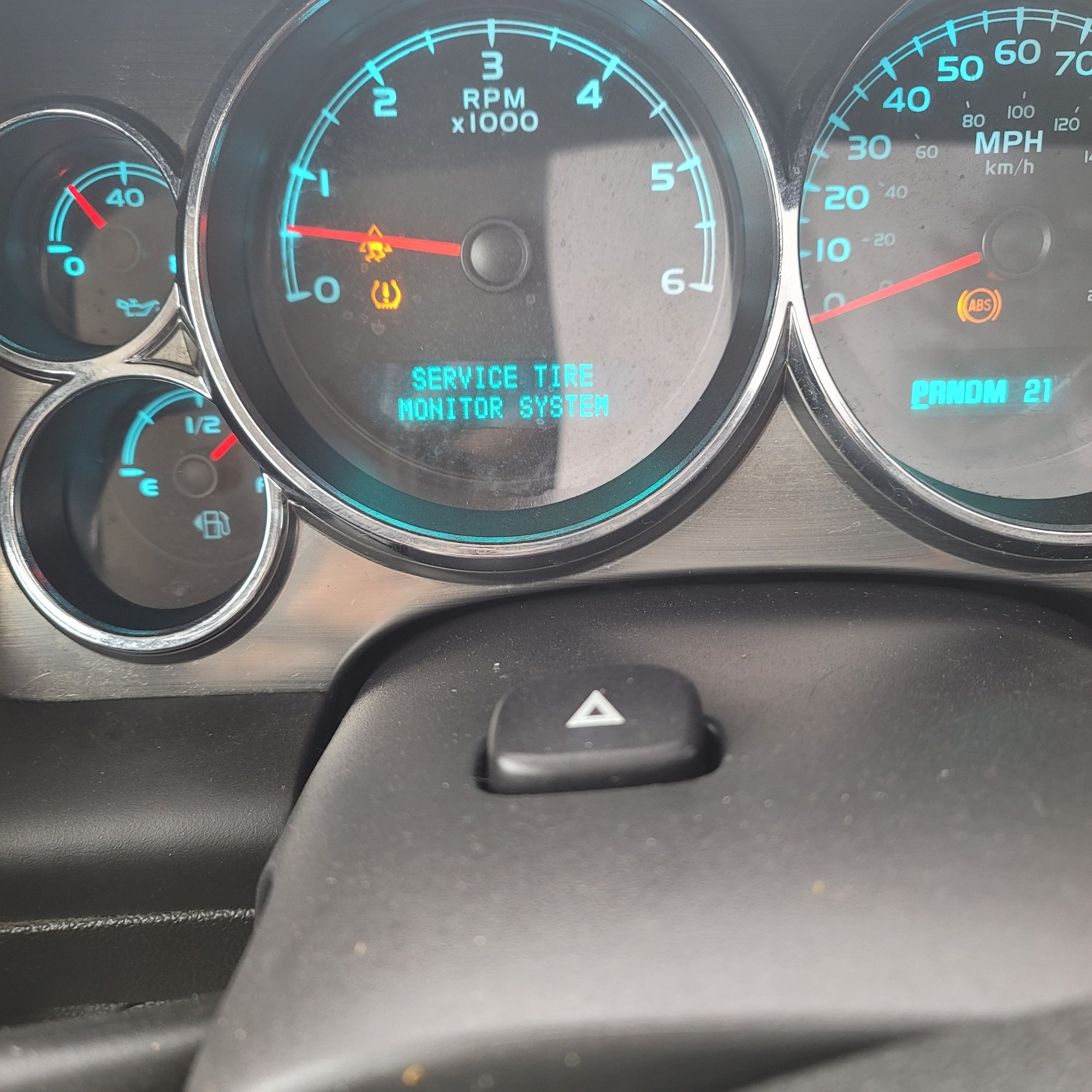

ABS light and traction control light and with a few messages and a scanner was put on it and it came up the wheel speed sensor Right rear , once it sits awhile sometimes the lights and messages will go away and then when you start driving they come back I can't remember off the top of my head what the messages where one was something to do with stablink something like that I would have to start it again and see but those message are gone when the ABS and traction lights are gone and when I start driving they all come back I had a local shop put a scanner on it and it pointed to the wheel speed sensor so I thought I would srart there now it could be just dirty and need cleaned which I will try that once I get it out .
thanks does that all make sense

Pulled right rear wheel speed sensor out and checked with a meter and it is open so from watching the videos in this thread I would guess that is the issue
these are what I am having ..

Pay no attention to the tire one its already fixed
