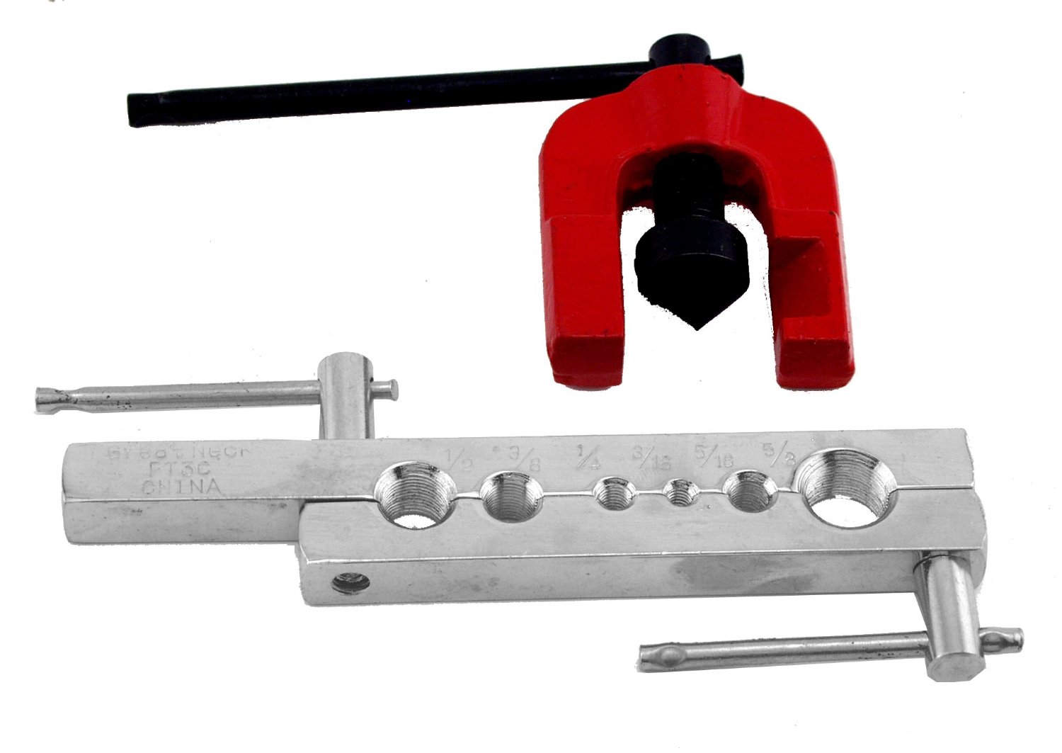

For my Trucool transmission cooler installation I used a Flaring Tool for the Tubing's to keep hoses tight in place similar to the attached. It's now been over a year without a drop on the ground, not to mention i live in a country where temperatures reach 122f

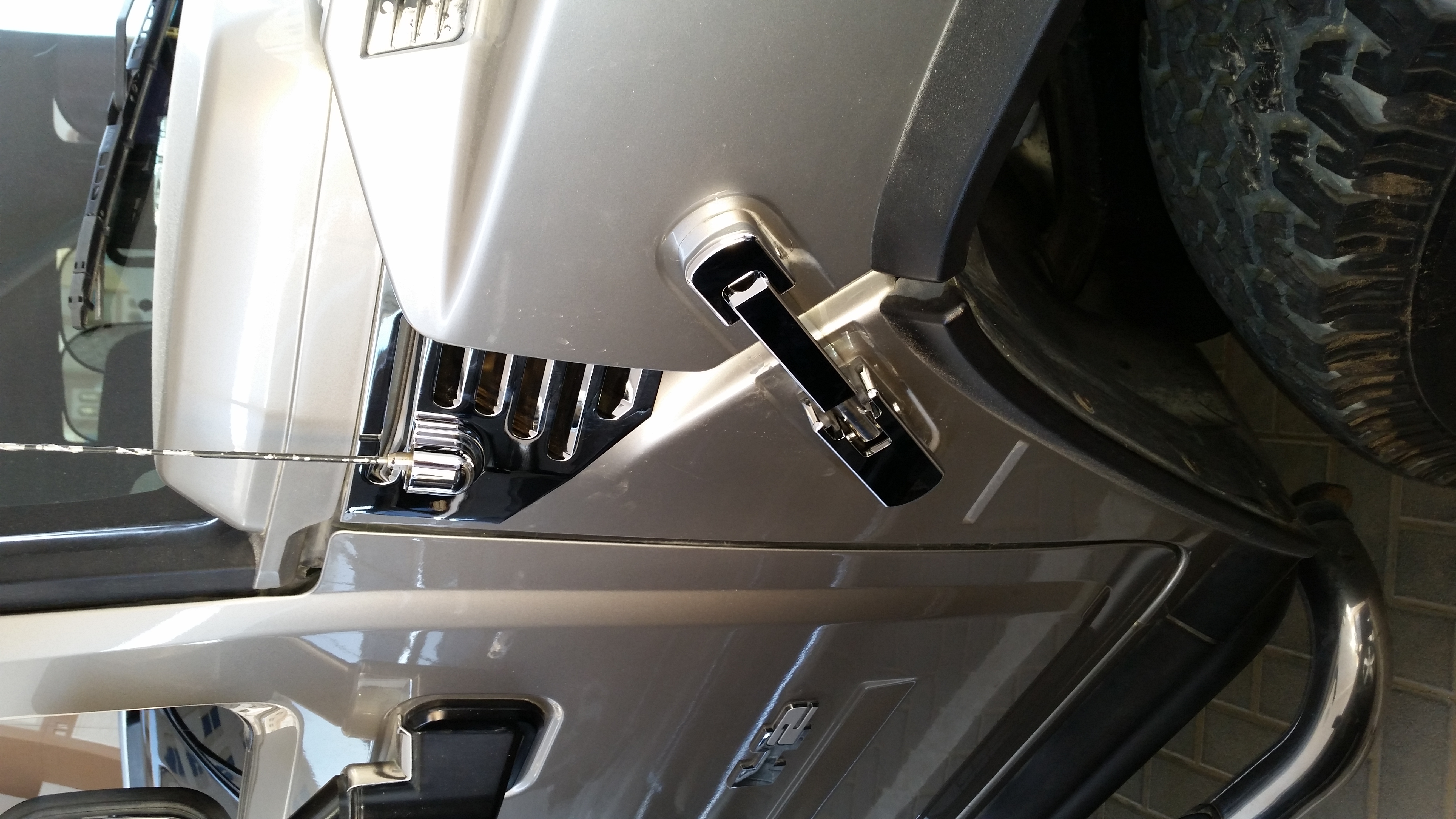

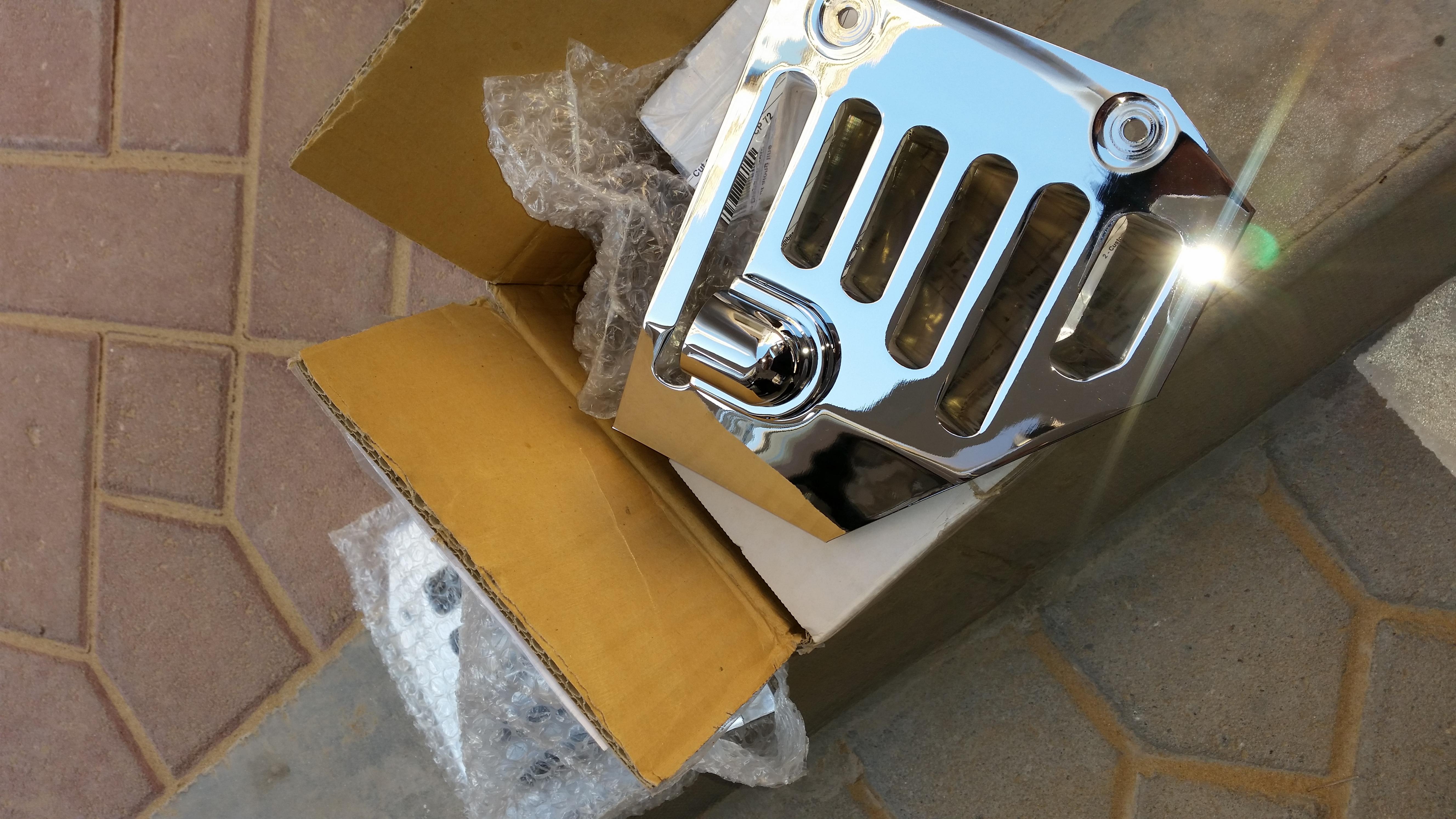

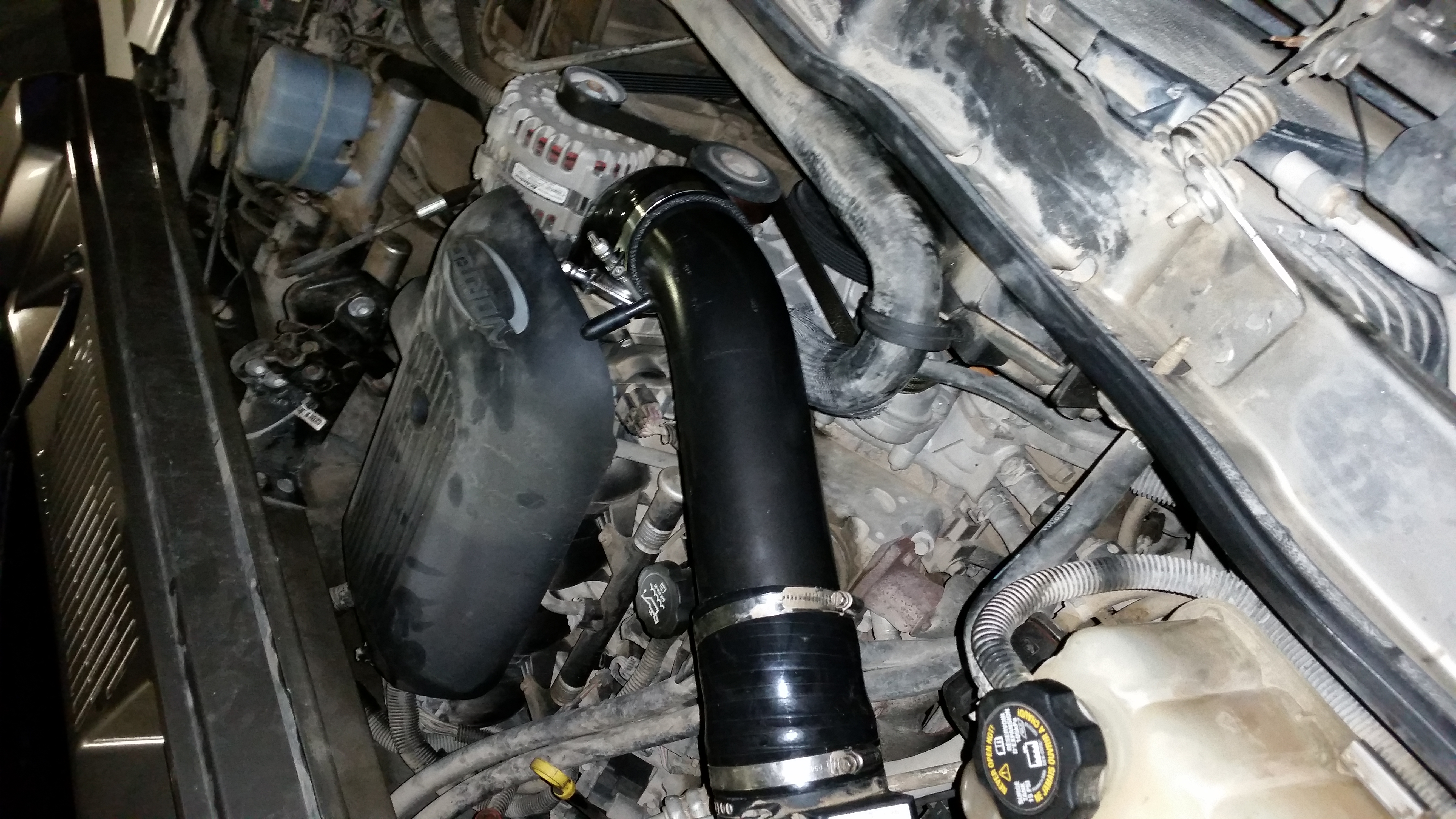

Finally,received my packages from US last week. Can't wait to install all of the stuff. Just got the time today to install the Hood Latch Spring set,New Chrome side vent and Airdoc intake. Next maybe the flare set or the cabin filter...
Got no issue with the two installation except the Airdoc. Having a hard time to fix the supplied clam and I ended up re-use the factory clamp. Doesn't make any different tho...
Very satisfied by far...

I was lucky nothing happened to the transmission . . Loosing all the fluid (7qt) at 75 mph could had lead to a new tranny . Im just back home . Will spend some time this week to fix it with the flaring tool.
