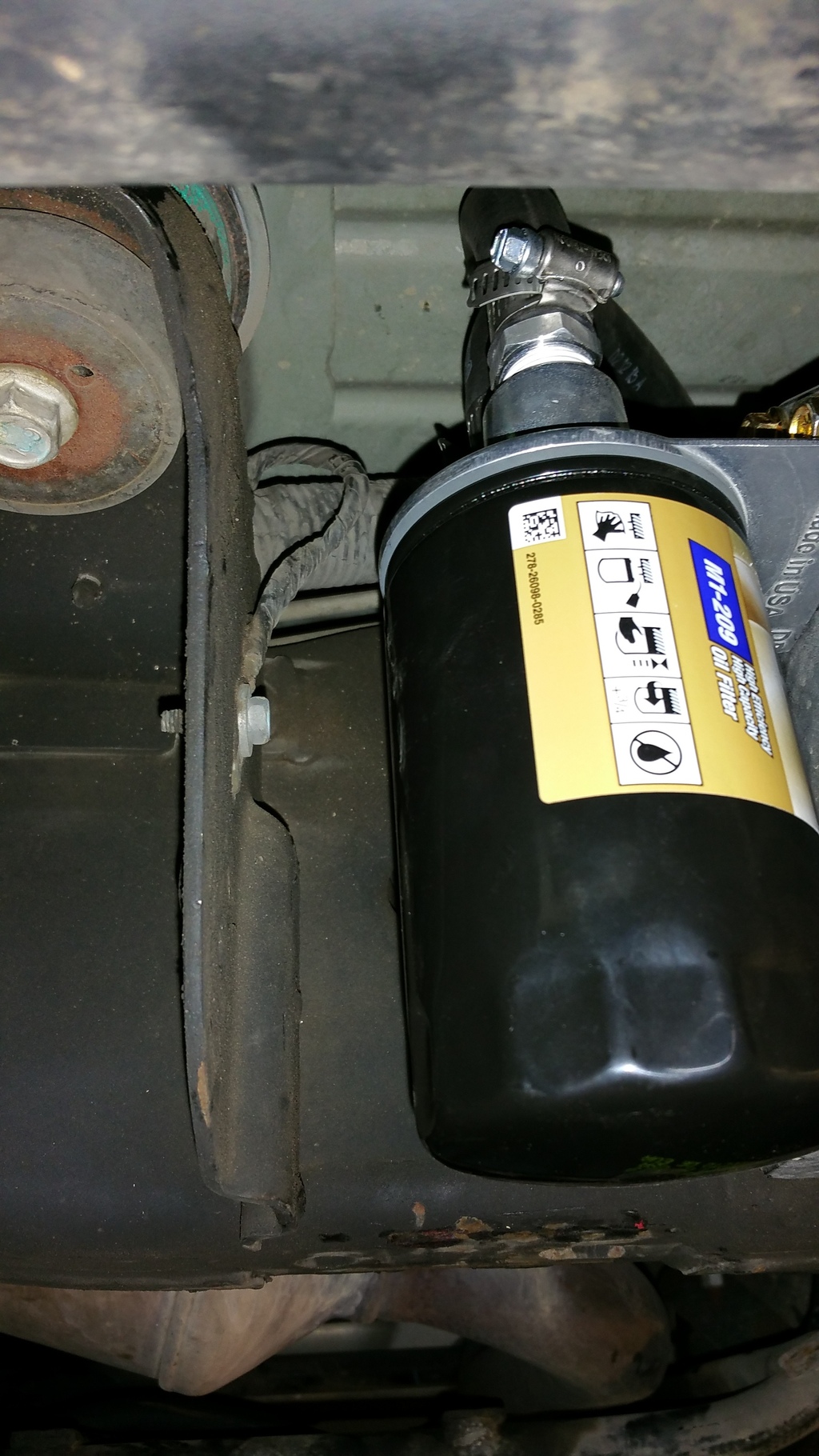

I had originally thought about putting the filter sideways mounted to the hood bracket but I wanted something more stout so I ended up removing the driver side rock rail/steps and mounted the filter between the front body mount and first rock rail mount. The filter is protected by both but I mounted it a little low so it does hang down maybe 1/2 inch or so beneath the brackets. I don't make it a habit of running things over so I'm not concerned but I'll definitely keep an eye on it. If I would have mounted it any higher the bolts would have interfered with the upper mounting bolt for the rock rail.

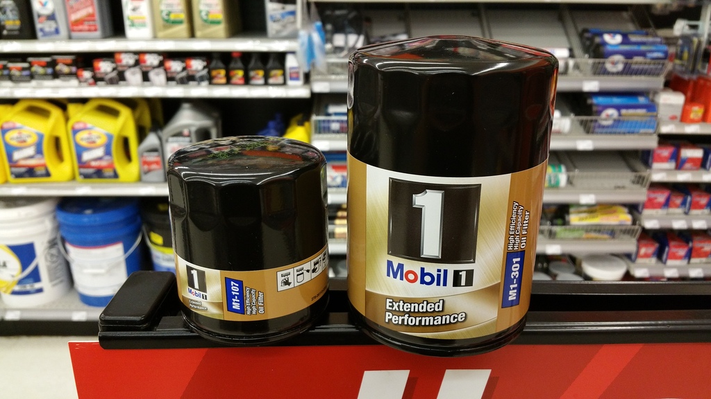

The filters the kit call for are absolutely gigantic, none of the options are for Mobil 1 so I found the equivalent:
Compared to the stock filter:

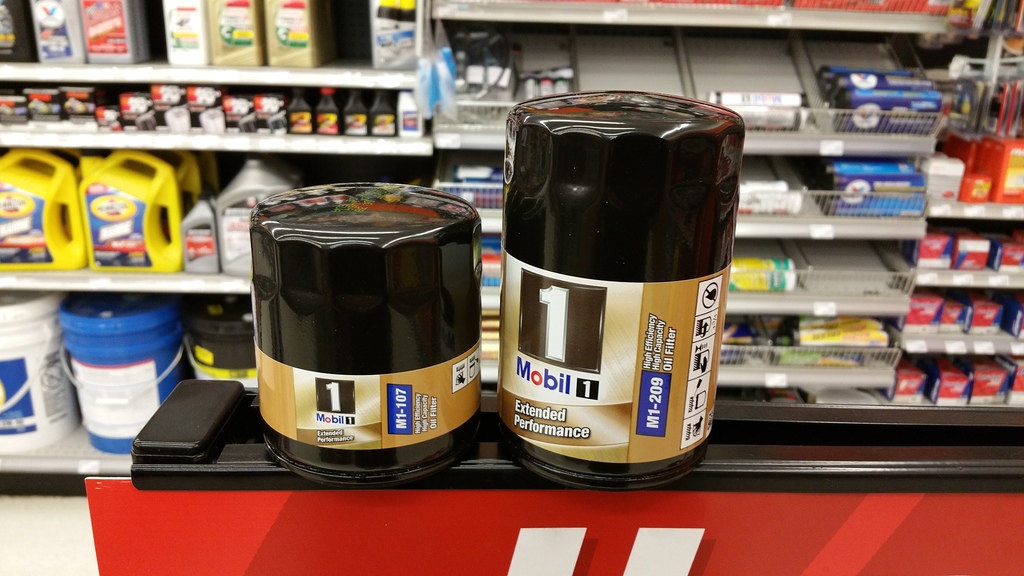

I ended up finding another filter, same diameter as the stock filter but longer, only one with the correct threads which was the one I went with:

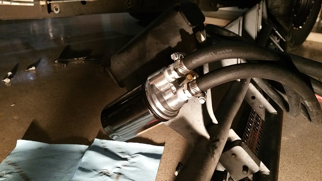

Mounted off the truck:
Back on the rig:

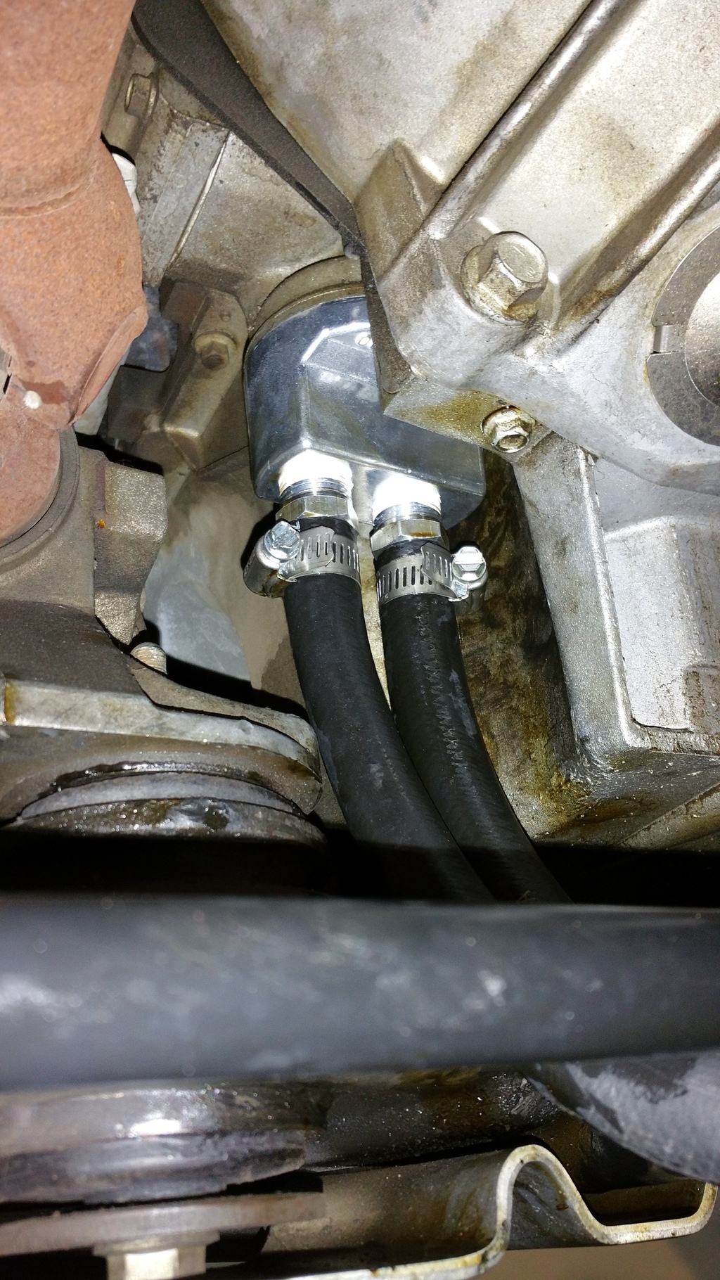

Engine side:
Hell of a project, I spent more time trying to figure out where to mount the filter because I mainly wanted to keep it out of the engine compartment. Plus there wasn't much room underneath with all the exhaust piping which is why I chose outside the frame rail.

So the M1-301 doesn't have the proper threads, but the m1-209 does? Interesting. I'd love to have a filter that large on the H2. Is there's any noticeable increase in oil capacity?
I'm going to have to do this to my mom's H3. That one is more of a pain to change than the H2!
The 301 does have the correct threads, that filter size is what the relocation kit calls for. The thing is gigantic! I was just trying different mobil 1 filters and found the 209 that worked as well. Same diameter as the stock filter but longer. I had to put roughly 7.5 quarts in the thing to fill her up. I guess between the added hose and filter capacity, didn't think it would be that much but I guess. Oil pressure has been normal however I do have a small leak at the filter side of the kit....damn. Now I have to mess with that, I knew it was too good to be true from the get go....
