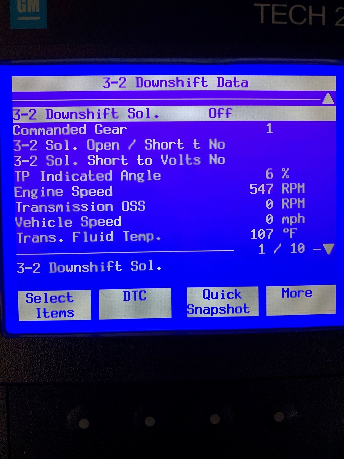

Great news I believe, found where the loom had disintegrated. You could see individual wires where the loom had fallen off and I believe is where the wire that goes to the 3-2 solenoid must have been intermittently making contact with ground. For future reference if anyone starts getting transmission code ground errors, follow the harness towards the front left of the truck. You will see high up ,near where the transmission bell housing mates to the engine the 2 transmission cooler lines- right above that is where I believe it was making contact. To really get at the loom to "properly" retape/reloom the left cat/pipe really needs to be removed so you can get your hands up to re-insulate the loom in that area...
As this vehicles age I am guessing more random wiring harness shorts may occur. The plastic loom is so brittle from age & heat it just falls apart in your hand.
For us owners of these now 20 +/- year old Hummers... I strongly suggest buying a Tech 2. Amazing what info they can show for diagnostics...
So, crossing my fingers this was the fault. Have driven start/stopped etc for around 30 around town miles. Has been fine. Since this started, I couldn't drive a couple miles without the fault.
Another note- While reading about this OBD code- I read about several people who in fact replaced transmissions ....only to have the fault occur after the new transmission. I have never experienced a transmission "limp" mode before this issue and I could easily see how one would think the transmission is broken. Limp mode defaults you to basically 3rd gear & you stay in 3rd until you either clear the code or a certain amount of time without the fault passes (I am guessing).
Inside your transmission there are electrical solenoids (easily changeable & inexpensive to purchase). I believe its like 5 solenoids, wiring harness & manual valve position switch that are easily changeable and cost is approx $250 for all that (solenoids being OEM AC Delco and harness being Rostra). So, if you are doing a transmission filter & fluid change - since pan is dropped anyways, the fore mentioned parts are easily renewed. Also, if you do need to do the transmission service you can also buy a pan that has a drain plug in it - Makes it easy if you wish to drain and add new fluid at certain mile intervals for longevity.
see attached pics of the Tech 2 screen when running the transmission function-
